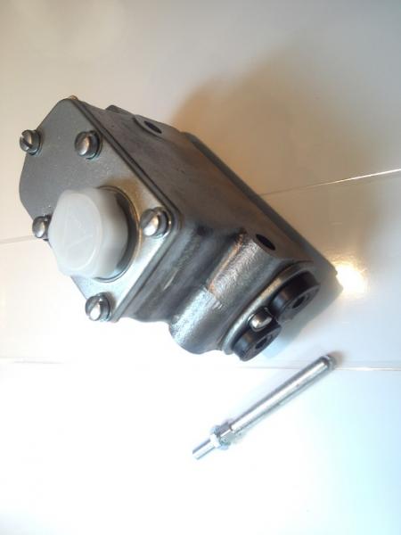

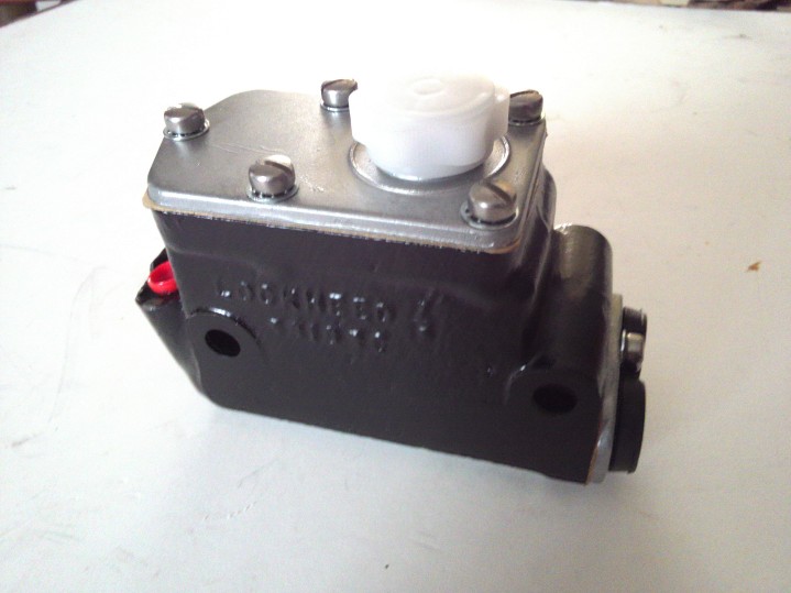

The fact is, the repop/aftermarket units, especially the cheaper ones, tend to develop leaks, sometimes as soon as 6 months, and rebuilding an OEM Lockheed with new seals is also a short term solution. The sleeved units I can provide will outlast any other option by tenfold. I have in fact, sleeved many of the aftermarket units that were essentially new because they leaked within a very short period of time. In over ten years, I have yet to hear from someone that wasn't 110% satisfied with their reconditioned master cylinder. They come back better than new. I've had them in a variety of my own cars for over 20 years without a rebuild.
