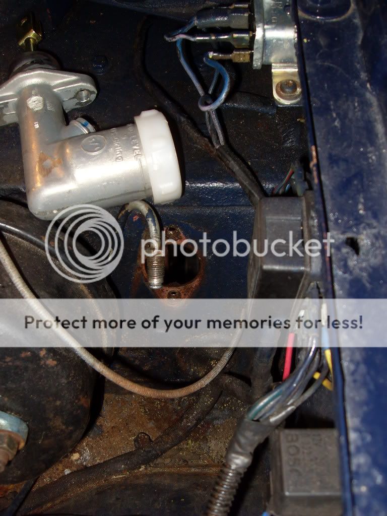

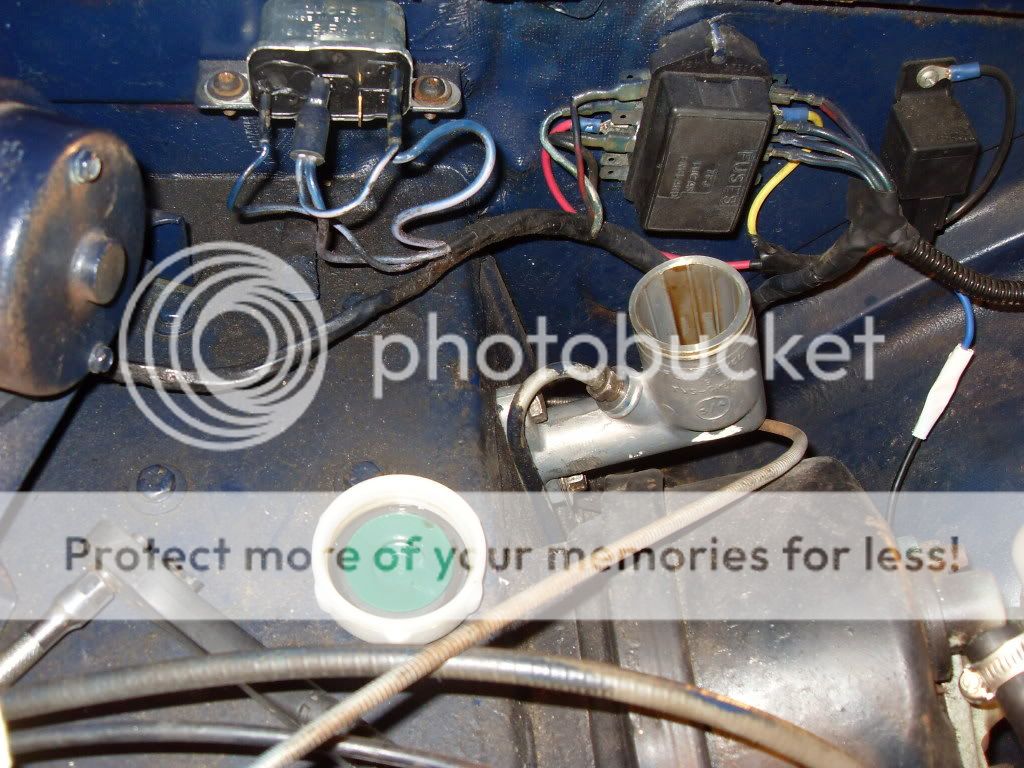

I have detected hydraulic fluid leakage (not sure exactly where however). Since the car was sold with a new spare clutch master cylinder in the trunk, my guess is the previous owner detected a problem but never got around to changing it.
I'll therefore try to change it this week, bleed the system and test how it all works.
I'm not the most experienced mechanic, so even though this seems straight forward on paper, I fear running into probs in reality. For instance, how difficult is it to reach the nuts and washers above the pedal area? Do these parts come off without too much effort?

No need to bench bleed the clutch master. It is a straight one way cup and boot.
Now, make sure you acquire a hydraulic line wrench when removing the hard line. Keeps from stripping the nut.
On the underside, the pedals, you crawl under and you will probably find the leak, if there is fluid dripping down the pedal shaft.
The pedal linkage is held on with a cotterpin, so you can undo it there. Might be a good time to examine the hole in the pedal and if necessary drill and rebush.
For me, I have found that I can pull the boot on the cylinder back, and using pliers squeeze the retaining ring and it releases the cup holding the shaft in and I just install the new one in situ. However, if you are doing this the first time.
Mop all the fluid up out of the cylinder, remove the line, remove the mounting bolts, remove the retaining clip on the pedal linkage, extract the cylinder. Reinstall the new cylinder, hook up, bleeed.

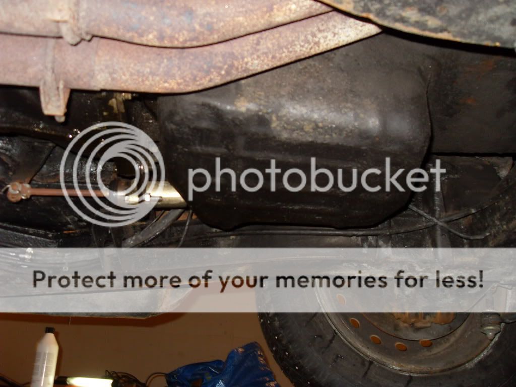

Might want to reassure yourself that the slave cylinder has the bleed screw facing up and is mounted on the brace closer to the trans rather than the engine. May want to consider replacing the plastic cylinder connecting hose now or in the near future.

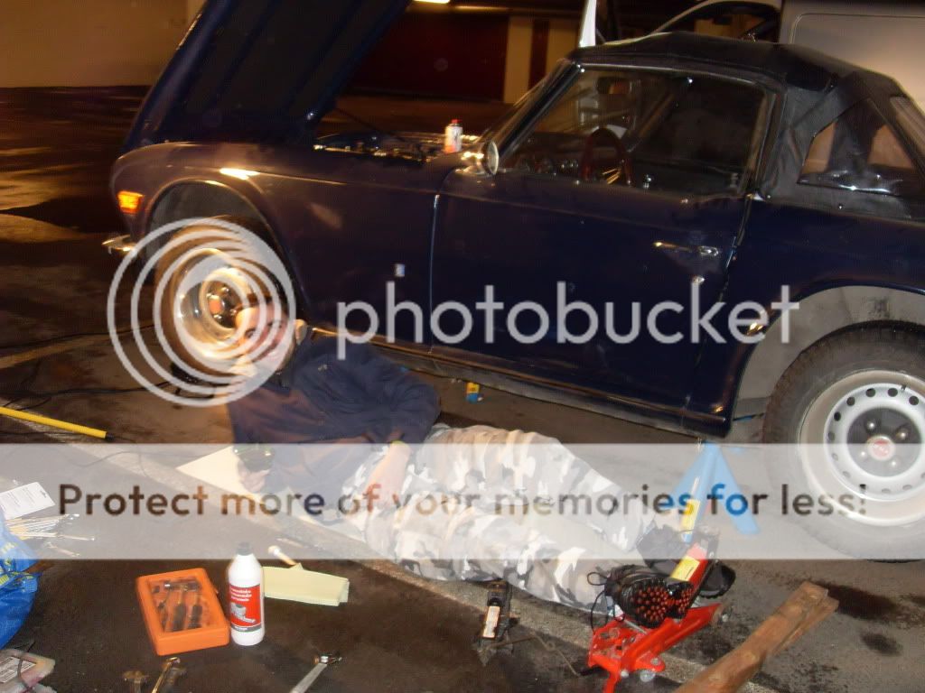

Hi there,
Pleased to say the operation went A OK, and the patient is on the way to full recovery. Thanks for all good advices. As far as I can tell, bleeding the system was a success, everything is working fine, even though the clutch pedal operates with it's previous macho pedal pressure. I suppose I'll find a softer kit in the future when it's time to change clutch.
Furthermore, the noise from the drive train has not disappeared, so I'll have to dig deeper to find the source. Seems to be coming from the gear box, when accellerating. Can best be described as a grinding/ scraping sound.
