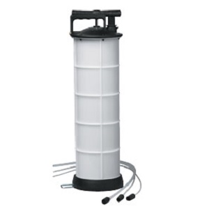

Question is how to do this as it has no drain plug. So I imagine I need to suck it out from the fill hole. Any thoughts on best way to do it?
Alfred E. Neuman
A Mightyvac extractor works great for such things. Use mine at least 4 times a day.

You'll find inexpensive hand pumps pretty near the gear oil display in auto parts stores.
You can use the same one to put fresh oil back in.

I suppose one gets used to simply pulling a plug to drain the oil but it is really no trouble to suck it out with a vacuum or a pump and it's actually a bit tidier. I've been doing it on inboard boats, which rarely have any access to the drain plugs, for 50 years.

It's SOP for some of the new Mercedes engines. The sump is plastic, with a big plastic drain sealed with an o-ring that you need a special socket to remove. Work instructions for basic service is to suck the the oil out the dipstick tube. Drain plug only comes out if you need to access the bottom end for some reason. My guess is this is to keep techs who don't use torque wrenches from stripping the plastic plug.
