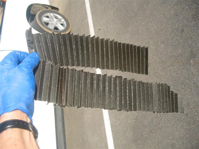

I make a practice of cutting apart the filters to check the inside of the medium for metal bits or bearing material.
