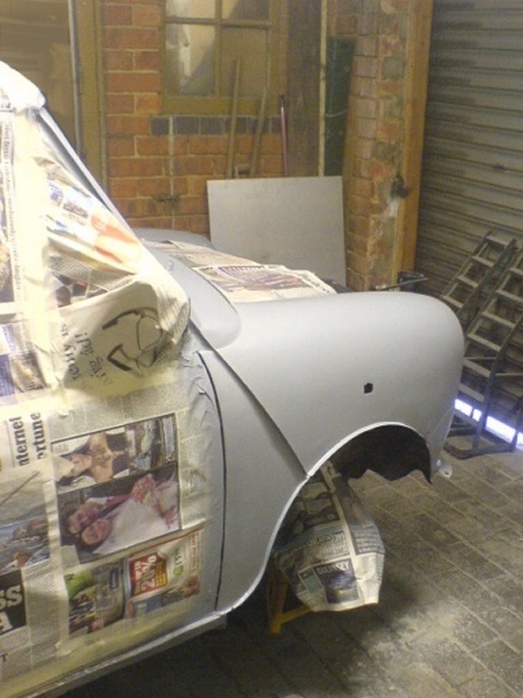

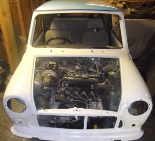

We decided to respray the front end first as its looking a little drab. Its almost prepared now and should be resprayed next weekend. Then its just putting everything back together and the MOT should be soon after that.
We haven't done any photos for some time - definately will with the Sky though:smile: I plan to do a '1989' theme....should be fun.

last night we put the guide coat on and rubbed it all off this afternoon ready for spraying tomorrow :laugh:

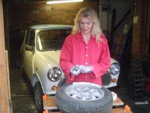

Rosalind, is this work being done in your garage? Are YOU getting your hands dirty??? :lol:
rosalind
rosalind
I did alot of the preperation but my husband did the actual spraying.
The colours are original yes. I would not want to change the car.

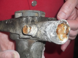

We had a big problem. after just a few minutes with the engine running the car overheated. We ( by 'we' i mean my husband) took the radiator off and back flushed the system...except it wouldn't. eventualy water came through slowly so we refitted the radiator and put some cooling system flush in and let it run to circulate the flush...still the same. The bottom hose was cold though so thought it could be the pump. We brought a new water pump (£18.00) hoping it was that rather than internal blockage. When we took the old water pump off it was just as though someone had blocked the outlet and bypass pipe up with candle wax! I will take a photo later. We checked the other pipes and cleared the little metal bypass pipe that goes to the thermostat, fitted the new water pump and the temperature is fine now thankfully.
I did the nice job of refitting the interior, washers, wipers etc :smile:

Yes it is almost finished :smile:
We booked it in for the MOT 10am Thursday...fingers crossed.

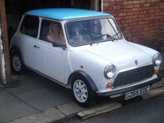

Tonight I rubbed the wheels down ready for spraying Diamond White. Its one of the only changes I dare make to the car (have kept the original steel wheels and white hub caps though)
still need to add the pinstripes to the side and give the whole car a good compound and polish. In the photo the grey wheel arch extensions were not fitted (they are now).

if anyone is interested...tonight the wheels went on and the mini is back on all fours again.
MOT in the morning..hope it passes!
The pinstripes did not arrive in time but that can wait. I have some genuine Rover stripes but want to save those for when we restore the car fully in a couple of years.
