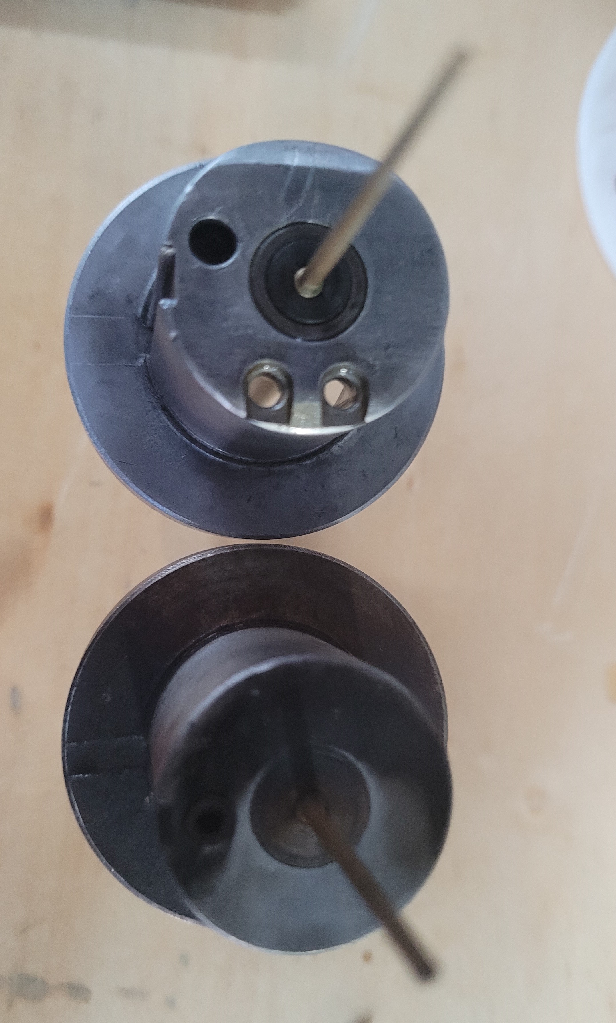

So here's a pic of the piston and needle. Anyone have any ideas on this? I did find another HS2 that looks similar to this one, but doesn't have a wobbly needle. I have not tried swapping pistons, the older one is clearly much shorter.
I'll put some pics here.
Original piston/needle on left, shows holes, with wiggly needle, looks like 2 pics of same.
Here are top view, showing the older piston on the bottom, then on the right. I am open to any sugggestions.

I have found out the "floating" needle is correctly called a bias or swing needle. Doesn't help me now as the 850 won't run long enough to warm up. Still don't know what to do. The bias needle was running. The older carb has a fixed needle.
I will now look up the correct needle to have for a stock 850, if I can find it somewhere. I feel rather dumb here.

The correct needle for an 850 Moke would be a fixed needle in one of the the following three profiles:
GG - lean
EB - standard
M - rich
Since you changed the float bowl valve, make sure to check the fuel level in the bowl, and adjust it as needed.
Also, if you end up changing the piston, you should also change the suction chamber (dashpot), using the one that came with that piston,. to avoid a mismatch.
