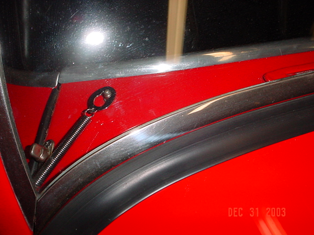

Getting a perfect BN1 & BN2 windshield to shroud seal fit
Over the years I have read much discussion on how to fit the seal & which seal is the best. I went through the following drill quite a while ago & still have a perfect tight fit even though the car has been in very hot sun, rain, & snow.
I purchased a straight section replacement seal from BCS in Stockton. With the seal were instructions for a perfect fit. A note to me from Norman Nock at BCS - "Dave .. I got this tip from a 100-4 owner at Silverston in England many years ago and we send this info. out to our customers who buy a seal from us , glad it helped you .. Norman Nock"
The windshield & frame need to be removed from the car & placed on a soft flat surface. I used the living room floor.
1- Work the top of the seal into the windshield channel a bit at a time, don't slide it in from one end, this will stretch the seal in the wrong places. use a putty knife or some similar flat blade dull screwdriver to force the seal into the channel. I used a couple of one inch wide drywall knives in leap frog fashion. Take your time & make sure that the rubber is completely bottomed in the channel. I also used some soapy water for lube. The heat will remove the water at the curves.
2- When the seal is solidly seated in the channel, apply a heat gun to the upper thicker part of the rubber at the curves. You will not be able to get the rubber hot enough by using a hair dryer & will need to purchase or borrow a heat gun. Pull on one end of the rubber & stretch the outer end as far as possible. Heat the entire height of the rubber (not the glass) but only pull on the thick part. Be sure to direct the heat gun right on the rubber. Don't heat the glass very much or it might break. If in doubt, tape a cardboard shield over the chrome frame & glass. Don't get the wet rag on the glass. Vice grips work well to get a grip on the rubber.
Hold the stretch until the rubber cools. It took several trys to get the rubber hot enough to stretch it far enough. You don't need to put it on the car to check the curve. If there is too much curve it will flatten to correct contour when installed. Just eyeball the curve to be sure that there is enough or a little more than enough. A wet rag helps to cool the rubber faster.
How does this process work?
The stretch & cooling causes the thicker part of the seal to be longer than the bottom thin part, because the thick part springs back less. This forms a very tight fitting & permanent curve in the ends of the rubber. Trim the ends to length. Careful on the end trimming. Make sure that the ends go all of the way to the post bases on the shroud plus about 1/8 inch & that the ends are parallel to the posts. With age & time the ends may shrink back away from the posts a bit.See pic.
D
