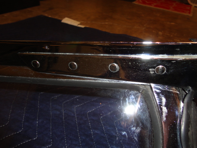

I just picked my windshield from the glass shop after having new glass put it. I had it chromed back around 1980ish. Do you still need photos?

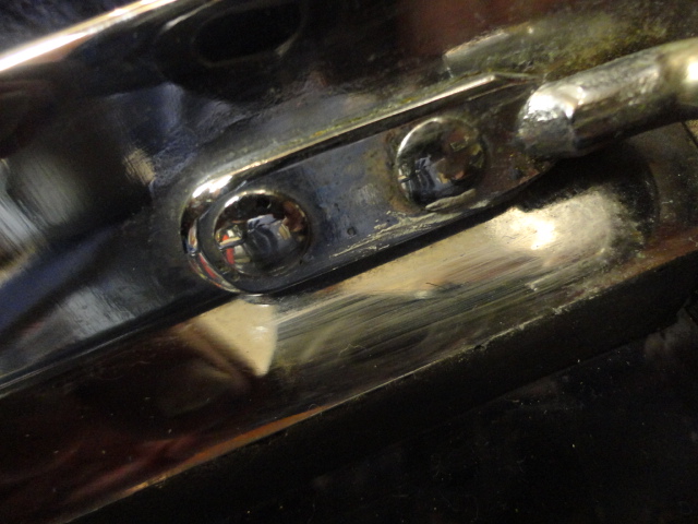

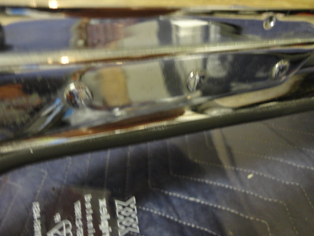

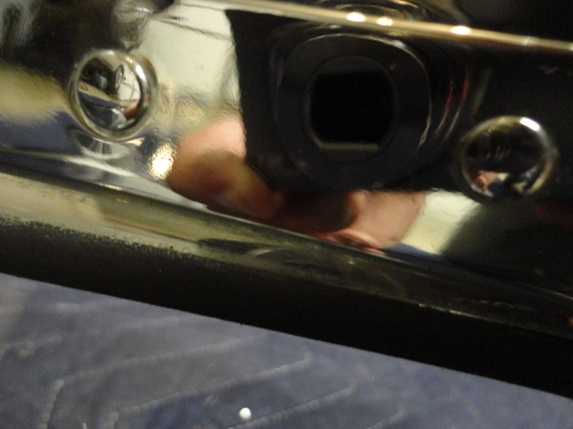

Thanks for the response folks. I guess I'm going to wing it and try leaving the rivets in. My plater seems to think it will turn out ok, but they do have some concerns with ensuring all of the previous bath is rinsed from between the parts. They assume it will just take longer to rinse between stages. I'll take some pictures after and you can let me know if it passes for you or not.
Here's some pics of mine that was done in the early '80's and it's still holding up.
