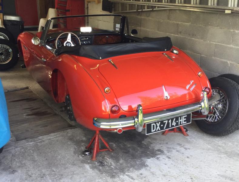

I tried my car (on jack stand) with and without the brake drums and the vibration remains (drive shaft is new), that would come from rear axle...

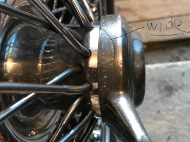

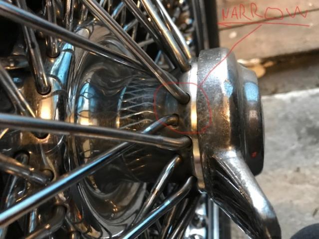

I noticed that the wheels do not fit correctly to my hub:
when I squeeze my left rear wheel, it is not perpendicular to the hub (wheel hub are new)
I tried my car (on jack stand) with and without the brake drums and the vibration remains (drive shft is new), that would come from rear axle...

- The tests was jacked car without wheels, and without wheels and drums, and there is always tremor (it was to check if the tremor came from unbalanced drums)
- The driveshaft is new and balanced
- when I put my left rear wheel on the hub, it has an important play (the wheel moves)of this fact when I tighten with the nut, the wheel does not pose necessarily correctly (sorry its google translate)
Thibault
Are you saying that there is play on the wheel ( can turn it back and forth) when you put it onto the splined hub ? There should be little or no play before you tighten up the spinner.

If I read this correctly, the wheel would wobble when rotating. With new hubs, I assume the wheel is old and not true. It needs to be trued or replaced if their is play between the wheel and hub.
Thanks for your help!
- Before tighten the spinner the wheel can wobble (as if the wheel doesn't matches to the hub)
- After tighten the spinner, the wheel is not perpandicular to the hub

Looks as if you are going to be looking for new wheels if the splined hubs are new, where did you get the hubs from? and how old are the wheels. Look inside the wheels and try and see if the splines are pointed or worn in any way compared to the splines on your new hubs.
If the wheels are not true to the hub then that will certainly give you scuttle shake, look no further.

Steveg has a point - you could try swapping the wheels around until you get a two on the back ( if that is possible) that look to be true then test the car up on axle stands again. - But if you can hold the wheel top and bottom and push and pull to rock them on the hub with the spinner not tightened up, then I am afraid my friend - the wheels are well past their use by date.
