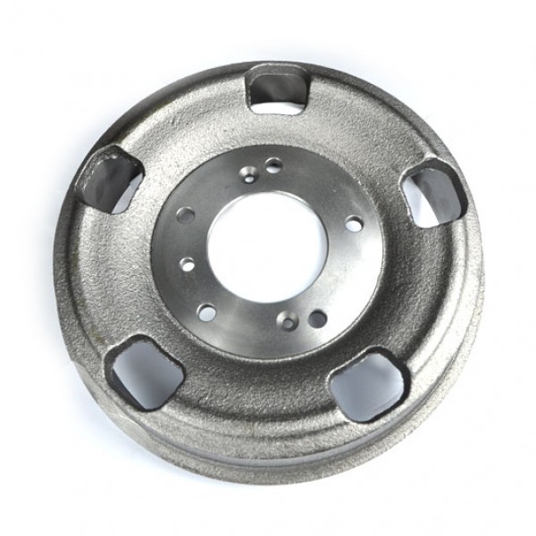

10-4 on the slotted balanced rear brake drums HealeyRick. A pair of these definitely reduced shake on my BJ-7 while improving brake feel and some effectiveness. The process required years to isolate and sort out. GONZO
Ditto .... I had a scuttle shake at 55-60mph for years. Replaced the rear drums with DWR balanced slotted drum about 10 years ago and solved the problem. Fredrick runs smooth now and loves to run with bon jovi.....
I have bought two balanced drums from Denis Welch (BRK220VB), to be continued...

I just had my 1st rear set of brake drums balanced from a local guy I know and as a result, driving my BJ8 has significantly improved, say 95%+. Yes, I "STILL" have this tiny little gyration and a low with a repetitive rumbling sound emanating from somewhere, maybe rear or even front, when traveling around 55-60 mph. But again, very slight sensation.
I have a second set of newer brake drums I also dropped off for balancing. I will compare when the 2nd set is balanced and placed back on the car.
I am noting this here because it will be interesting for me and hopefully, for all of us, to learn that just maybe one balanced set may differ from another. I also must note I did attempt to balance my first set using a static balancer, by grinding away the inner flange as best as possible. The balancing pro I went to assured me I did no damage when he needed to drill holes on one end of each drum and welded metal rods near the opposite end of the drums.
Moving forward and not to muddy this thread any, but, if I find that after the 2nd balanced set still achieves the same low rumbling and slight gyrating sensation, and maybe (as one member suggested doing) to swap out the drums at opposite sides (and further even "flipping the drums" after that), then I have to possibly assume, in my case anyway, there may be a transaxle or bearing issue that's needed to be addressed. For the moment, I will dismiss rust, scuttle shake as being any cause only because evidence is leading to a low rumbling sound issue as well as a slight gyration issue.
