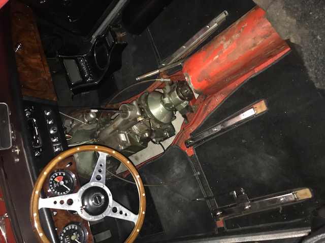

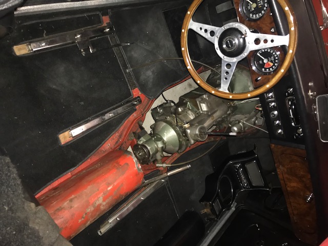

Althouh i have new balanced drums the car still shaking (jack stand car without wheels), i removed the dive shaft to check if the vibrations came from the engine or the gearbox, but nothing to report.
apparently the vibrations would come from the rear axle.

Thibault - with the car on stands, I would run it without the drums - to make sure even the new ones aren't out of balance.
With the driveshaft out of the car, examine the universal joints on the driveshaft for play - if the needle bearings in one of them have disintegrated that would put the shaft out of balance. I had that happen on one of my Alfas. U-joints are cheap to replace.
