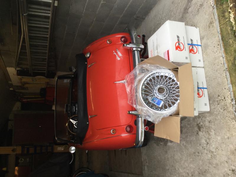

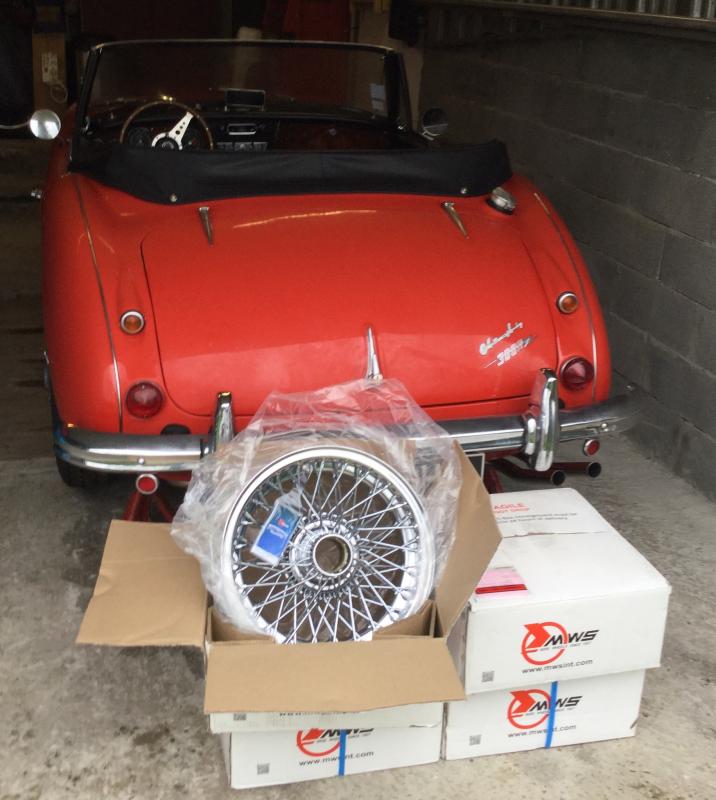

My news MWS Rims soon in my car, I am waiting for balancing cones (from smoothride)
