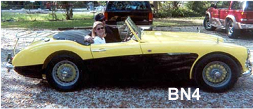

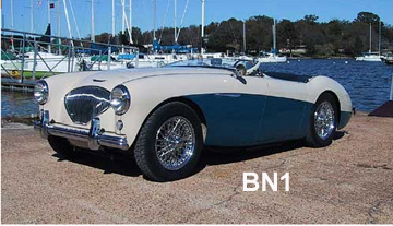

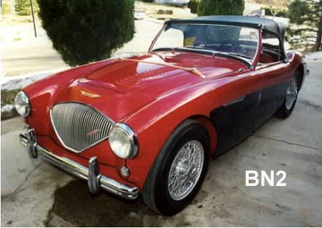

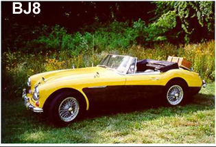

Hi John,
The cove paint should wrap around the vertical edges to just inside of the outer surfaces. Not on the inside faces of the doors or door openings or wheel openings.
The transition behind the front wheel varied with the model. See attached pics.
D
