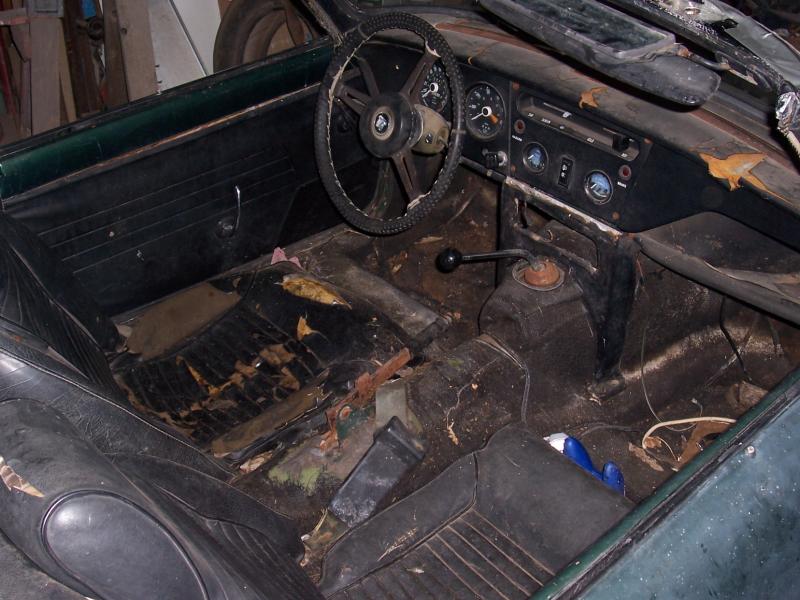

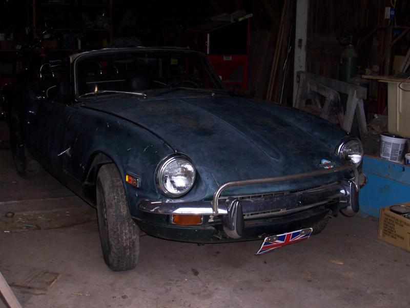

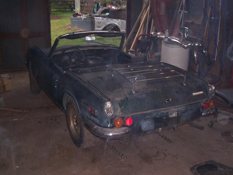

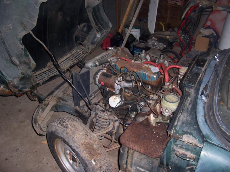

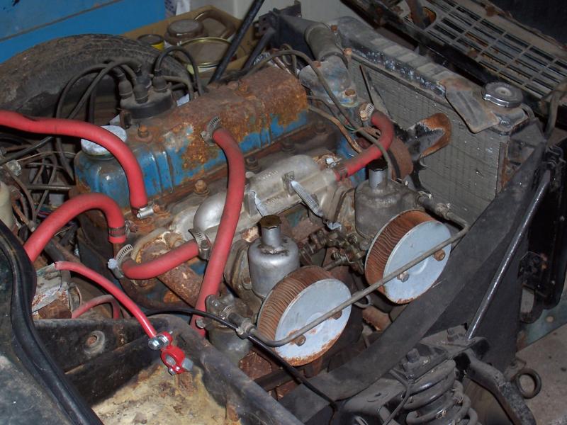

Here are some (admittedly bad) photos. The '70 is mine! It's another one of those "ran when parked" things. Did drop in some fresh oil and cleaned the carbies up a bit. Rigged it up to a gravity fuel source and darned if it doesn't run! Fuel tank is crusty and fuel line was plugged. Started the carb cleaner flush on the line and it sprung multiple leaks. New fuel line is in order along with a good tank clean and assess. Past owner gorilla'd the bung off of the tank so best case is a cleanout and some silver soldering. Sender looks like a relic from a shipwreck. At least it has a new starter and fuel pump. Mechanical- Ain't that easy!? Compared to Austin Healeys and Jags, Jensen-Healeys, etc. these are a cinch to work on! Haven't drawn any blood yet!

Seriously, it looks pretty darned good, and you are somewhat fortunate that some previous owner managed to get hold of an earlier Mk3 intake manifold and dual SU carb set to replace the 1970's original single Stromberg (as found on all subsequent Spitfires). If otherwise stock, that brings you back up to around 68hp as opposed to the 60hp or so of the 1296 with single Stromberg!
And you've got the AMCO accessory tubular front overrider bar, which is also very, very cool!
Hard to tell from dark, indoor photos: is it #55 Laurel Green or #56 Royal Blue?

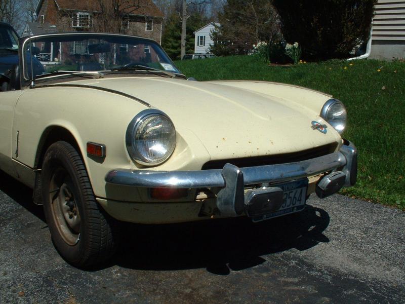

Oh, here's mine for reference.006.jpg I should note that this photo is from the day I picked it up, before any cleaning was done after 5-6 years in the previous owner's garage.

This one is 55-Laurel Green with 11- Black interior. It's rough but straight. Don't see any sign of a traffic altercation in it's past. Rust and neglect yes. Not a weekend fix but not NEARLY as bad as the Healey 3000 that I dragged in a while ago. I do kind of dig the front bar and the luggage rack as well. Now all I need is time and the "bucket theory" of finance. (Throw $20 bills in a bucket and after you fill it and smash it down a couple of times pour it on the car. It'll get nice!)
