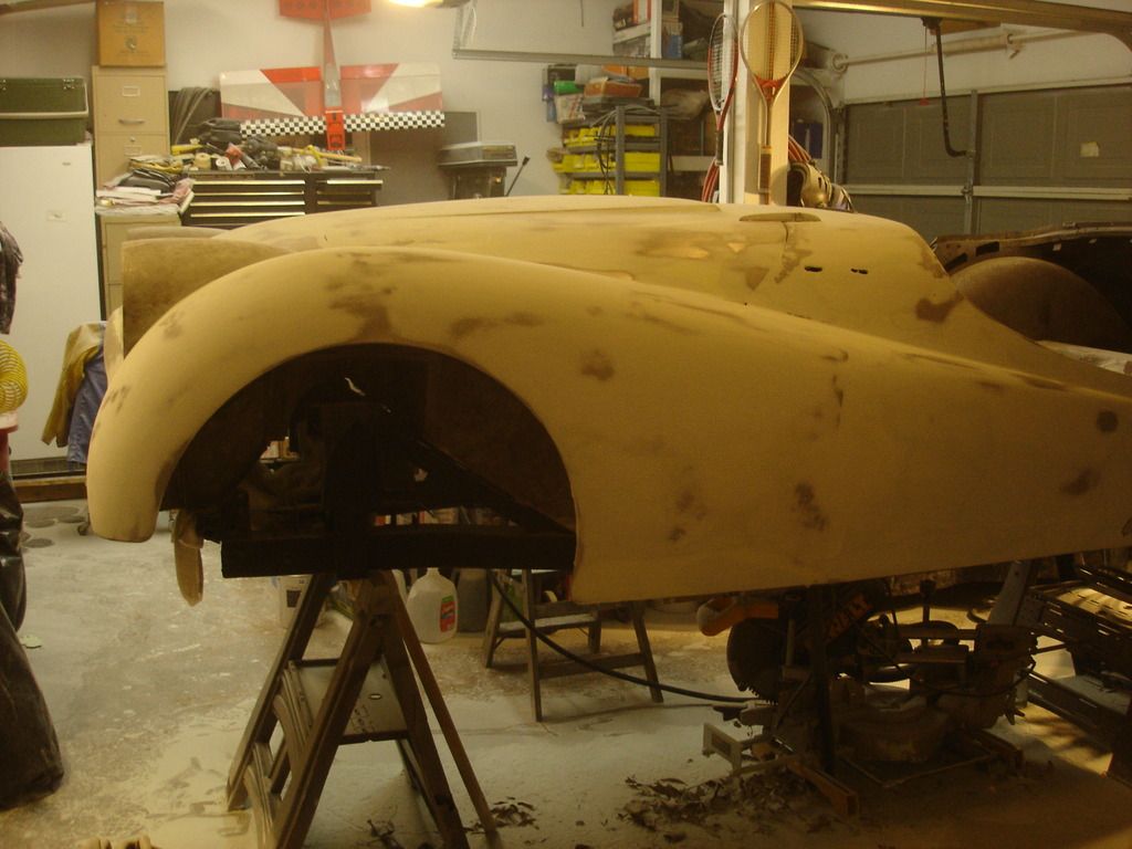

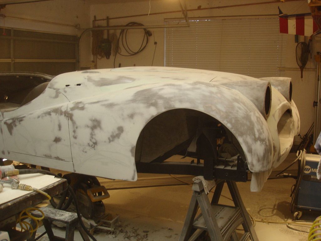

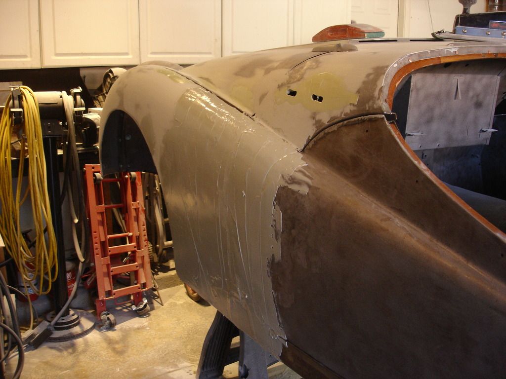

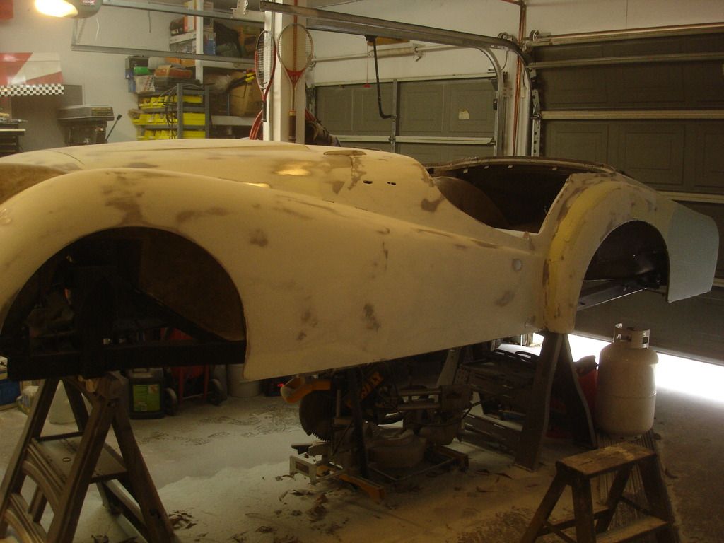

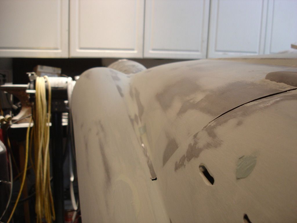

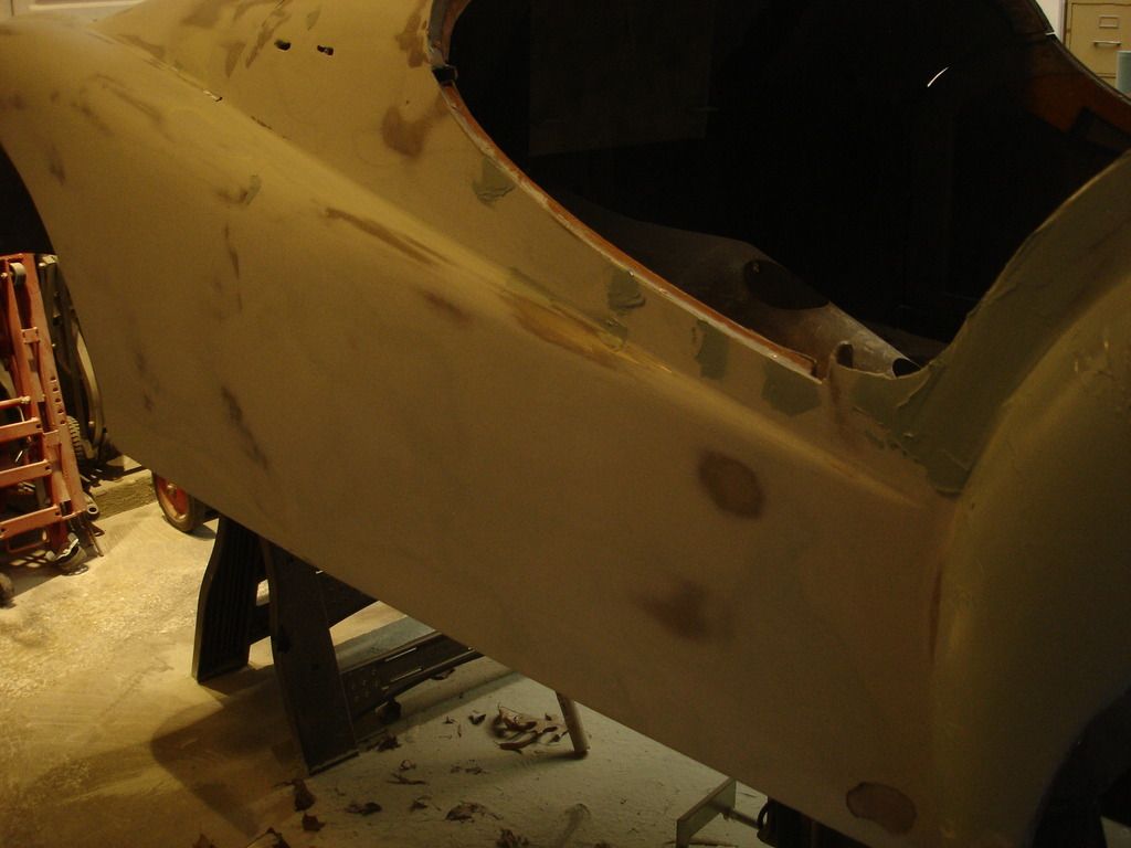

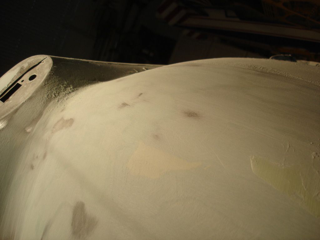

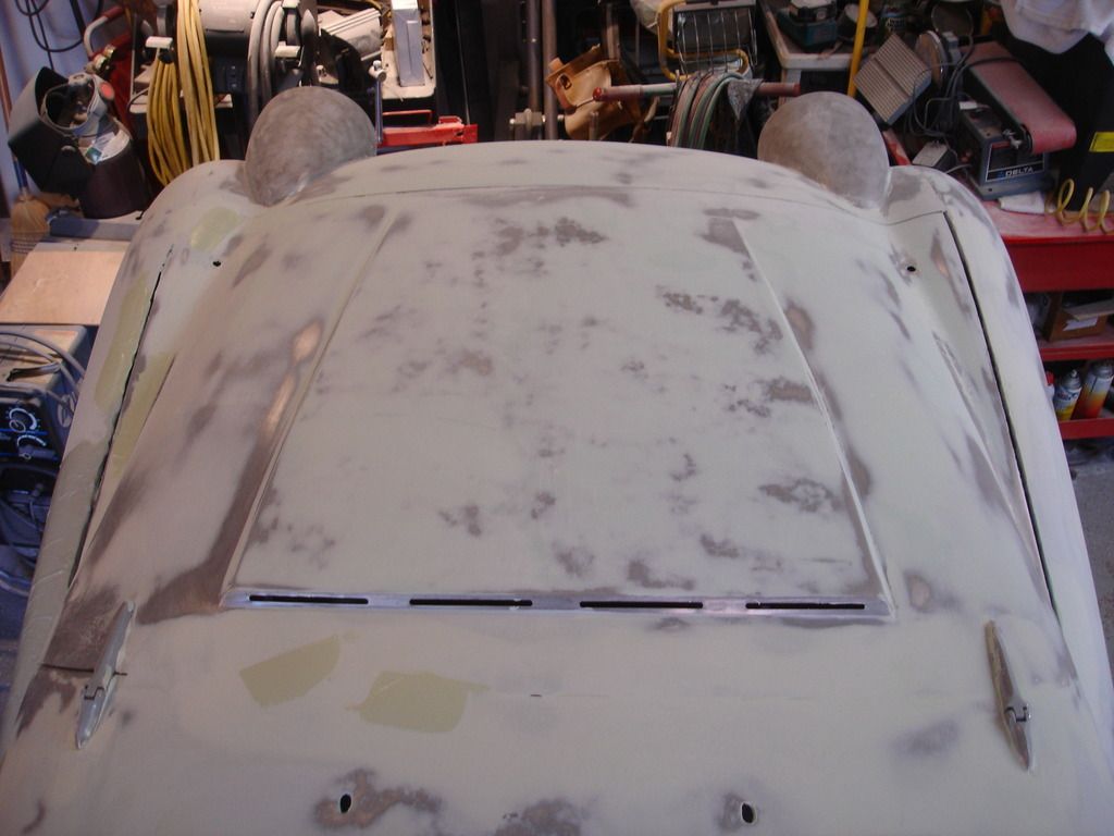

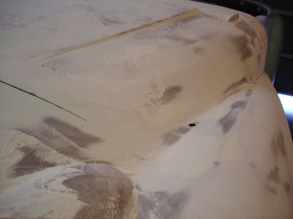

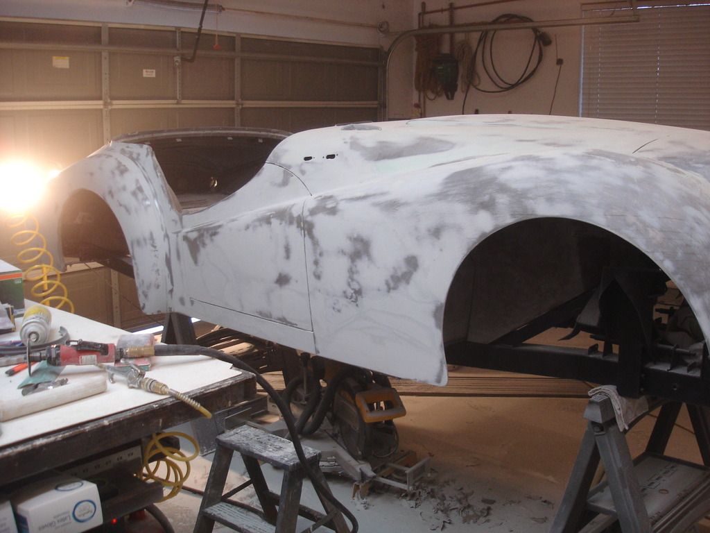

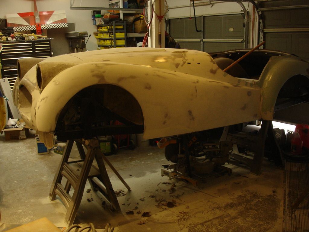

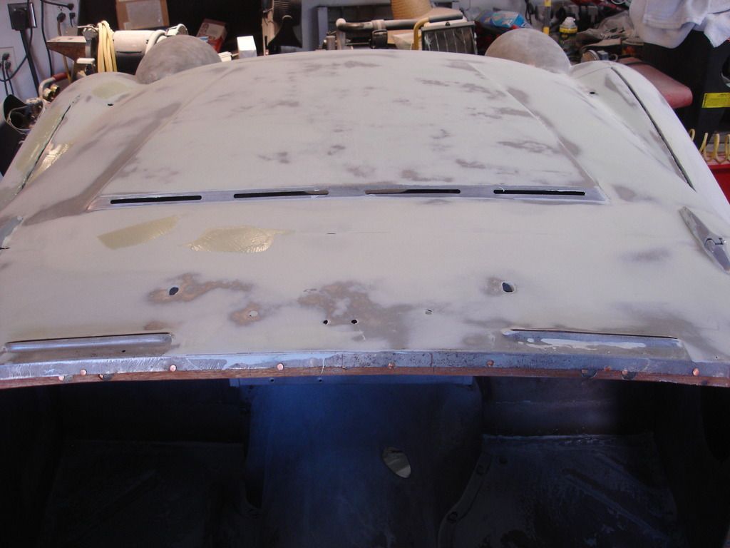

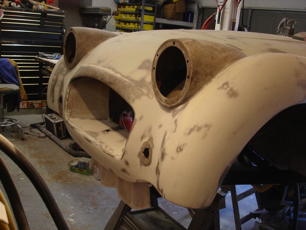

This week was more of the same...leveling the surface of the body with filler. There's not a whole lot to say about it, just a lot of mixing and dust everywhere! The family kicked me out of the house becasue every time the garage door opened a cloud of dust followed me wherever I went. That's what they get for not letting me build a shop!
But it all came to an end last night, as I cleaned the dust out using a leaf blower in the middle of a snow storm. We don't get snow in this part of Texas very often...so I did indeed finish the leveling on a "cold day in ****"! But enough of that...here are the pics...

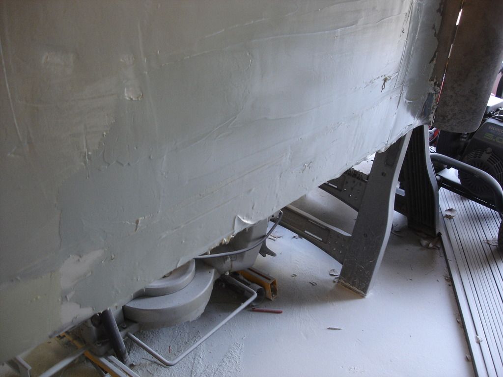

As you flip through the pics, you probably noticed that I quit opening up the panel seams after each layer of filler. I started that after I started working on the rear of the bonnet. If you remember, the rear edge of the bonnet is just a raw metal edge...so every time I tried to sand it, I realized that it flexed from the pressure of the sander...no matter how lightly I tried to sand. I decided the solution was to just fill the gap, so the edge was then bonded to the scuttle. That way the edge was fixed, so I could apply as much force as I wanted to without getting a deflection of the bonnet edge.
Once I started using that technique on the bonnet...I simply decided to do the same on the entire car! At the end, I opened up the gaps again using the cutoff disc. Of course there are a few spots that the disc skipped and made a little mess...but those are easily patched. If you asked if I would recommend filling the gaps until the end...I'd have to say the book is open on that. It worked for me. For some it may be difficult to find the gaps to re-open them. I can say that it makes a slick body, though! When the panels aren't flexing, every gap is "unstressed". In other words they do not flex out of plane with one another do to the pressure from the sander.

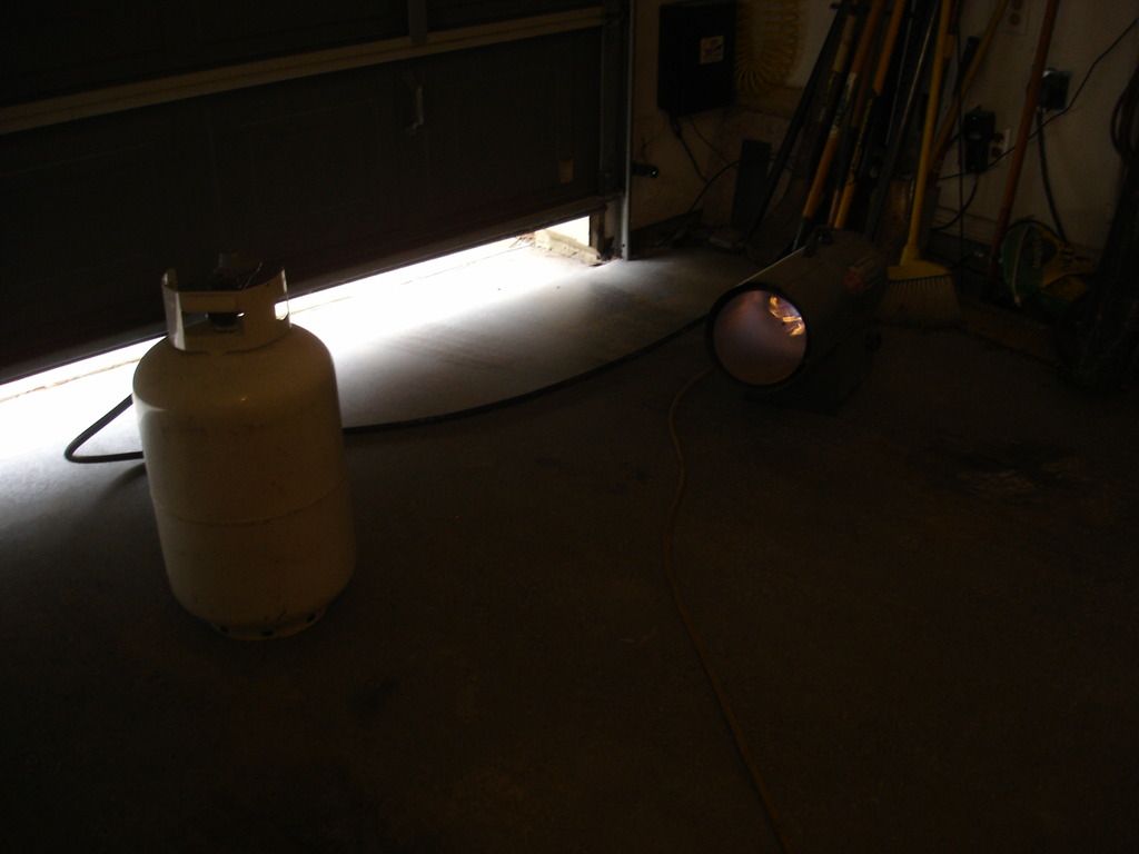

The last 3 days the temps have been in the 20's here. I know that's nothing for many, like Tush...but it's cold for us Texans! These are the final pics, after all the leveling is done, but before cutting out the panels. I gotta say, The TR looks really good with no panel seams...shame we have to cut them out!

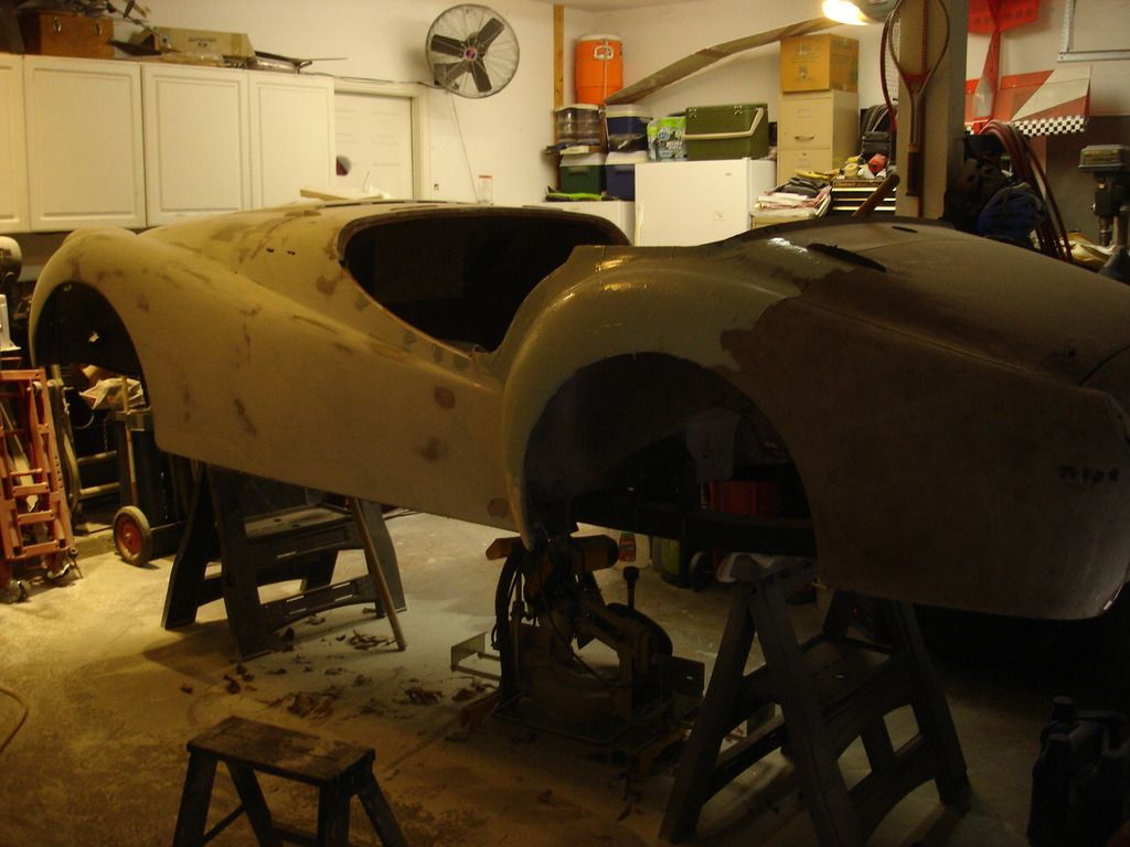

This is the paint color I will use, thanks to Dan's help. It's the 1990 "Jag racing green", PPG code 46169. The first pic is taken in the garage, and you would think the color is black. The second is outdoors, and with full lighting it becomes a dark green. The first mix is in "DCC", which is a one stage urethane paint to be used on all the interior panels. The exterior panels will be a 2 part, DBC base with DCU2002 clear coat over the top.

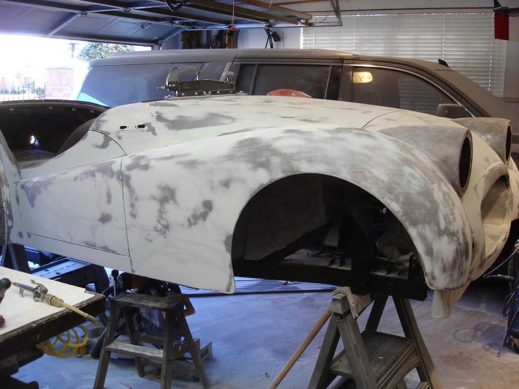

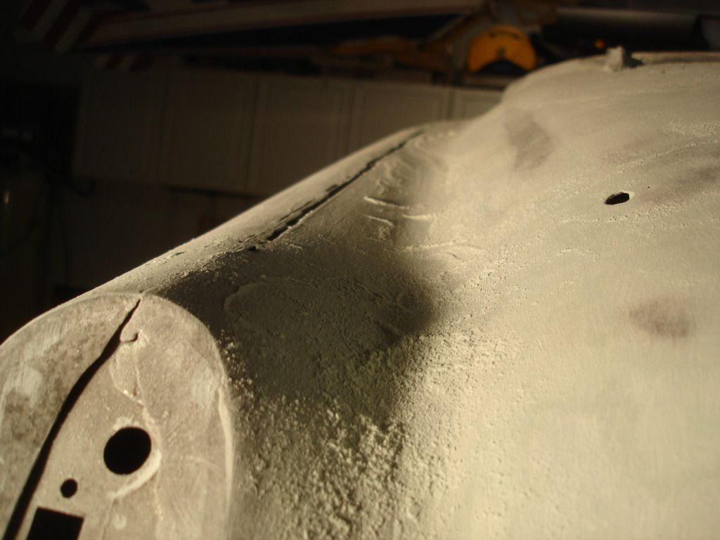

I took this to show how lighting is very important when it comes to leveling. Just like at sunset the shadows become long on the ground, by placing the light at a very shallow angle to the area you are working, any high spots stand right out.

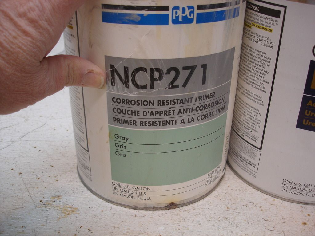

This is my favorite PPG epoxy primer. Every panel will get sealed with this, inside and out. It is available in 3 colors...I always keep this "black" around at all times. All my chassis parts get a coat of this with no top coat, for a nice semi-gloss finish that is durable.

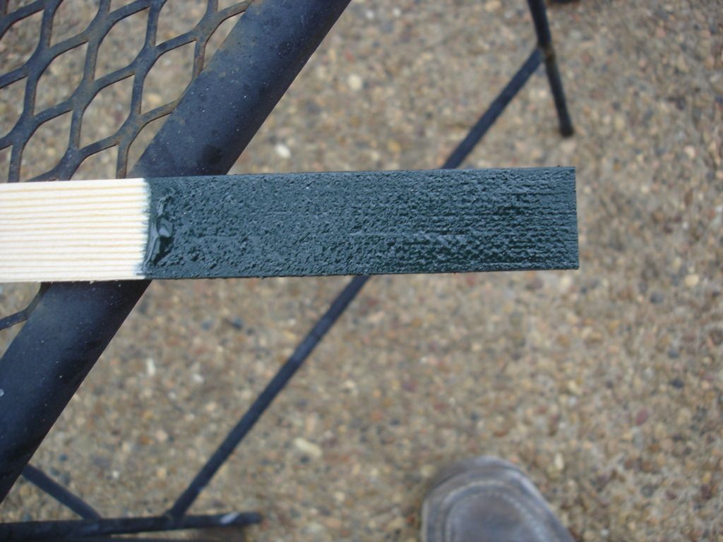

This is the finish paint for all the insides and undersides of the car...all the places that will not show when you walk up to the car. It is a 2 part, one stage urethane that dries glossy. Once the outside of the panels have been sprayed with the light grey primer, I will finish the insides with this color coat, right over the top of the DP90L and without sanding.

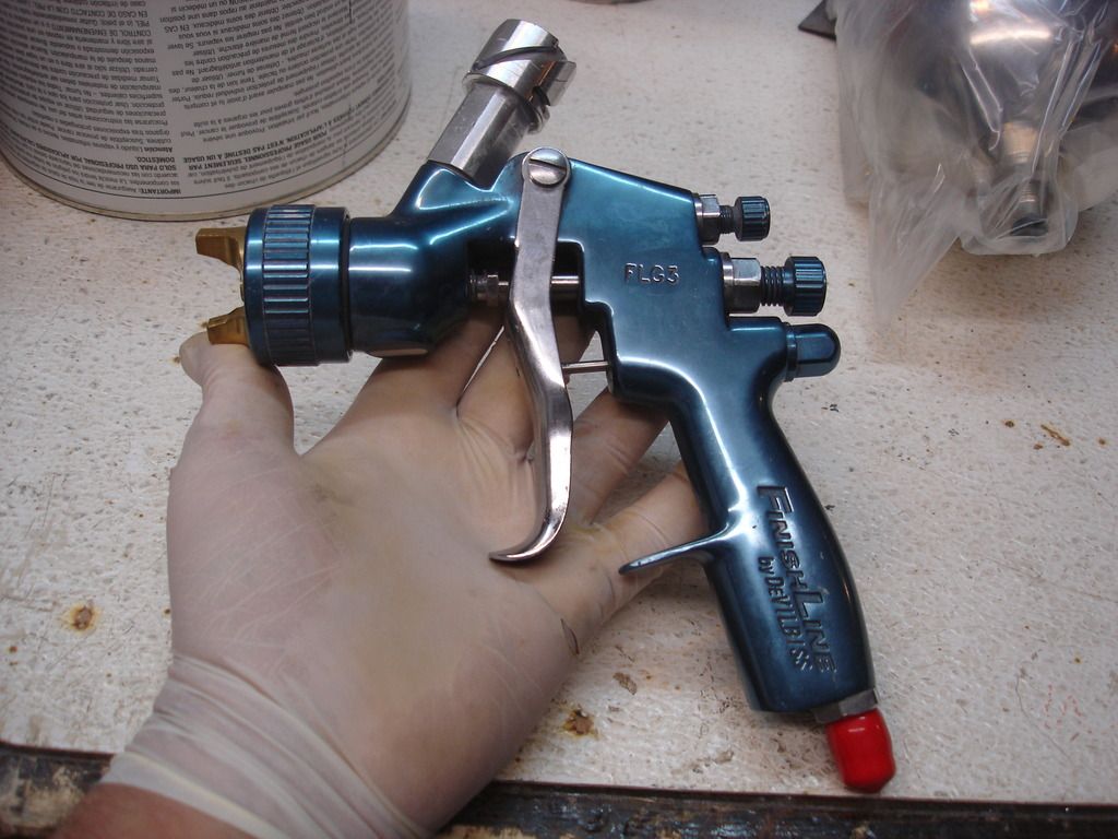

For starters, let's look at equipment. This is the gun I am using at the moment. It is a medium price gun that comes as a set, including the fancy case. Contrary to popular belief, you can get a perfect paint job with the cheapest Sears and Robuck gun you can buy. The difference between the cheap and expensive is the amount of effort it takes and the flexibility you have. This gun comes with 4 different tips, so it will spray everything from thick fiberglass gel coat to very thin urethane clear coat. A cheap gun will only work for one viscosity of paint...so you have to play with thinning to spray anything thicker than clear coat. Also, a cheap gun will have quirks...like dripping from the cup onto your work.
So, even though a cheap gun will do it, you are always going to be happy spending on the best gun you can afford. Let's go over some features.

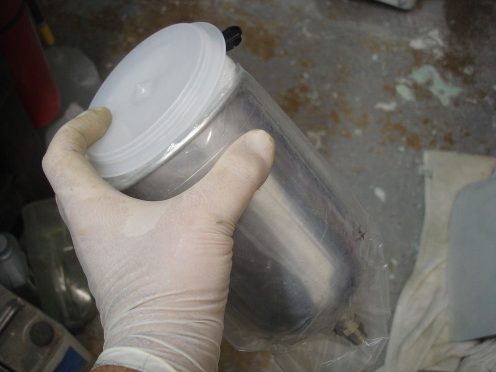

For starters, here is the cup that came with my gun. It's a hard cup...very old school. It is removable, which aides in cleaning. Many guns have integral cups, which make it a bit trickier to clean and fill. But...
Solid cups are a true PITA. If you plan to do more than an occasional small job...Trash the hard cup. There is a better way!

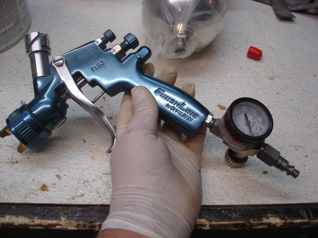

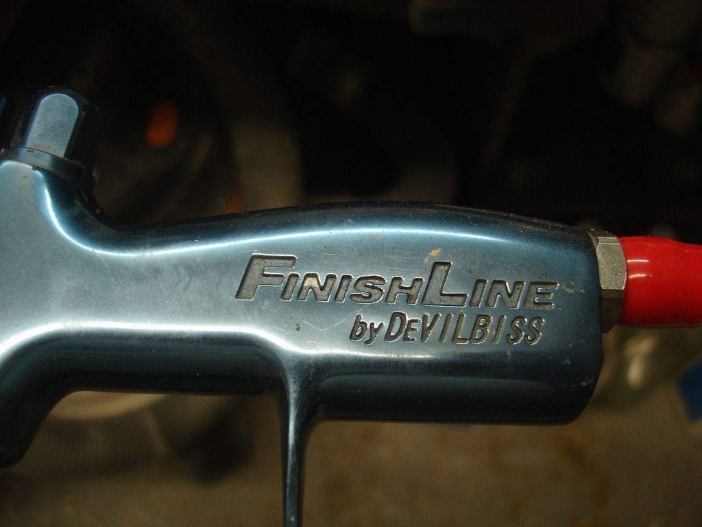

My gun is a DeVilbiss Finish line series. We'll go over the features, both good and bad. To begin with, it is an HVLP, or high volume low pressure model...as are almost all guns you buy now days.

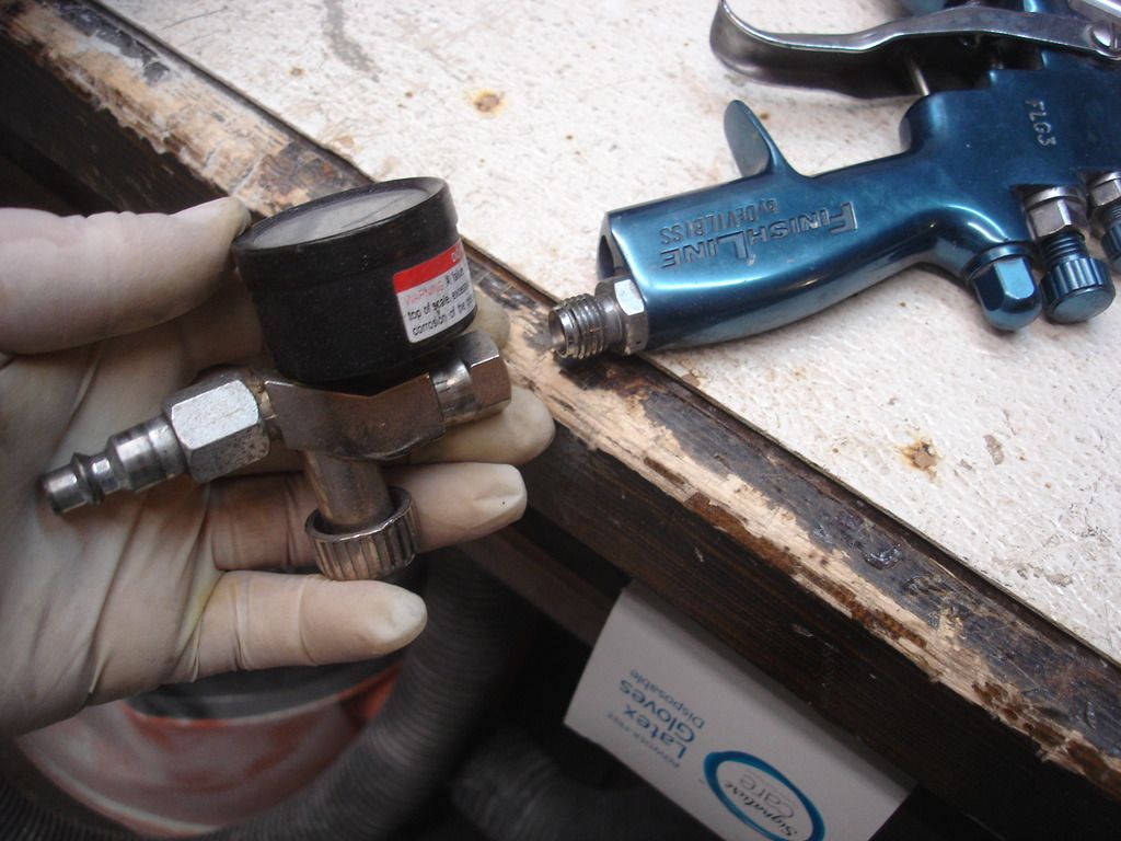

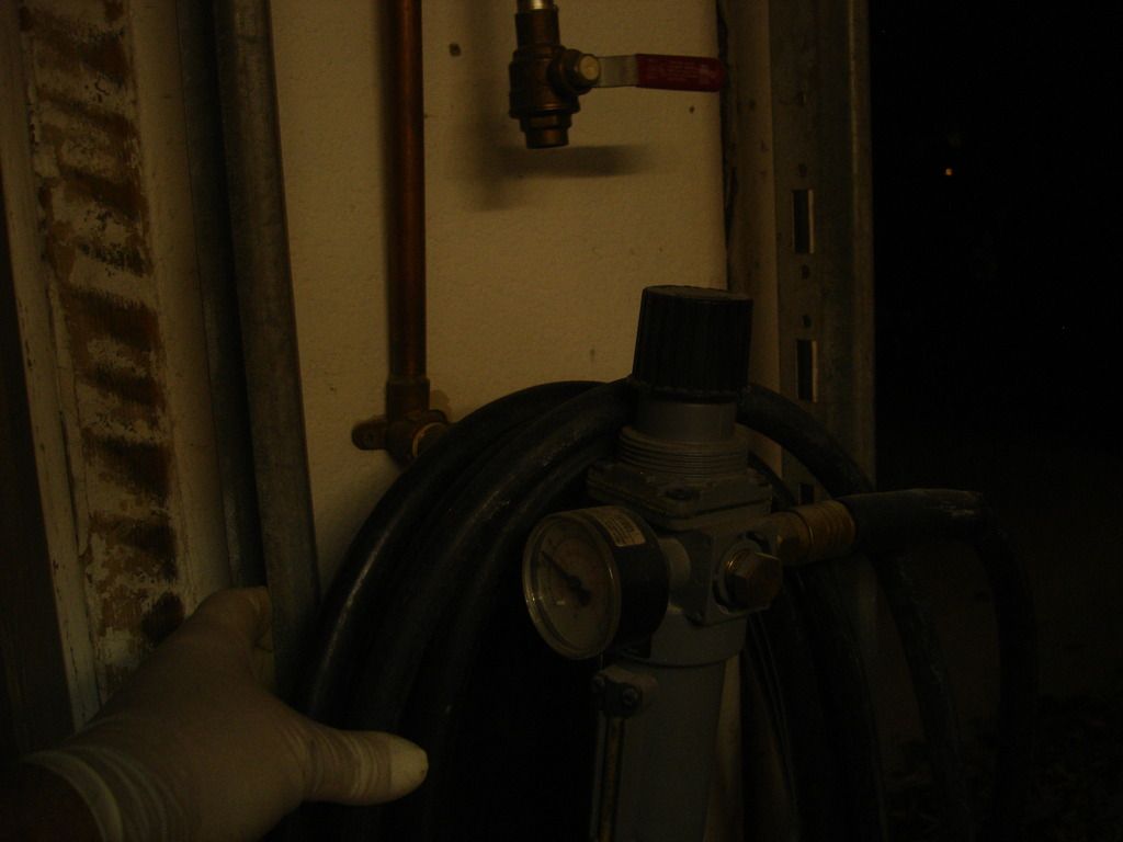

With any gun pressure is critical, and that is especially true with HVLP's. You must control the pressure at the spraying tip, and the only way to do that is with a regulator AT the gun inlet. This kit came with a regulator. Once you use one, you will find that the pressure you run going into to your hose has little to do with the pressure you get at the tip. Later I will go into how to use it, but for now just plan on running a second regulator.

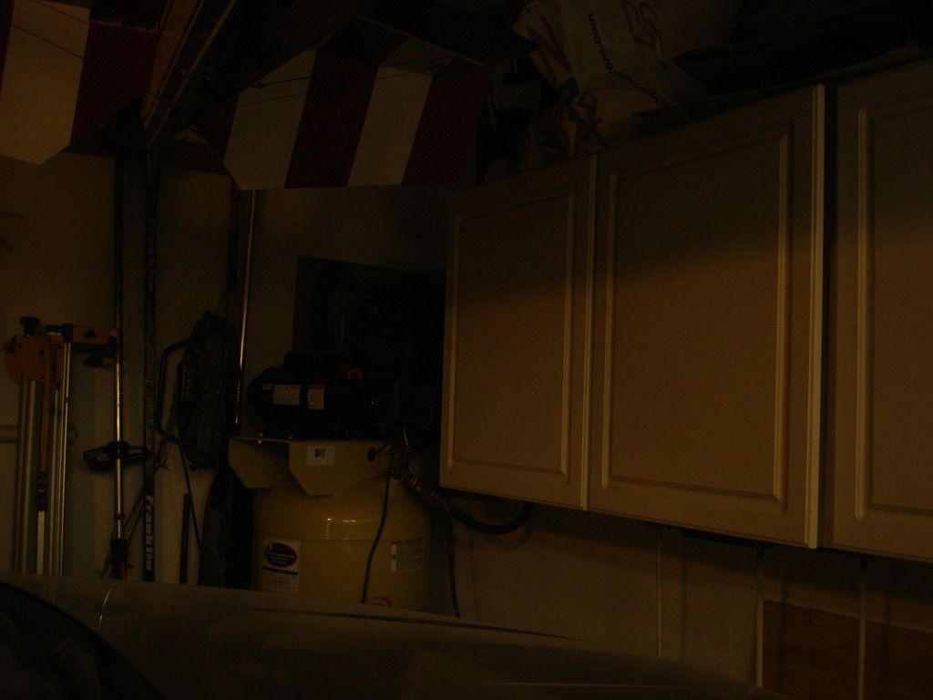

Crappy pic, but it is showing my compressor. The larger the compressor, the cooler the air it will provide. The cooler the air, the less water condensation you will get in your lines. The less condensation you get...the less spitting you get on your paint job! Anything that reduces condensation is VERY good.

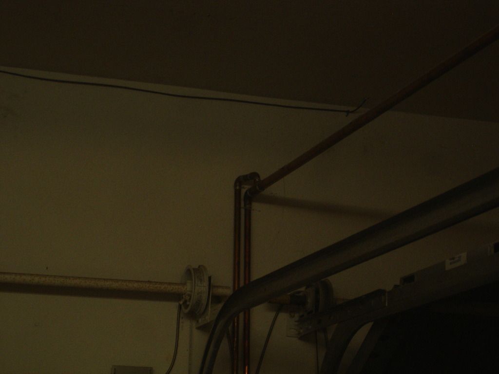

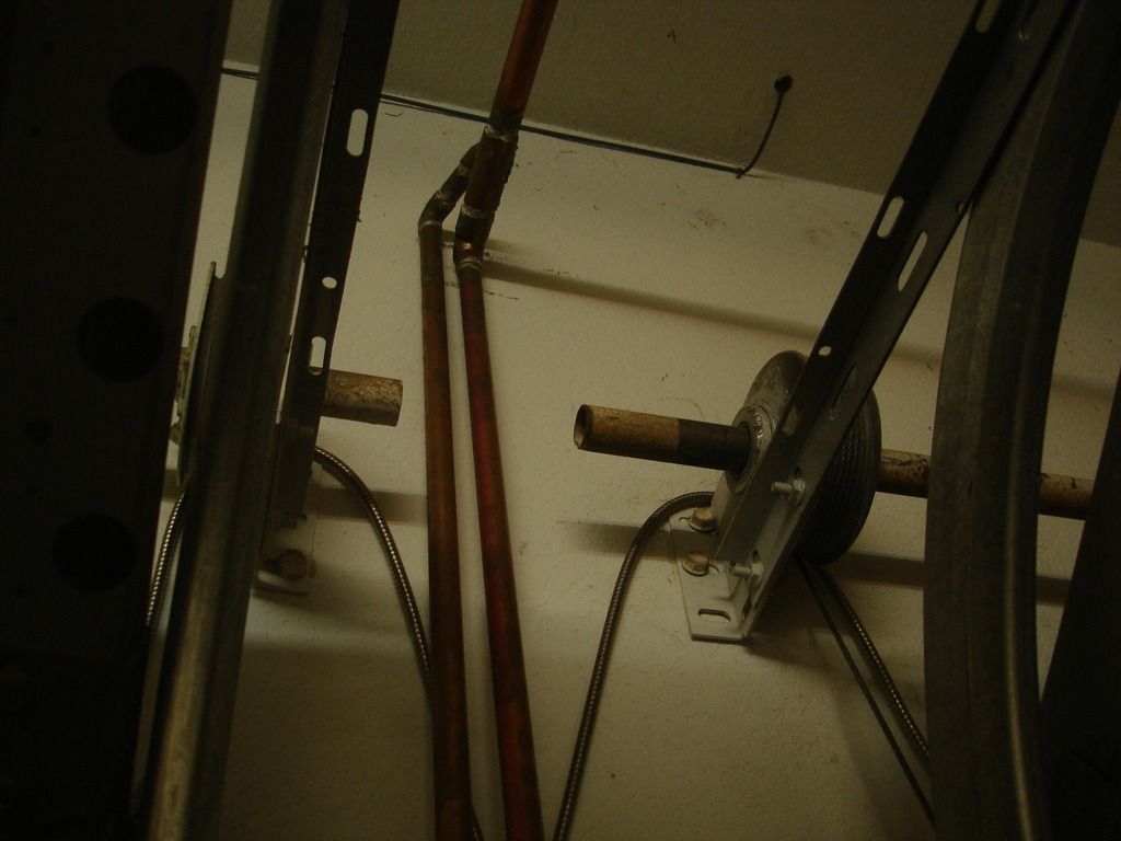

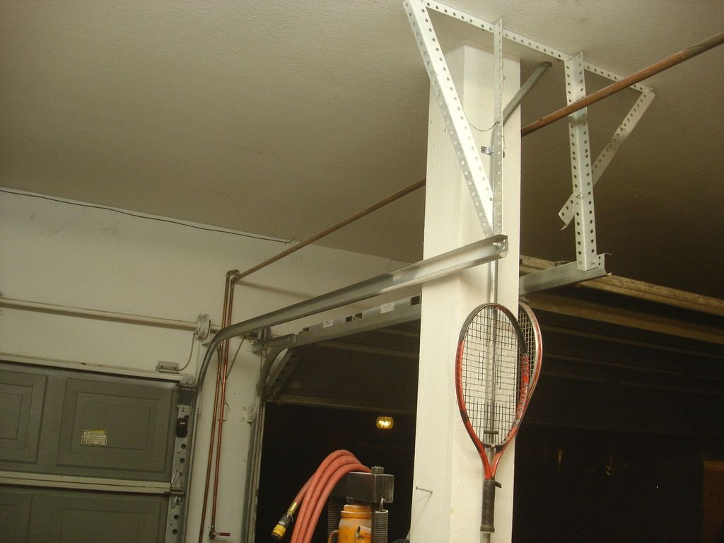

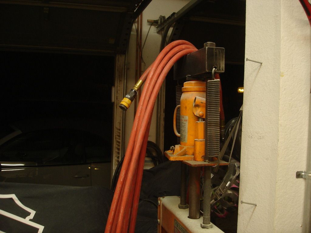

Planning your shop air lines is worth every minute you spend. I use copper lines, as copper transfers heat well, so any heat generated at the compressor will be cooled in the copper lines. I am doing this to FORCE condensation as the air comes out of the compressor. Notice the copper line has a slope to it. I did not just clamp it to the ceiling, as I want the condensation to run downhill in a predictable manner.
This is looking at the end of my paint line run, where the pipes come back downward so I can tap my paint hose into it.
This shows the "end of the line". Note that one elbow just turns straight down. This is where all the condensed water will go. The "T" fitting that goes upward BEFORE turning down is the tap for my painting. Water is heavier than air...so the air goes up, but most of the water stays down and drips into the 90 elbow.
This is the bottom of the 2 pipes. On the right, the pipe from the elbow has a valve to drain the condensed water out. I will get a gallon of water out of it on an average spray job.

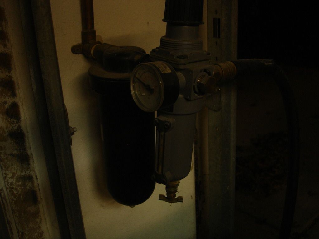

At the end of the paint line, I have 2 water separators. I would add more if I could. Removing water from your paint hose is truly that important. The longer you spray, the more condensation builds. If you don't control it, it will start to spit on your work about the time you are laying down your final coat. It ruins everything. Compressed air also contains a small amount of oil from the compressor. The separators remove that too.

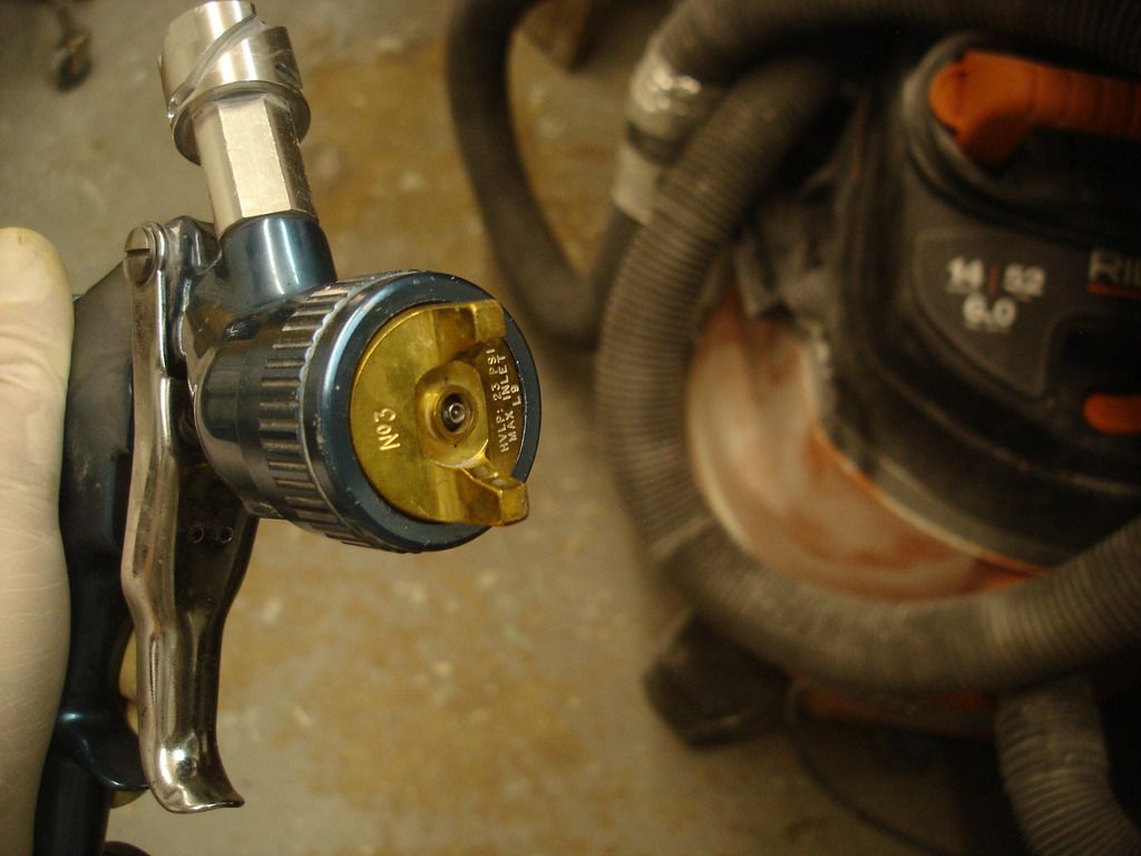

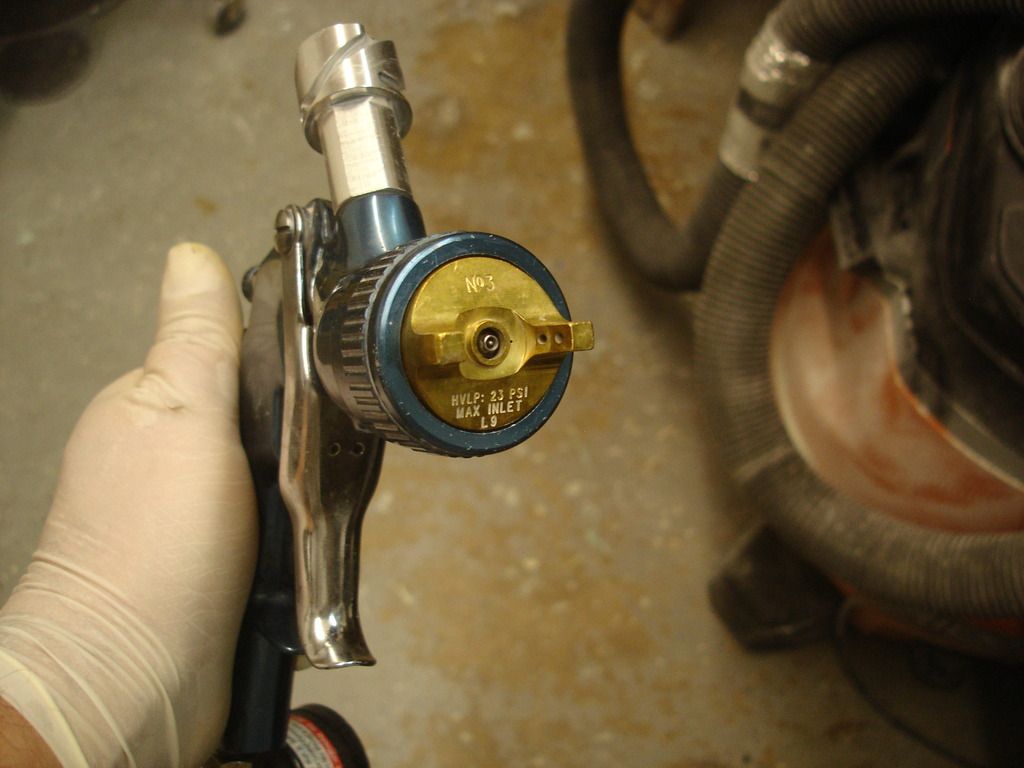

Now let's take a closer look at the gun itself. Most guns are pretty much the same in the way they are constructed. Here we are looking at the 4 tips that came in my kit. In a good gun the tips are removable. In a cheap gun they will be cast as part of the gun itself...so what you got is what you got.

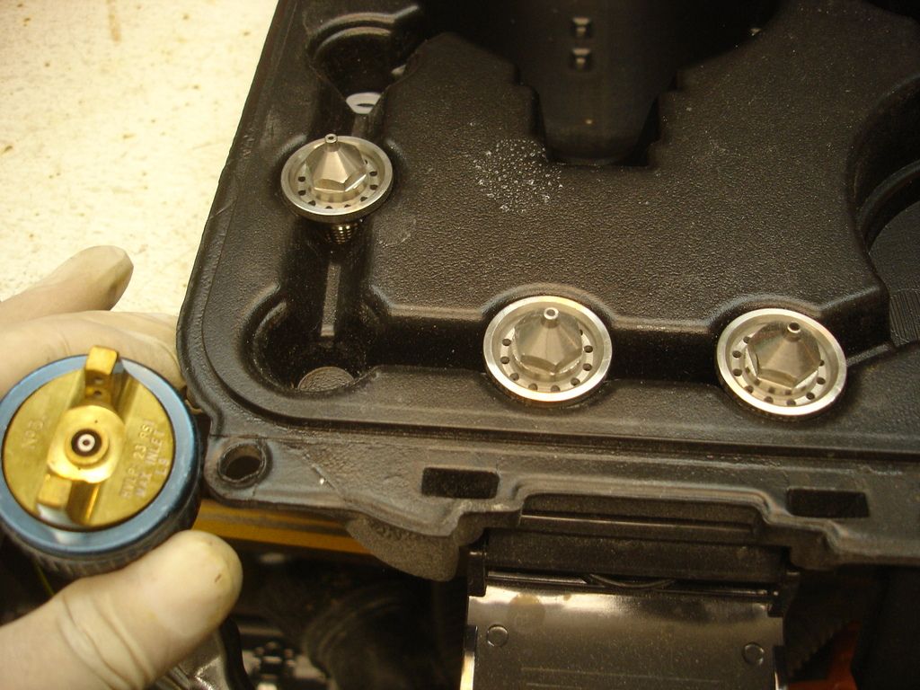

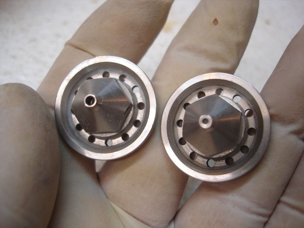

This is a close up of the smallest tip compared to the largest. The large tip will easily spray unthinned primer. That saves both money and time when you don't have to thin every batch you spray. If you try to use that big tip so spray a thin paint, you will get an uneven spray. Thus the small tip! The small tip will spray very thin paints, namely urethane clears, very evenly and without spitting.

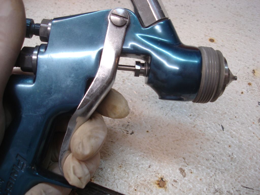

Changing tips takes less than a minute. First, unscrew the hand nut holding the the fan tip on and remove the fan tip.

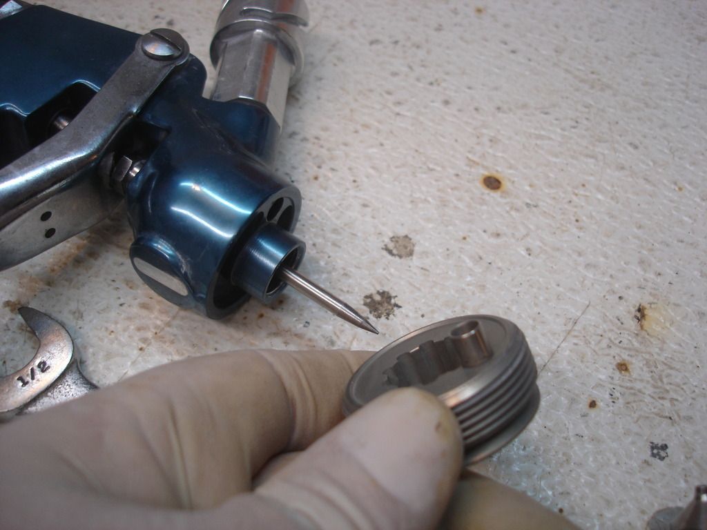

Now, we must squeeze the trigger for the next step. The trigger pulls back the needle that controls the flow of paint. The needle is set inside the nozzle tip, so it could get damaged if we don't pull it out of the tip before removing the tip.

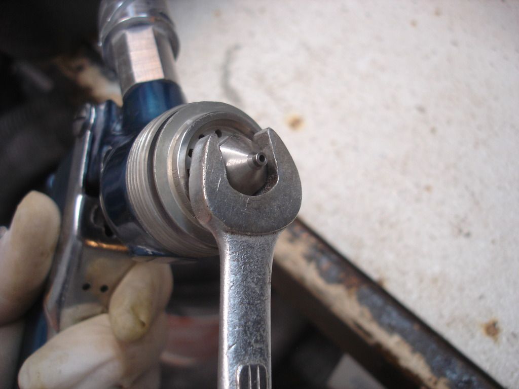

With he trigger still held back, simply unscrew the tip.

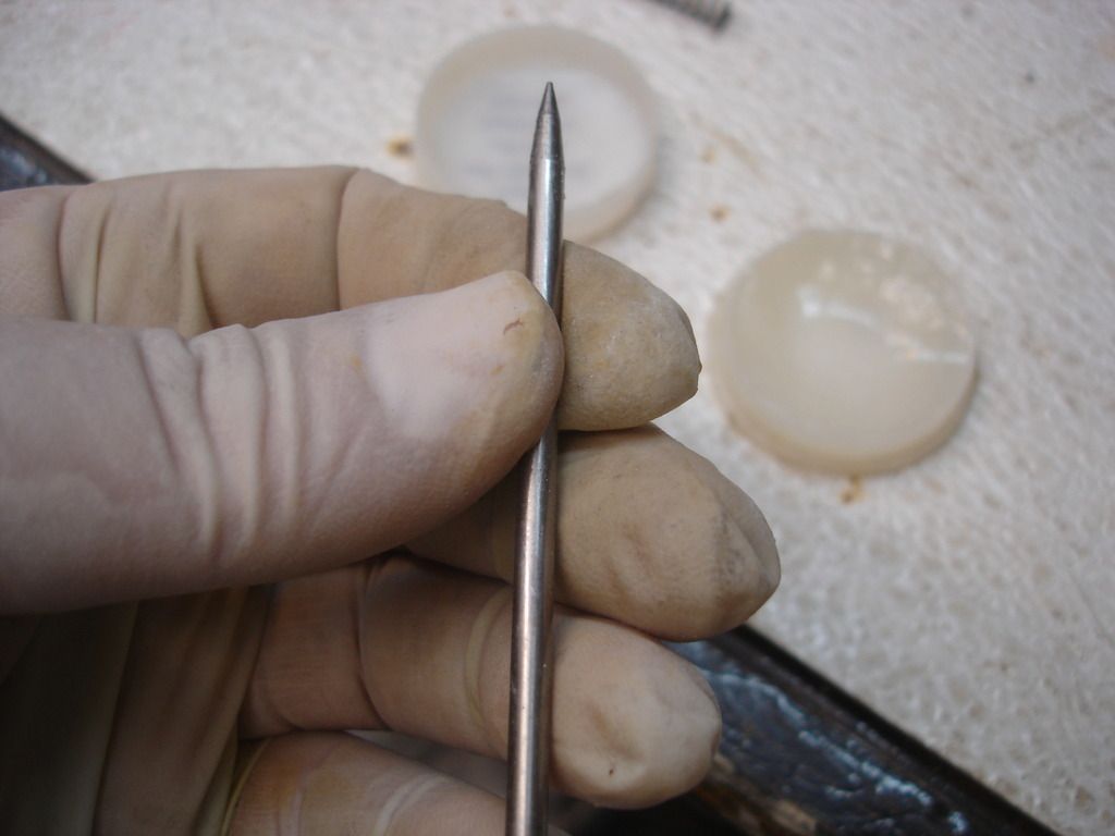

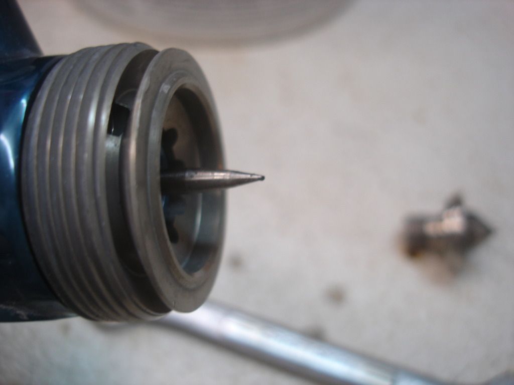

This is the needle that we were holding back. It metered the amount of paint being sprayed, so it is important not to bend or score it.

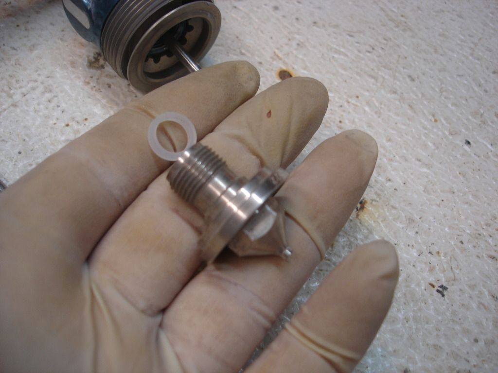

Under the tip is a nylon seal. I have been using my gun for 5 years and have never had to replace that seal. If you don't over-tighten the tip, the seal will last a very one time. Just snug is enough when installing the new tip.

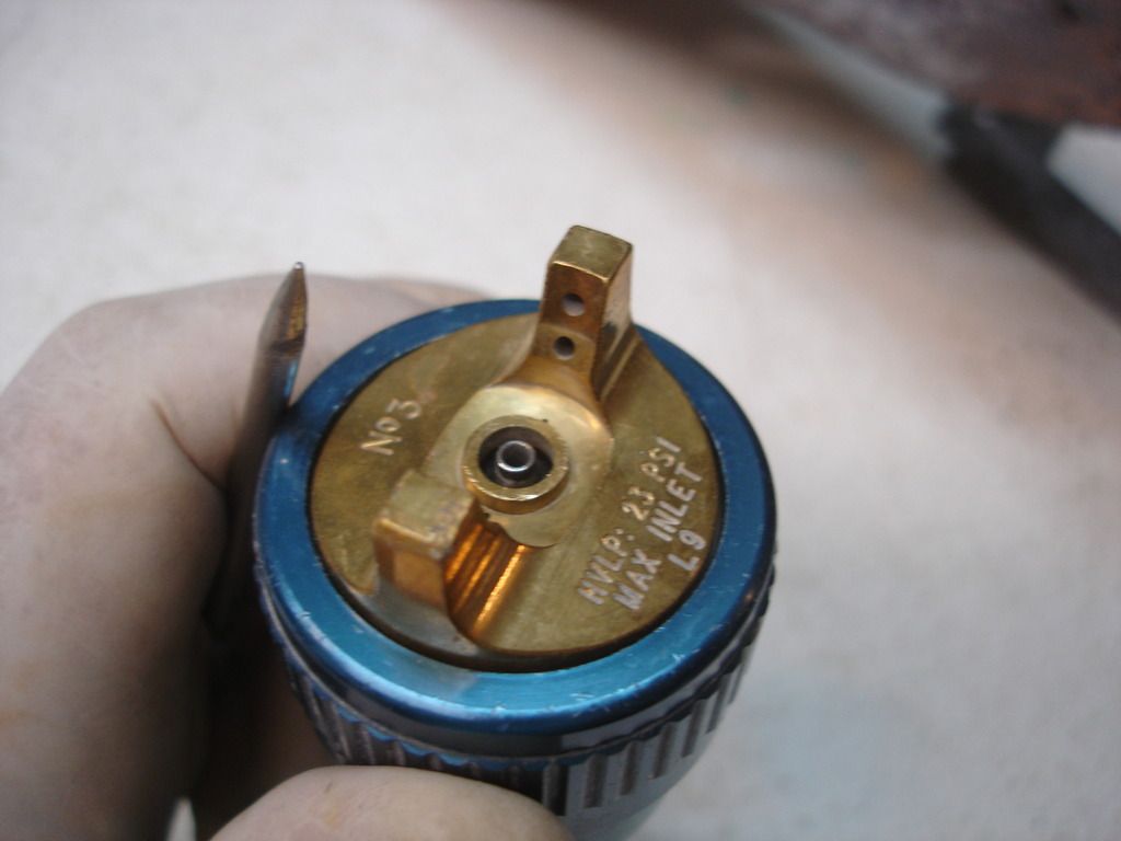

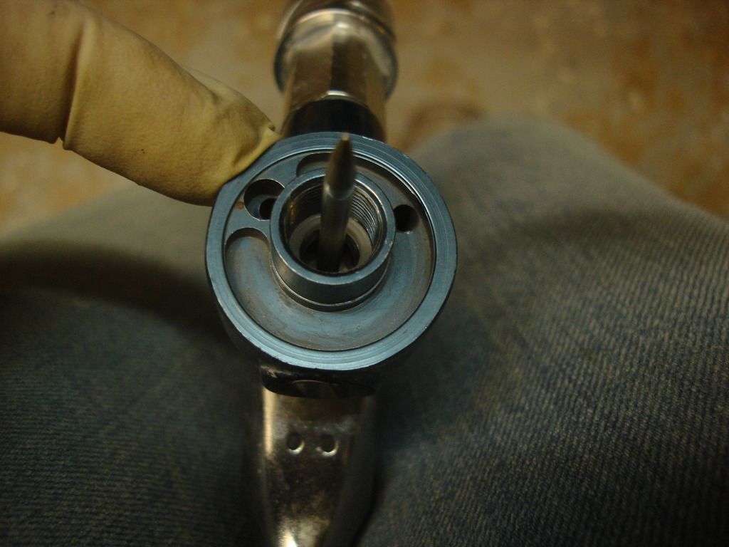

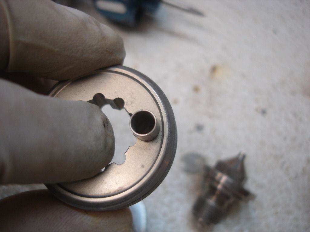

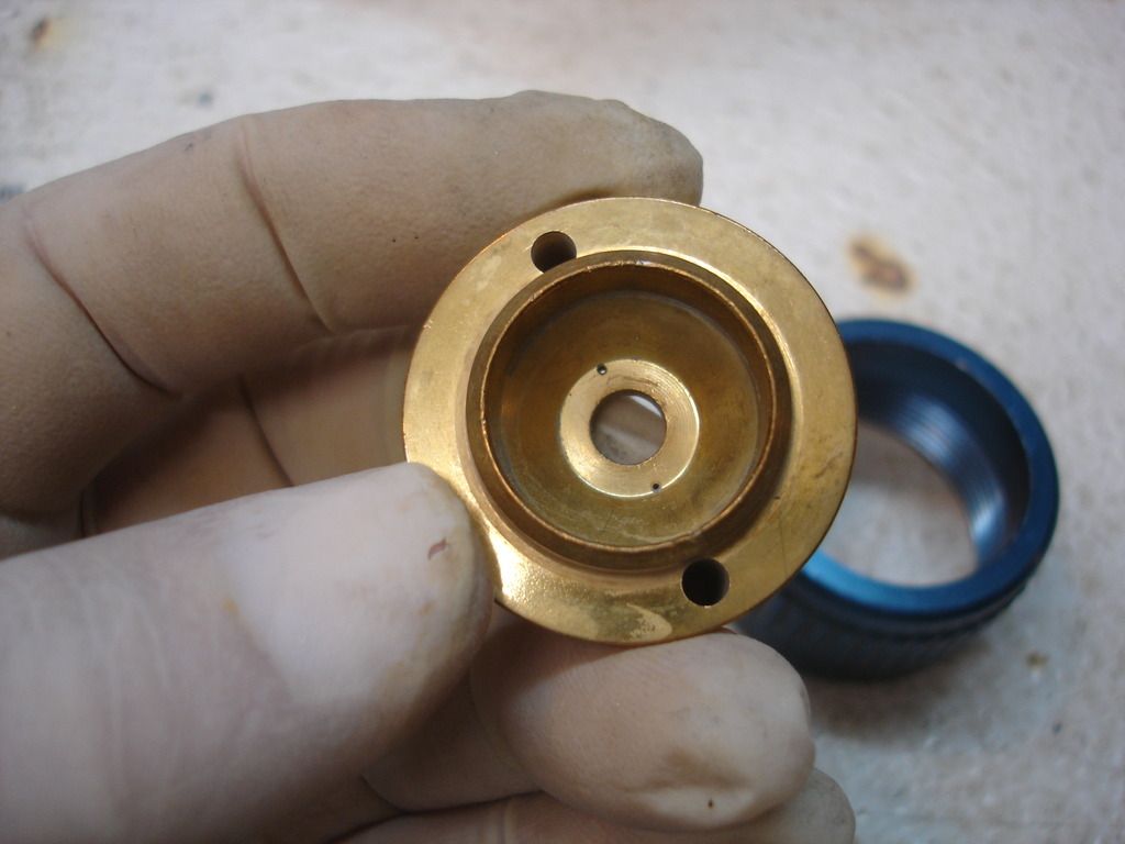

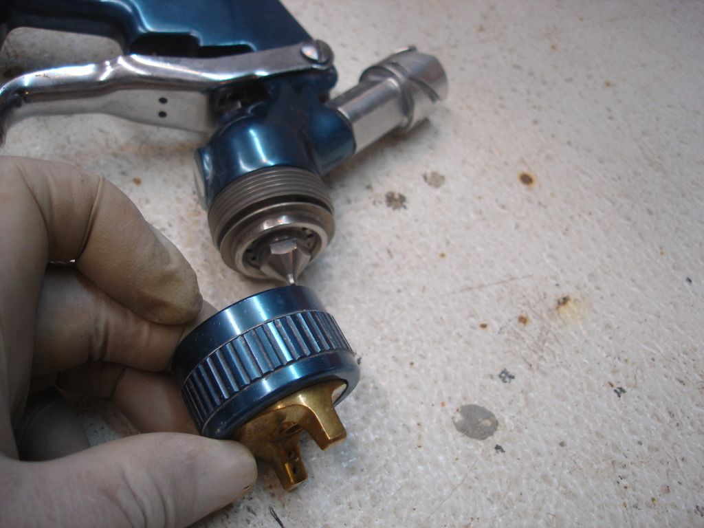

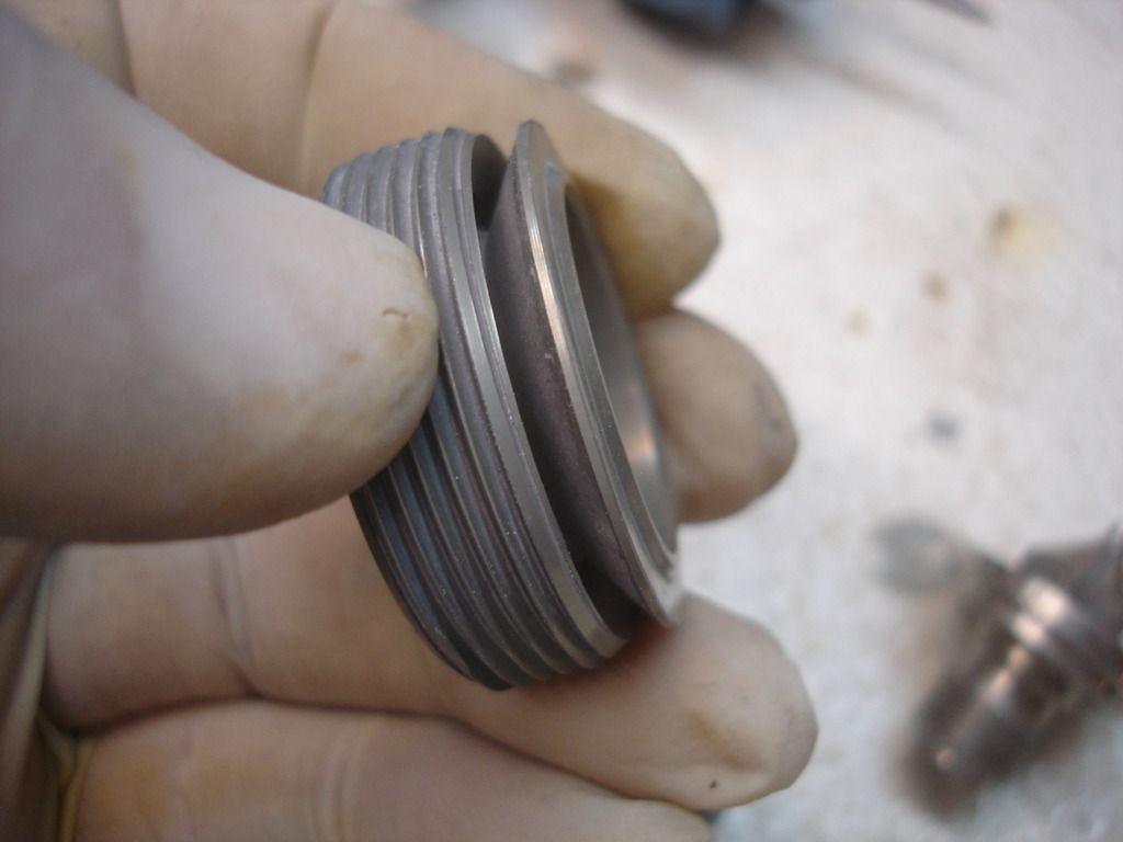

While the tip is off...here is a look at the air ring. This channels the air that makes a fan pattern around the air that sprays the paint. It is a slip fit on the gun, and is retained by the screw in tip itself.
The fan pattern is controlled by the upper nut on the back of most guns. If the nut is tightened all the way inward, air is cut off tot he fan tip, so the spray pattern is perfectly round. If you open the nut, it regulates air through the air ring to the fan nozzle.
The air from the fan nut goes through the hole I am pointing to on the left of the pic. Paint is held in the large center hole, by the tip and needle we saw earlier.
This is the hole in the air ring, that carries the fan air around the paint tip to the fan nozzle.
From the single hole in the back of the air ring, it spreads all the way around the ring by the time it reaches the front.
Finally, the fan air is forced through the holes on the sides of the fan nozzle. This air has the affect of flattening the spray pattern from perfectly round...to oval shaped.
So, long winded, but just remember the upper nut controls the shape of your spray pattern. Round is best for shooting into deep spaces...like a TR3 spare tire holder. For the other 90 percent of spraying, it is easier to paint if you are using an oval shaped pattern.

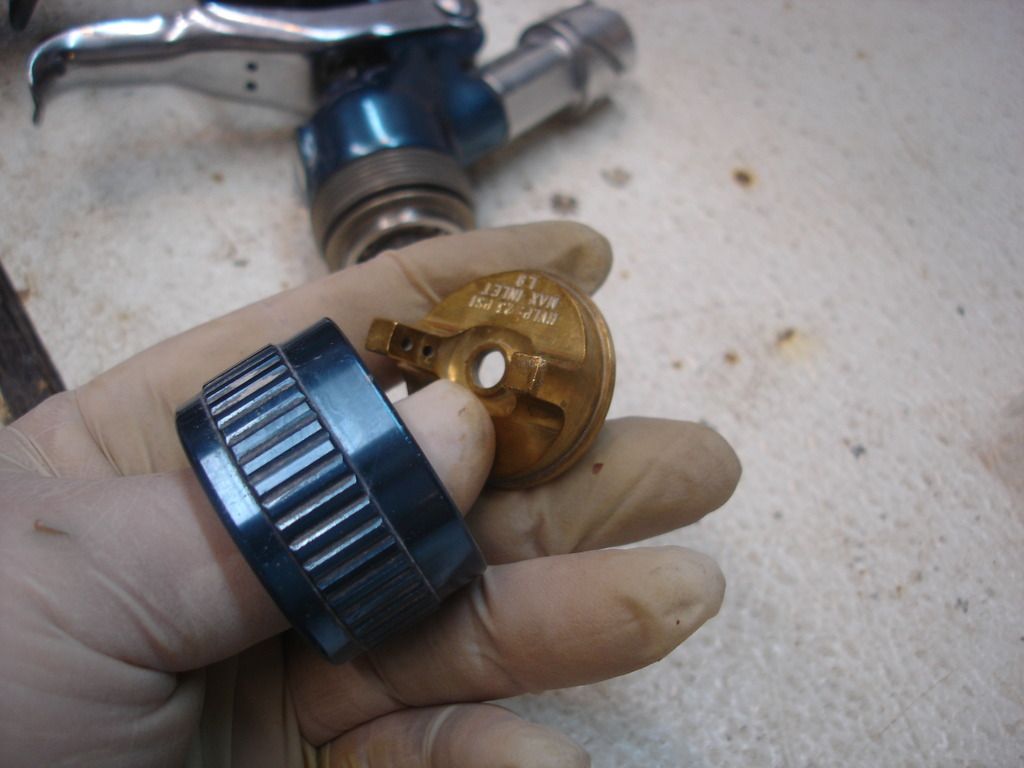

The tip goes back in the opposite of the way we took it out. The fan nozzle can be turned to any angle...by loosening the retaining ring, turning the tip where you want it, and retightening the ring once again. As shown above, the spray pattern would be tall and skinny.
If turned like so...the spray pattern will be very wide, and not tall at all. Of course that assumes you have the fan nut at the back of the gun open. With the nut tight, so there is no fan air flow, the pattern will be round no matter what the orientation of the nozzle.

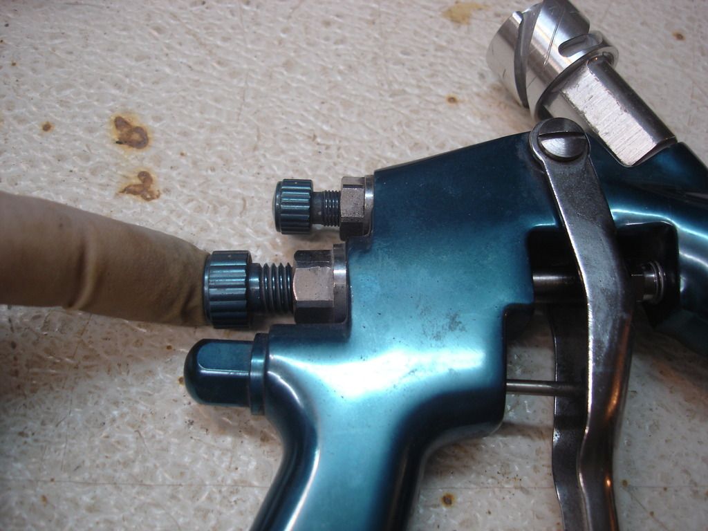

Moving down on the rear controls...the second nut is the paint flow control. It controls how far the needle can be pulled out of the tip. That controls the amount of paint sprayed. Nut all the way in...no paint comes out. As you back the nut out, the flow increases proportionately.

Here is the tip of the needle compared to the paint tip it goes into.

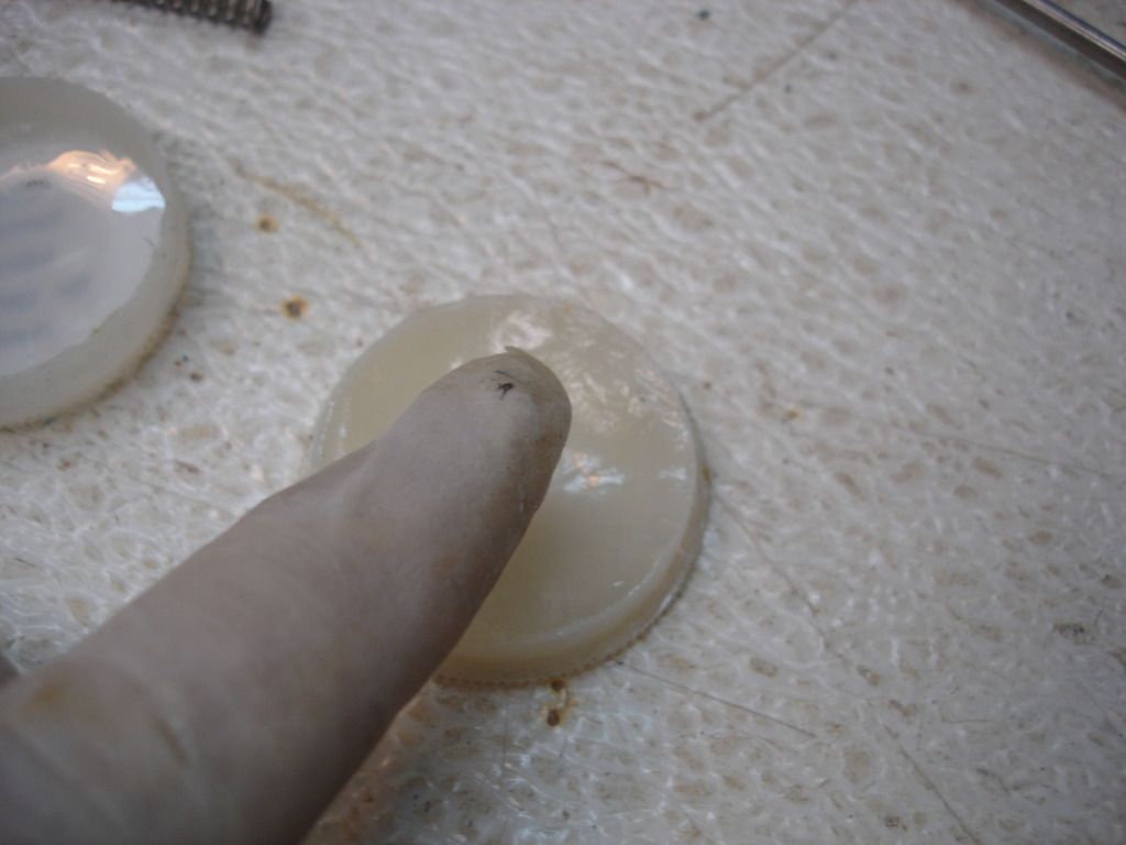

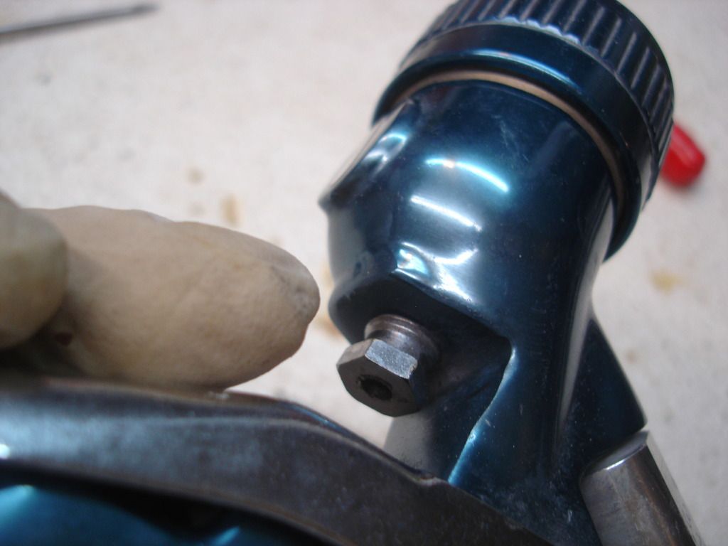

Now, if the needle is going to regulate paint...it must have a seal at the back. This little screw nut shown retains a cork seal, or "packing". If you get any paint leakage out of this packing, you can slightly tighten this nut to seal the leak. If tightened too much, the packing will lock down on the needle, so the needle will not easily move back and forth.
Although the packing adjustment is critical, it rarely has to be adjusted. I have adjusted mine once in 5 years.

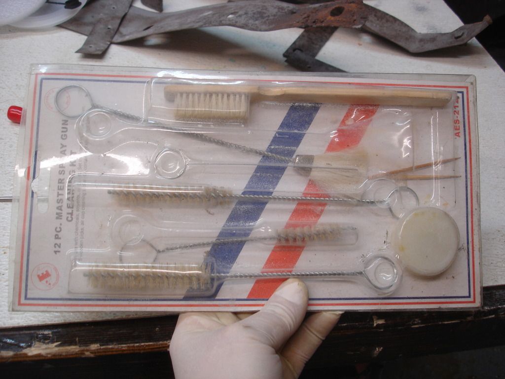

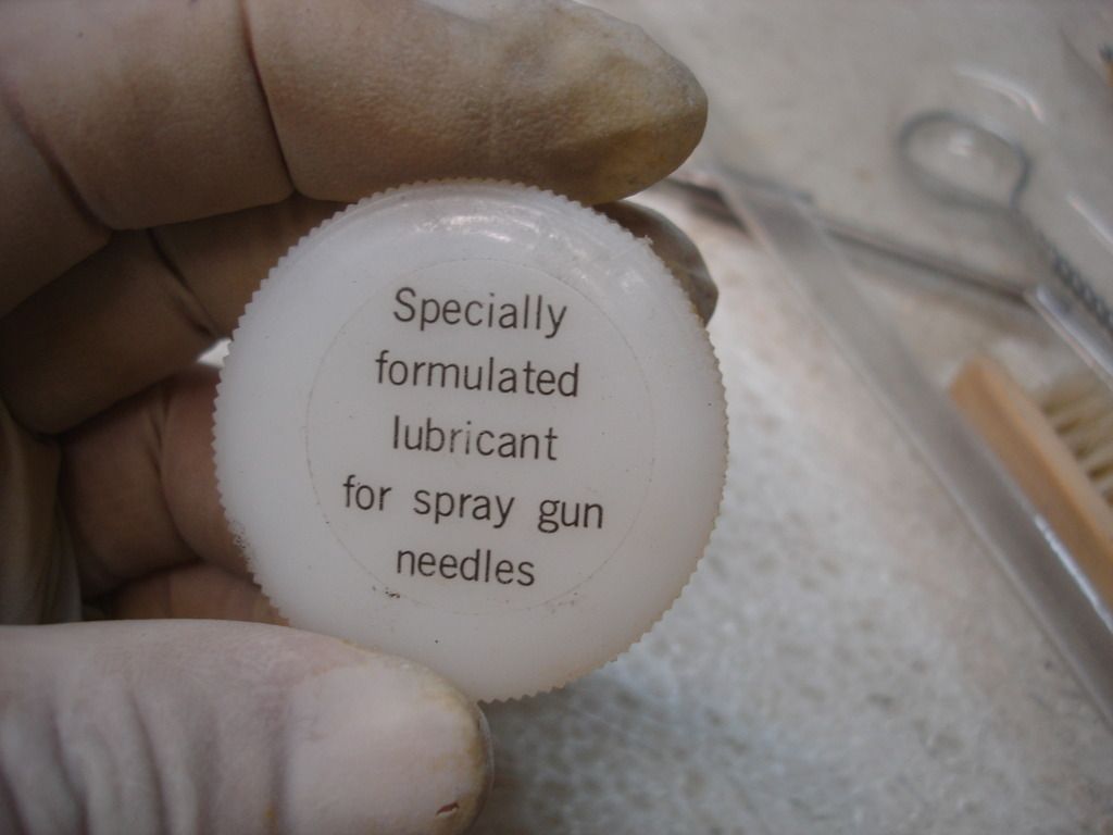

For about $12 you can get a gun cleaning kit. When you fork out the bucks for decent gun, it's worth getting the kit to clean it easily.

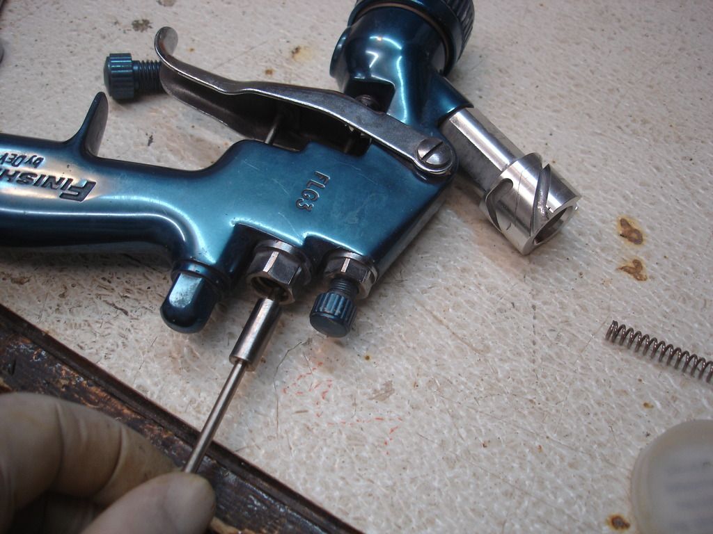

This is a lubricant that comes with the cleaning kit. Remember the paint needle must slide through the rear packing seal easily. Every time you clean the needle, use just a wipe of this lube to keep the needle moving freely. Just a smear is all it needs. You do not want to use anything with petroleum or silicone to lube.

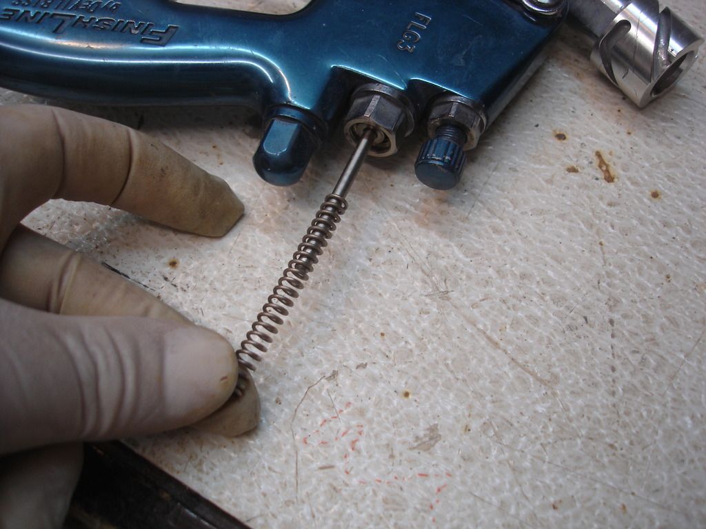

Once clean, the needle gently slides back in from the rear of the gun.
Spring next...
And paint control nut last.
I usually leave the nut as loose as it will go to unload the spring if the gun will be sitting for a long time. Immediately before spraying, you tighten the nut completely in. Always start with the paint control fully closed and spray pattern control off. This is because every job envolves paint with a slightly different paint viscosity, and therefore a slightly different setting for flow and fan.
