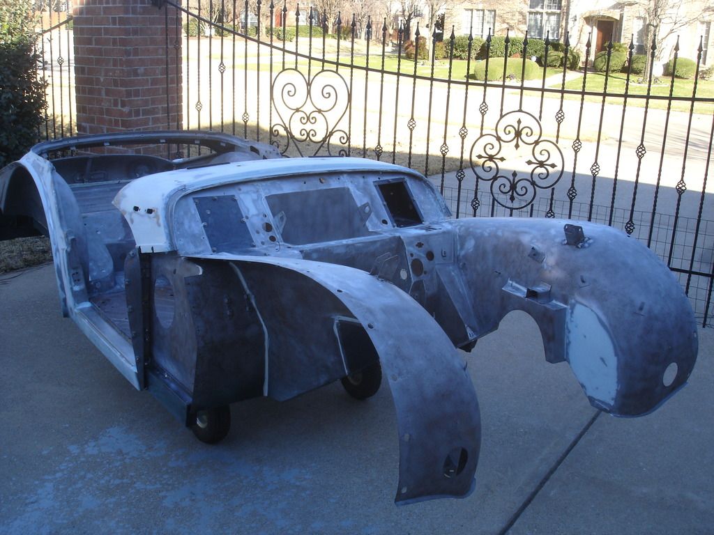

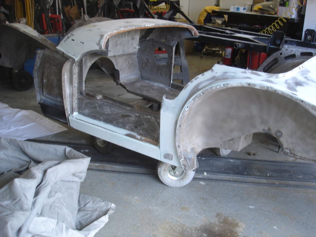

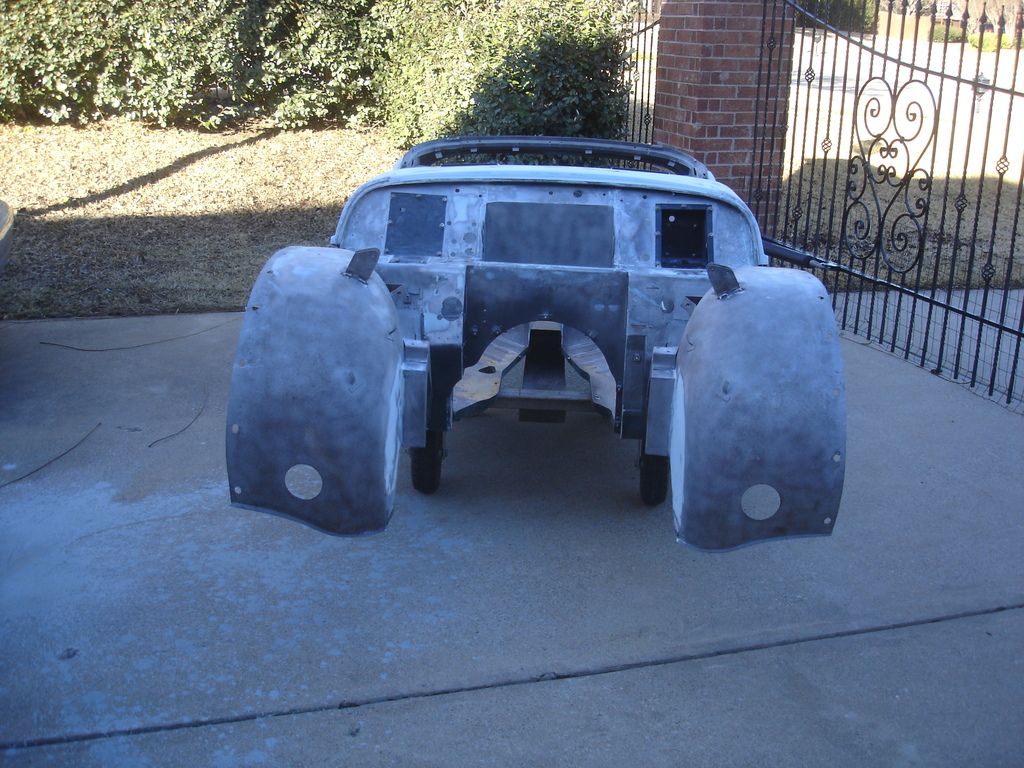

Here is the tub, once again completely stripped to the bone. I had naively thought I would pop the panels off and be ready to spray the tub the next day. That was beyond naive! There are more little corners that need finishing once the panels come off than I recalled. I also forgot that I had not completed the underside welds. Suffice to say it took most of the last 2 weeks to get the tub ready to spray. As of tonight it is ready...but the wind is ripping at 40 mph. Spraying will have to wait for a decent day that I am also off. Could be tomorrow...could be next month. I'll cross my fingers.
I actually sprayed the bottom of the tub earlier this week. Unfortunately I got caught in the only 5 minutes that we got drizzle...all day! When it's not your day, it's truly not your day. The color got water spots, and there is nothing you can do for that but sand it smooth and spray again.

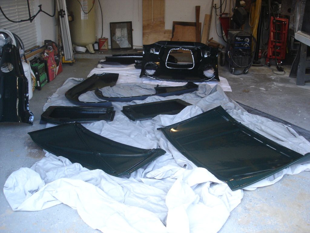

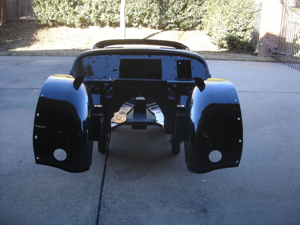

So, here are all the pretty body parts. After the setback trying to rush the black epoxy sealer, I had a successful day finishing them. They are all sprayed with black epoxy sealer/primer. Once the black was dry to the touch, I sprayed the dark grey urethane primer on the outer sides. I then finished up by spraying the inner sides with the single stage urethane color.

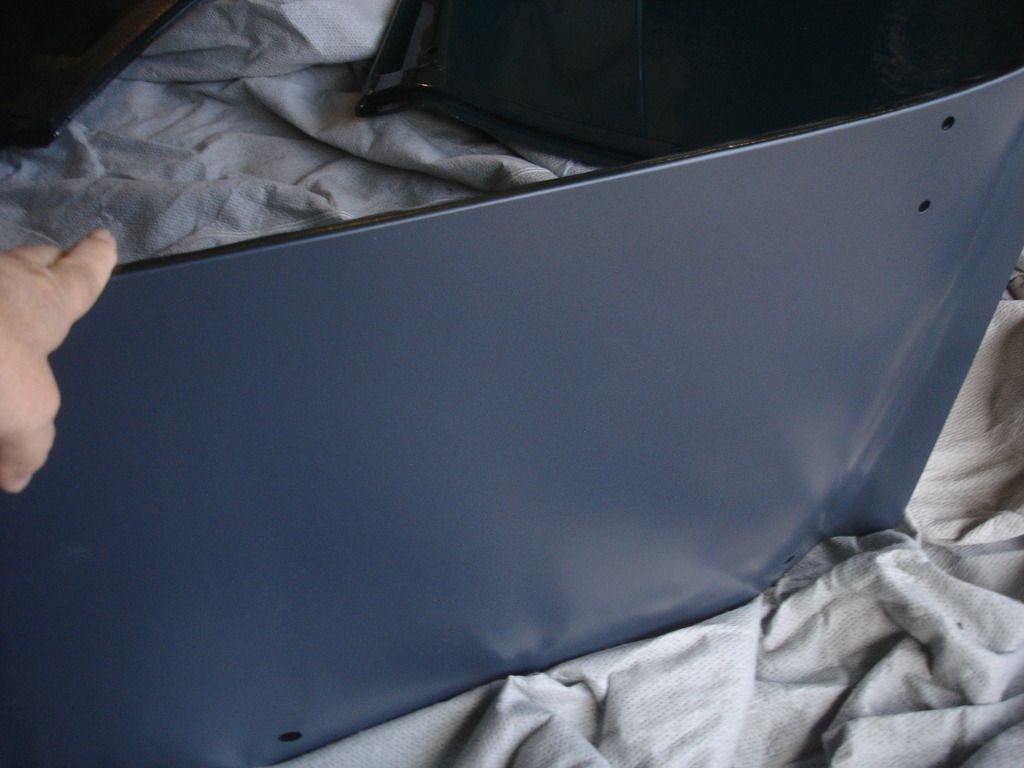

This is the boot lid, showing the dark grey urethane sanding primer on the top side.

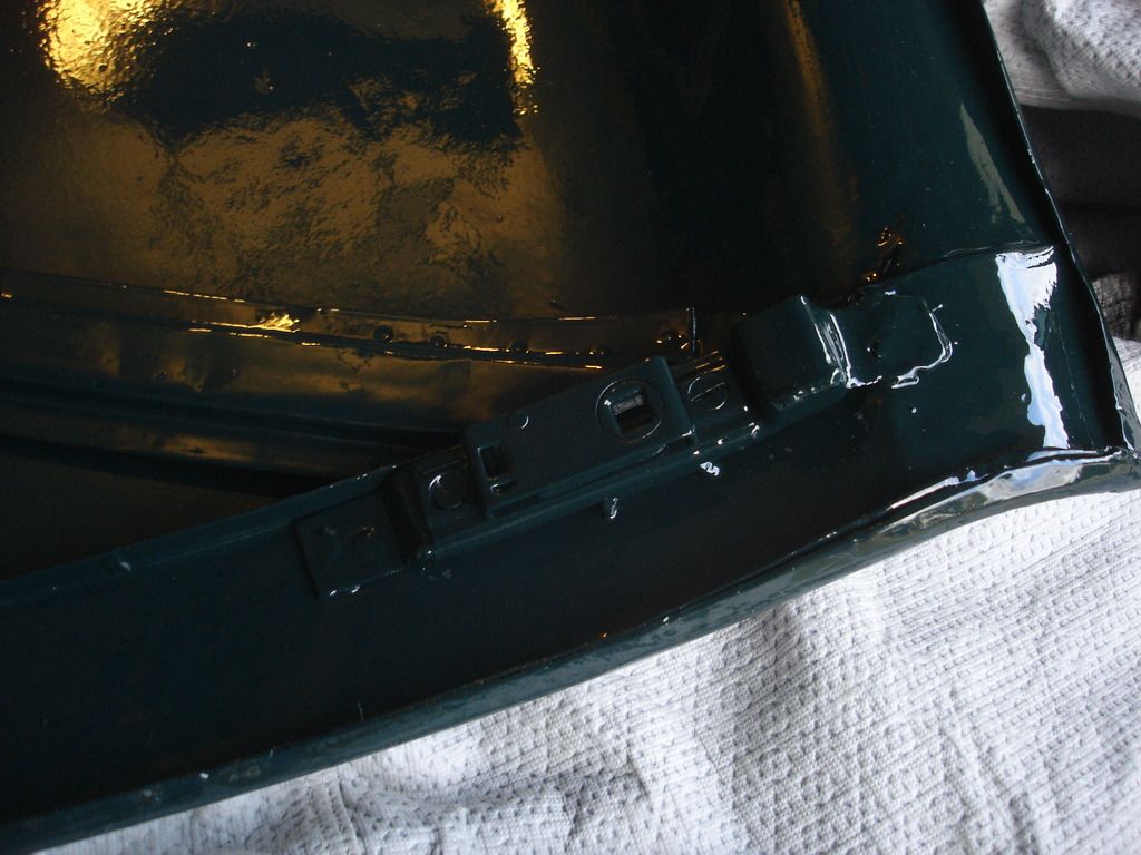

And here is the under side of the boot lid, showing the dark "Jag Racing Green". I'd rather a cool metalic or pearl...but Triumph colors are pretty limited. Even though this isn't technically a Triumph color...it's a valid argument that it "could be". And the wife approves...that's what really matters!?!
One thing to mention, so others don't forget...
Triumph assembled the latches on the boot lid and spare cover before painting. I primed the panels first, and then assembled the latches to the covers before spraying the color. This pic shows the result.

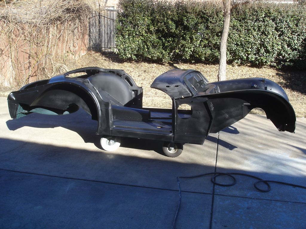

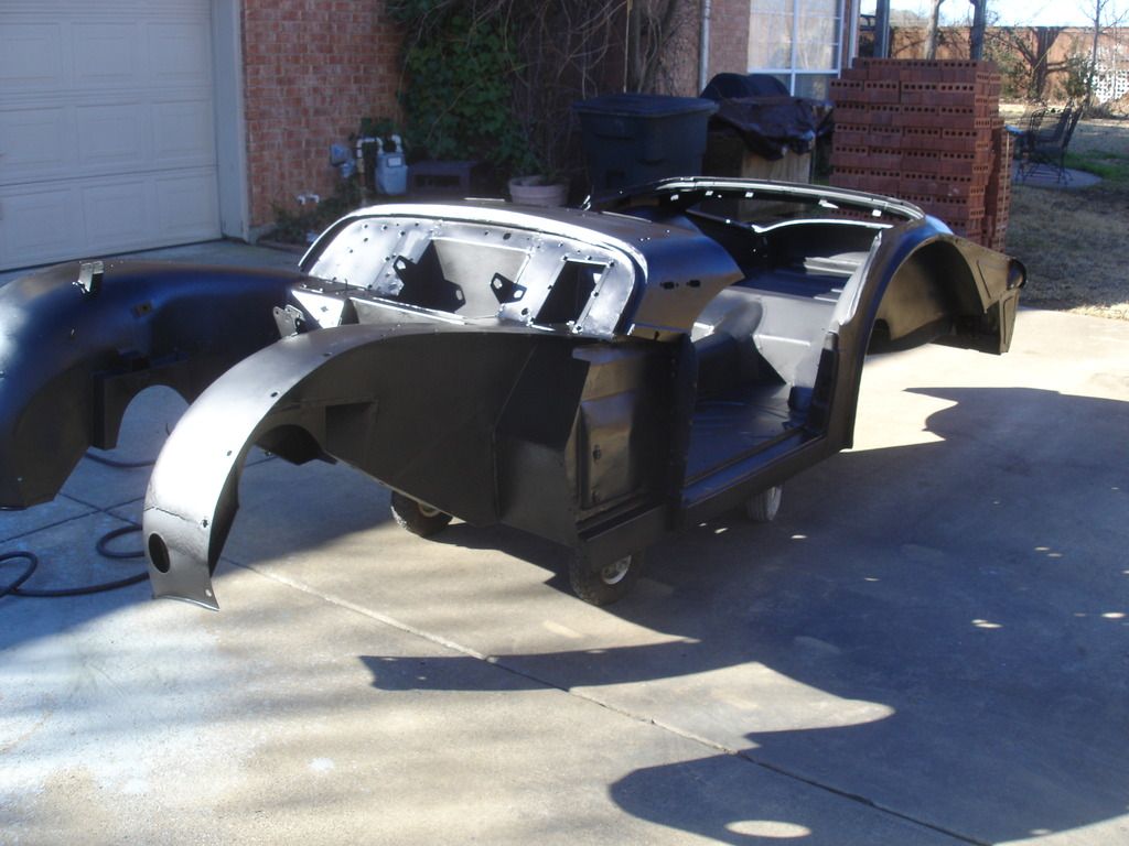

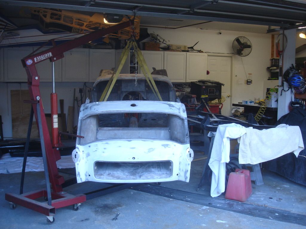

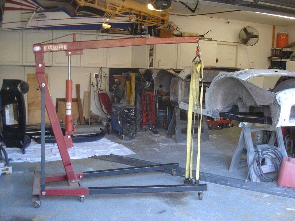

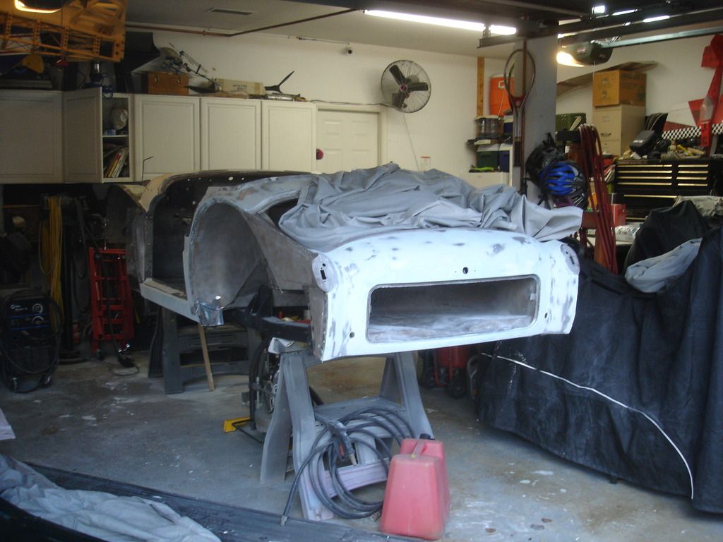

Now I started making trips to the storage shed. On each trip some panels went into storage (thus the diminished number in the background), and the lift came out and back. I was going to see if my son and I could lift the body off together. He was too busy, and I decided to do it "solo" once again. Notice the yellow body strap. I bough that 25 years ago to lift mid year Corvette bodies off frames. It has come in handy for a hundred projects since then.

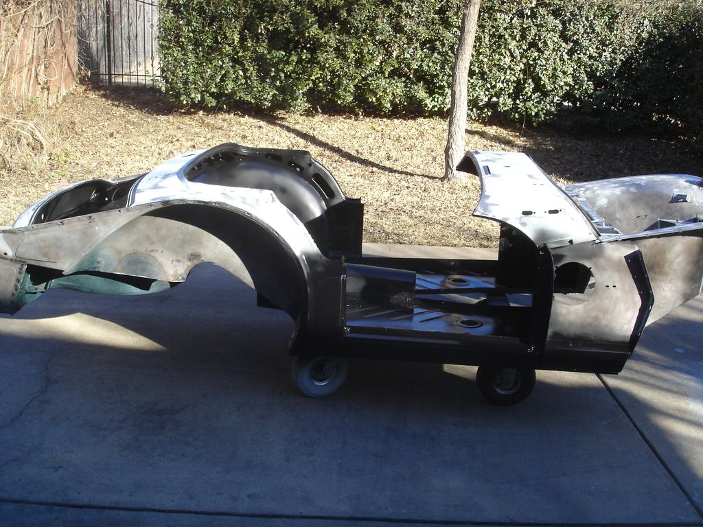

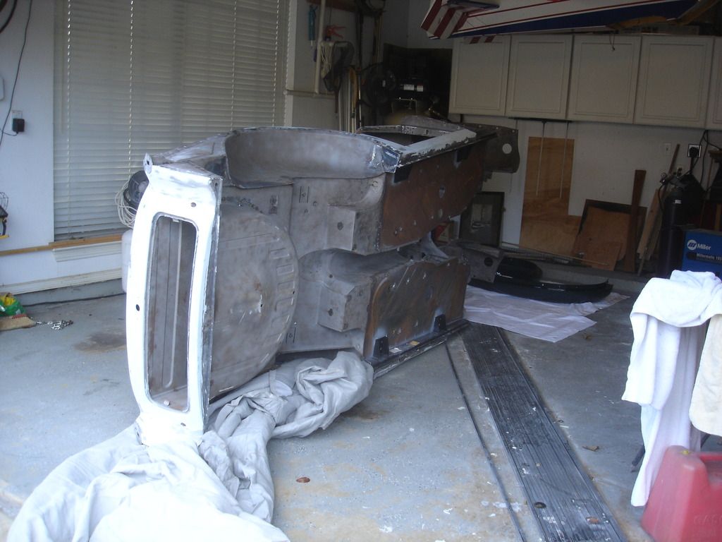

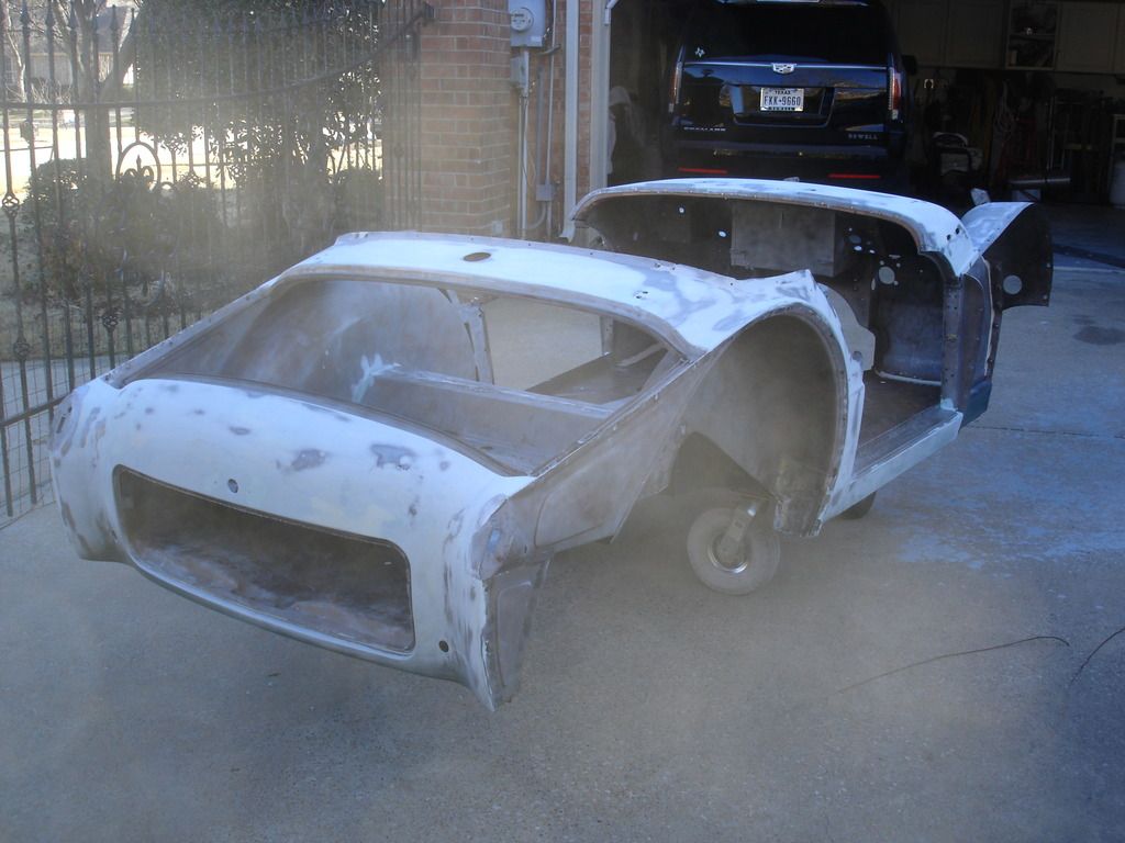

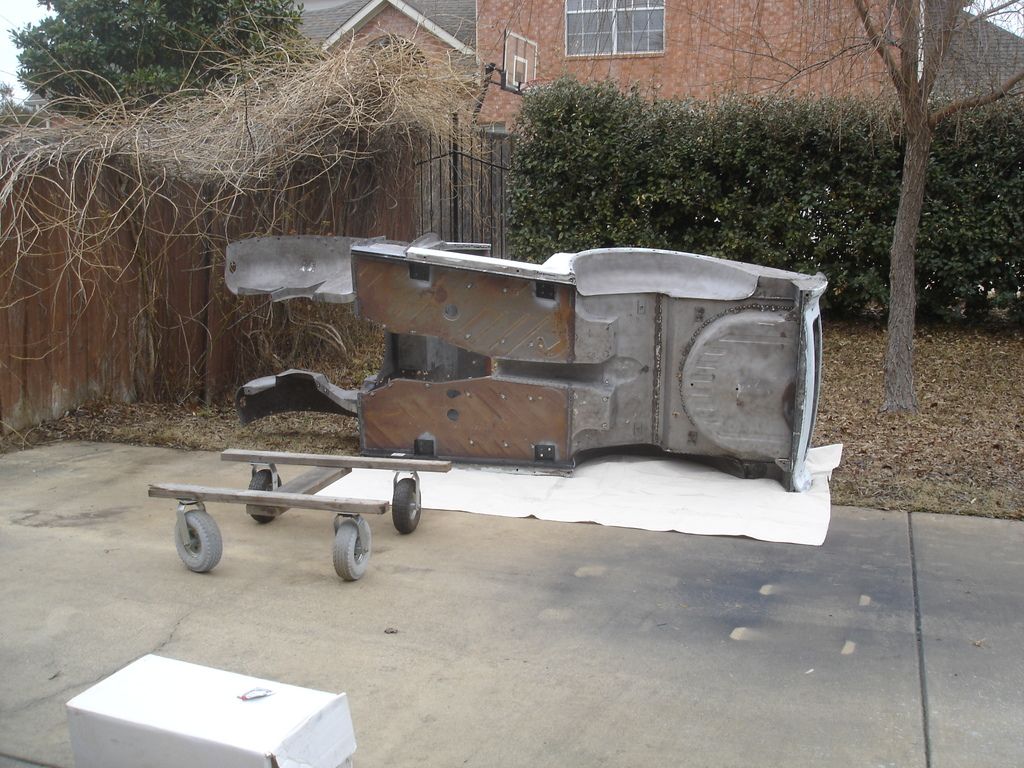

So, body out, down, and over. I know many will cringe at this. What can I say...without a real shop I gotta do what I gotta do to geet'er done.
Of course, this is when I noticed the missing welds under the floor.

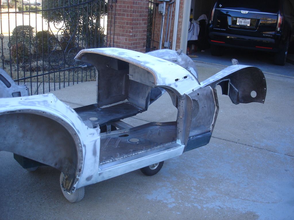

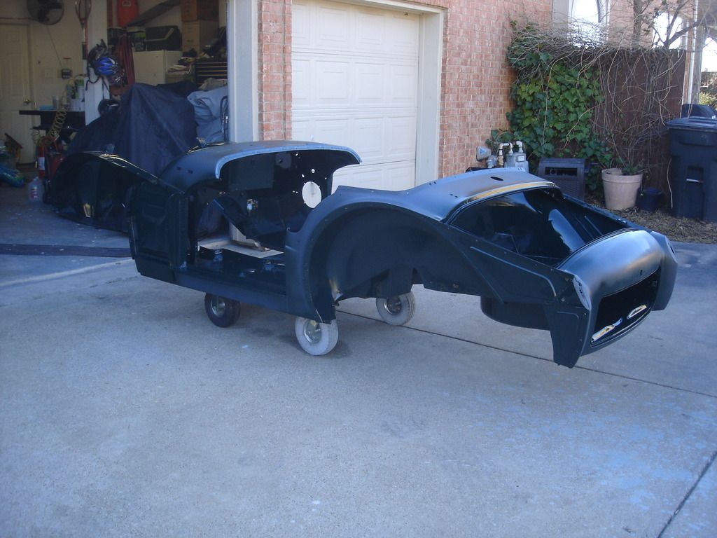

Here is the $30 dolly I built 5 years ago for the TR3A. Just 4 wheels from Northern...2 caster type and 2 not. The wood is scrap from the back yard pile. The ends fit nicely into the 4 mounting pads where the outriggers ride.
Now the body is on the dolly, and the frame will go back inside for a couple weeks.
Believe it or not, I got all the panels sprayed one afternoon. The next morning I got the panels stored and the tub pulled off the frame...and the frame put away. I even finished the welds on the body in short order. This is when I got cocky since everything was going so well. I figured I could spray the bottom of the tub, and this is the pic of my tilting it over to spray.
I then proceeded to get caught in the drizzle as I was spraying the finish coat.
Bummer. But, it happens.

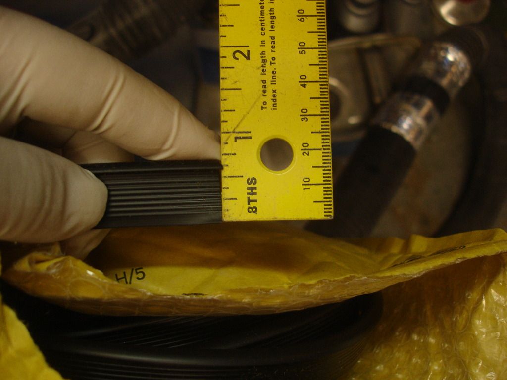

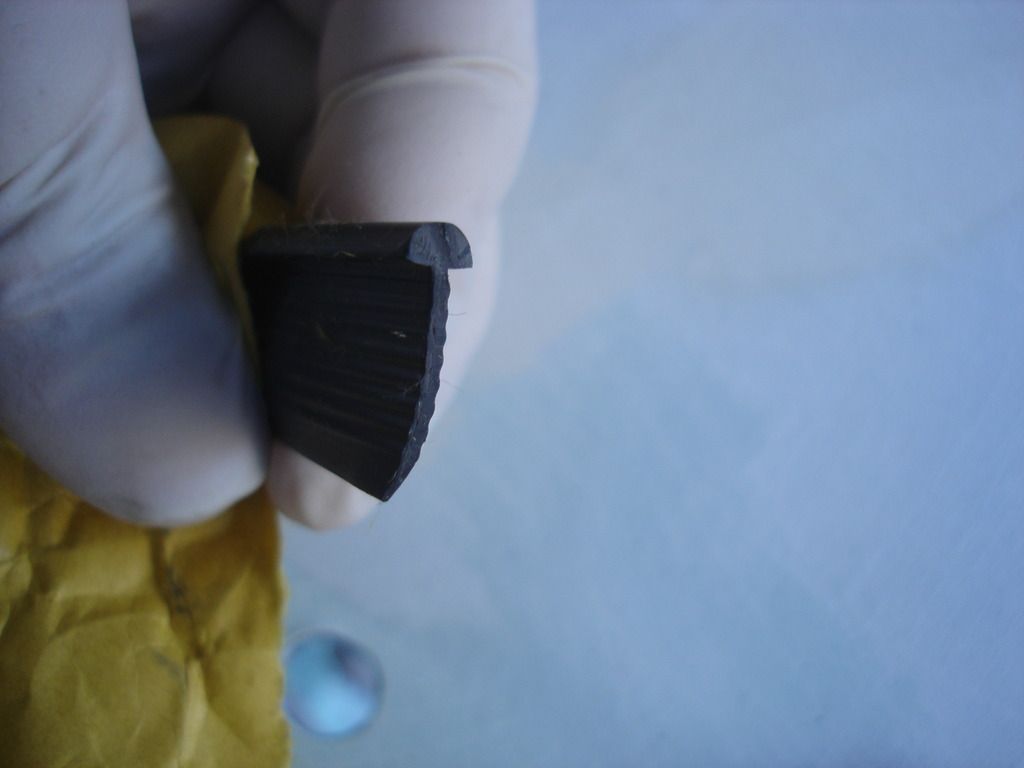

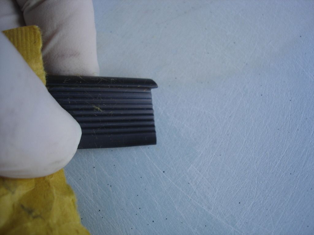

On a side note, the black beading came from Woolies in England. I will also re-post these picks on the beading thread. Not much to be said...it smells like vinyl, and seems to be just like the Moss version, except for the color. I have to cycle this into the paint rotation somehow.

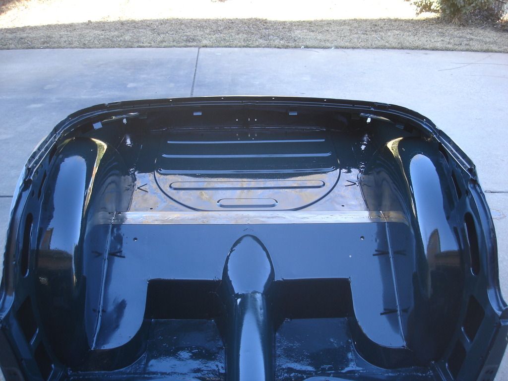

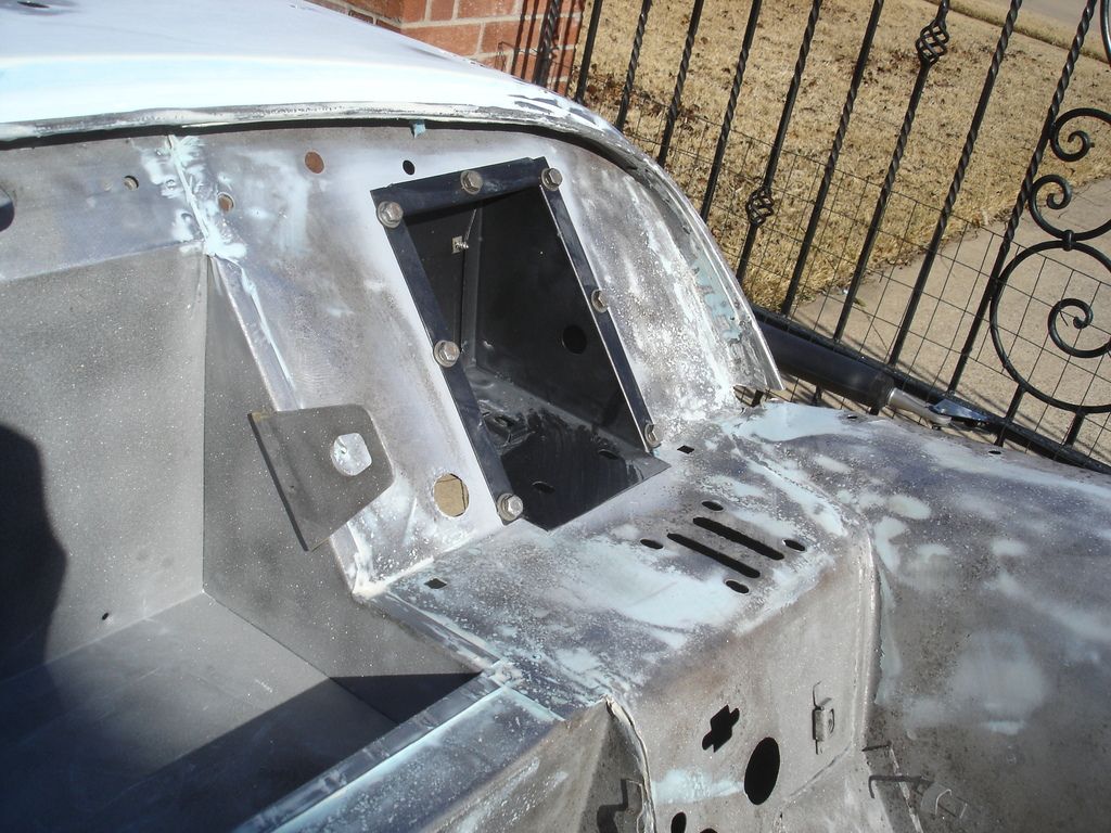

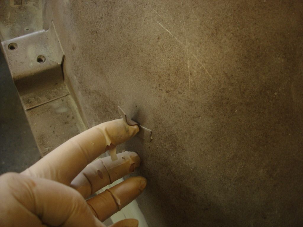

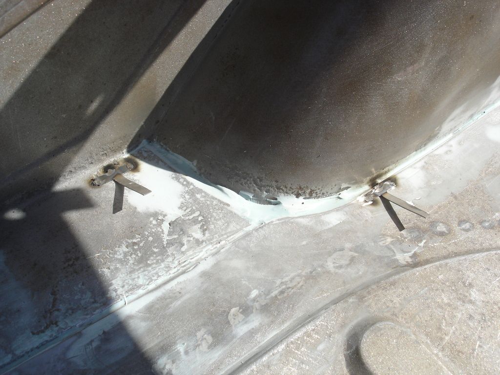

Now we move on to the crisis of the week. I was reading Tom's thread on replacing his boot floor...and OMG!...I realized I had forgotten all the wire loom tabs on the new floors!!
This oversight made it worth the fact I messed up spraying the tub. Because, welding the tabs in will burn the paint I sprayed anyway. In the end all worked out, but my hands are sore cutting 18 tabs!

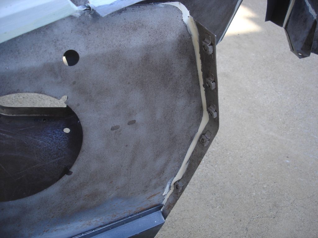

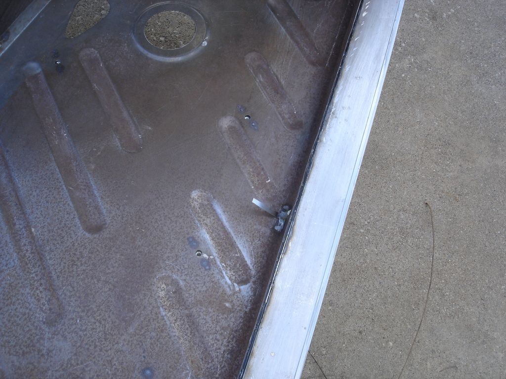

While I was making and welding the tabs, I took the time to turn up the tabs on the car, just enough to get paint under them. Standard didn't do this, so there is bare metal under every tab from the factory. By lifting them a bit, I can spray under, and then bend the ones that won't be used right back flat against the floors or bulkheads.

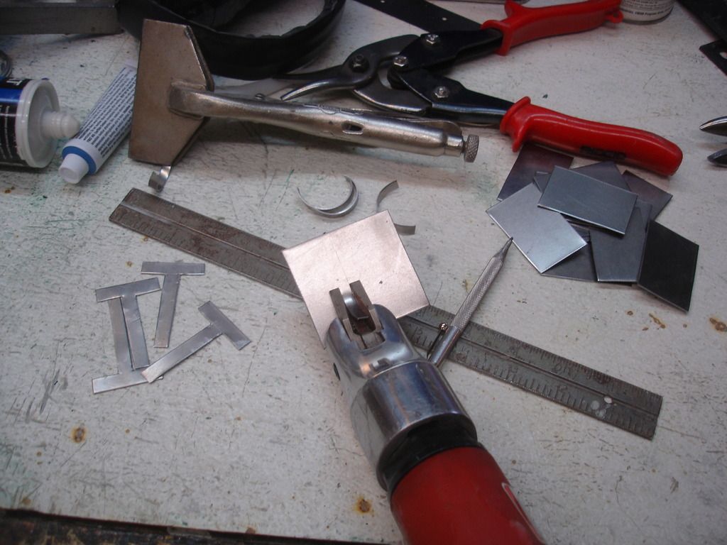

This is my wire tab production line. What a tedious job!

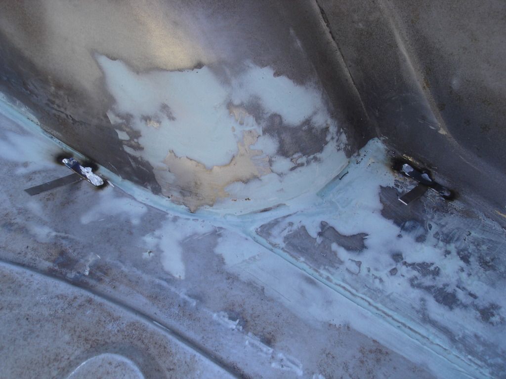

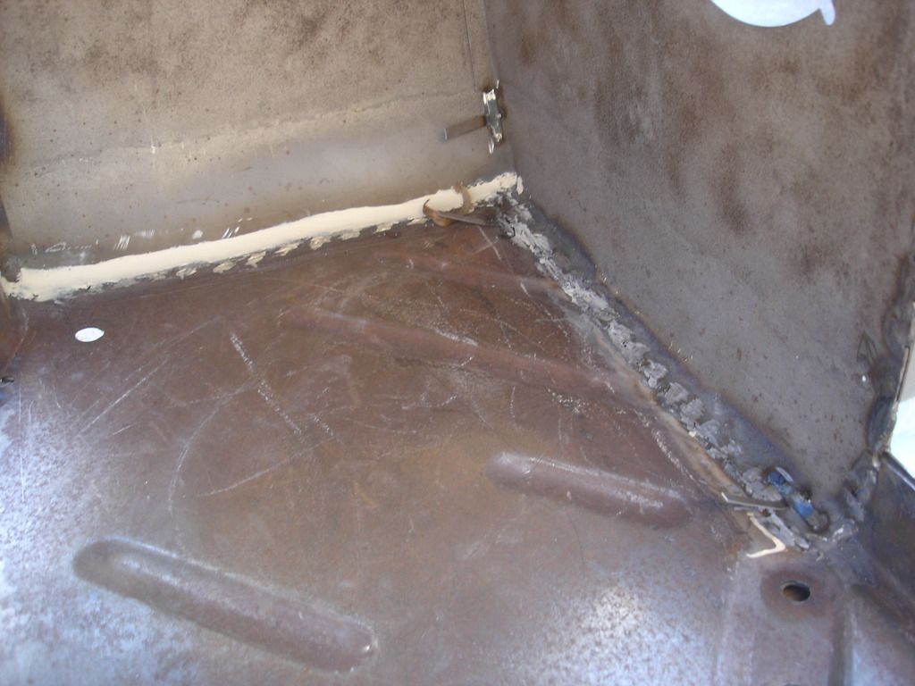

More pits...plus the wheel well repair I inherited.
Also notice I am using sealer along all the body panel seams. Last car I used a 3M body sealer. It hardened and cracked. That is NOT what you want in a sealer. It should remain flexible for the life of the car. Most cars in the 50's and 60's used that black, gooey, tar stuff that would stick to anything it touched. I think it was the basis for the McQueen movie "The Blob". I can no longer find that stuff.
This time I am trying a new sealer from Evercoat, the same company that makes the filler I am using. We'll see in a few years if I like it or not.

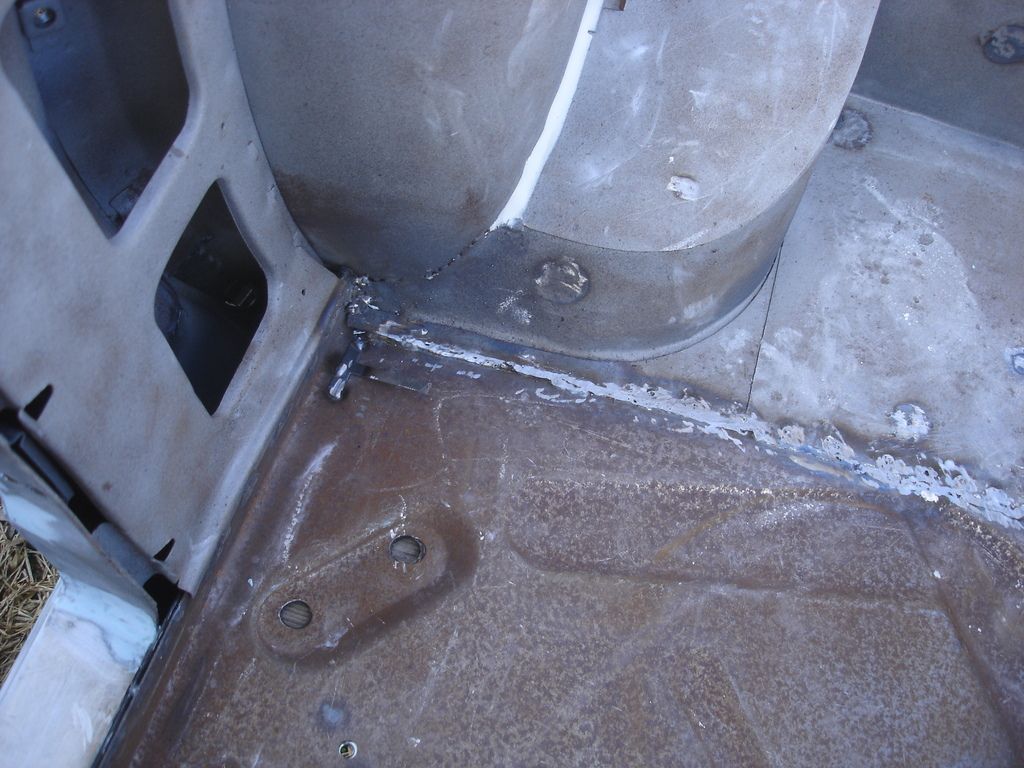

These are some shots of where the wire loom tabs go on a TR2. You can just make out 2 under the rear valence. There are actually 2 on the other side too.
The boot floor on the sides get 2 more each. I placed these off the original tub. I had to study it for an hour to even see the remains of the tabs, since it was so rusted out.
Moving forward, there are 2 on the sloped panel behind each seat (not shown). Here is shown the rear tab on each side of the floors.
Another tab each side about mid span of the door opening.
2 tabs on the forward floor...and notice there is one where I had to replace the metal on the front floor panel/firewall.
So, in all I had forgotten 18 tabs. How's that for a last minute catch? I really owe Art a beer for bringing the tabs up in Tom's thread. If he hadn't, I'd be cussing up a storm when it came to install the wiring next spring!! He also sent me several pictures that I will try to repost, showing several of the tab locations.

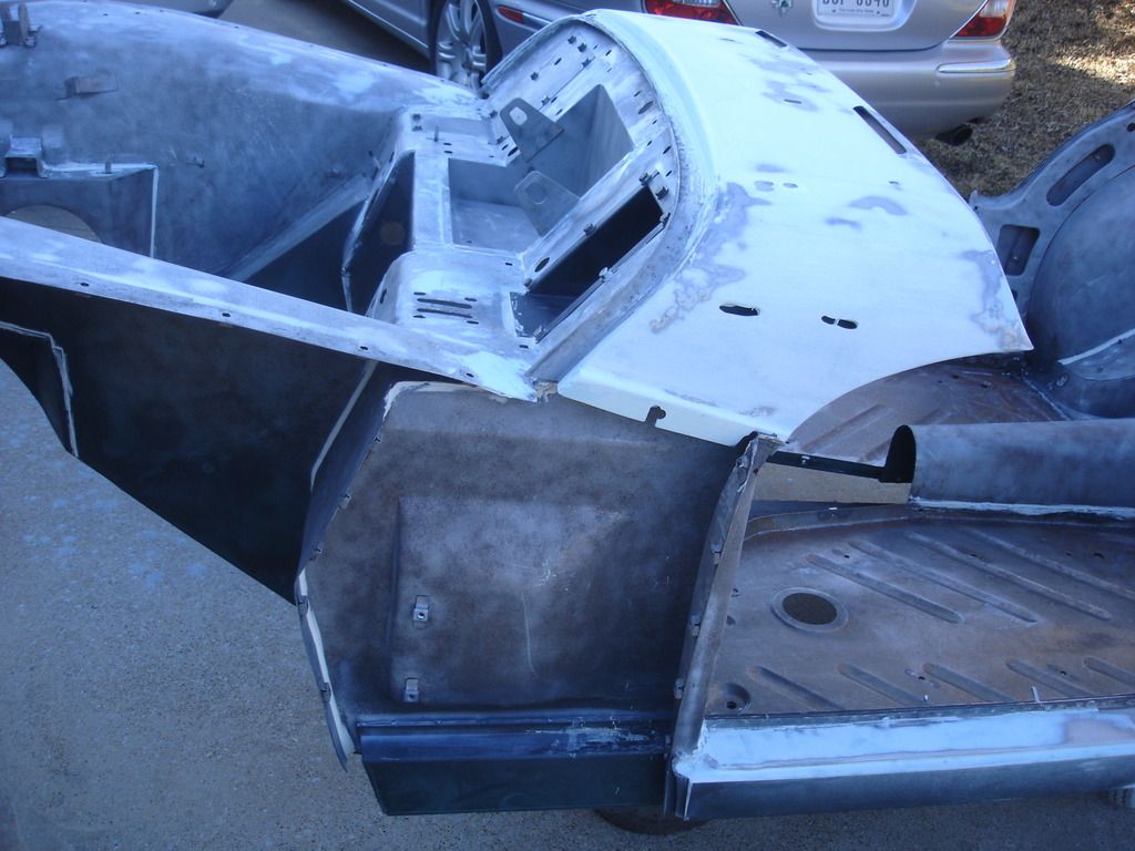

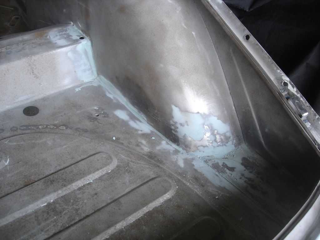

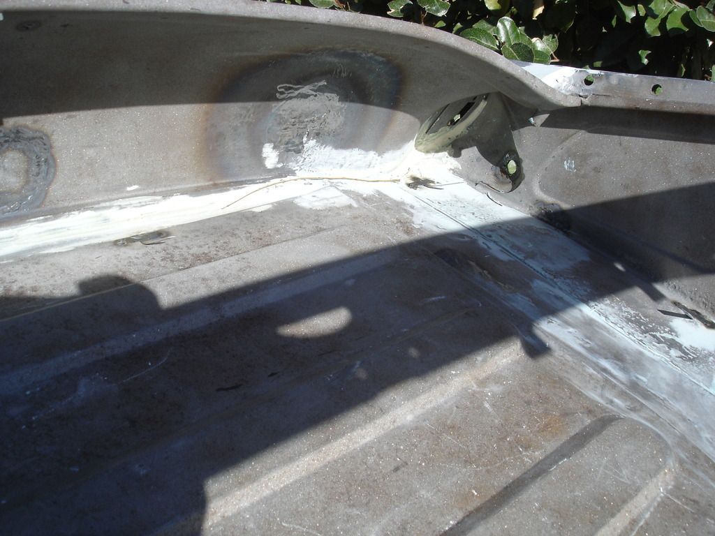

The following pics are close-ups of some areas that need to be addressed before paint. In this one, you can see that the battery box must be sealed, or it will leak on the interior tunnel cover. The judging manual states that the edges of the box may be glazed, but should be obvious. In other words, the edges must show, even though it would look better to cover them right over !
I also sealed the bottom of the brake box on the driver's side. If the master cylinder leaks, I do not want brake fluid all over the carpet.

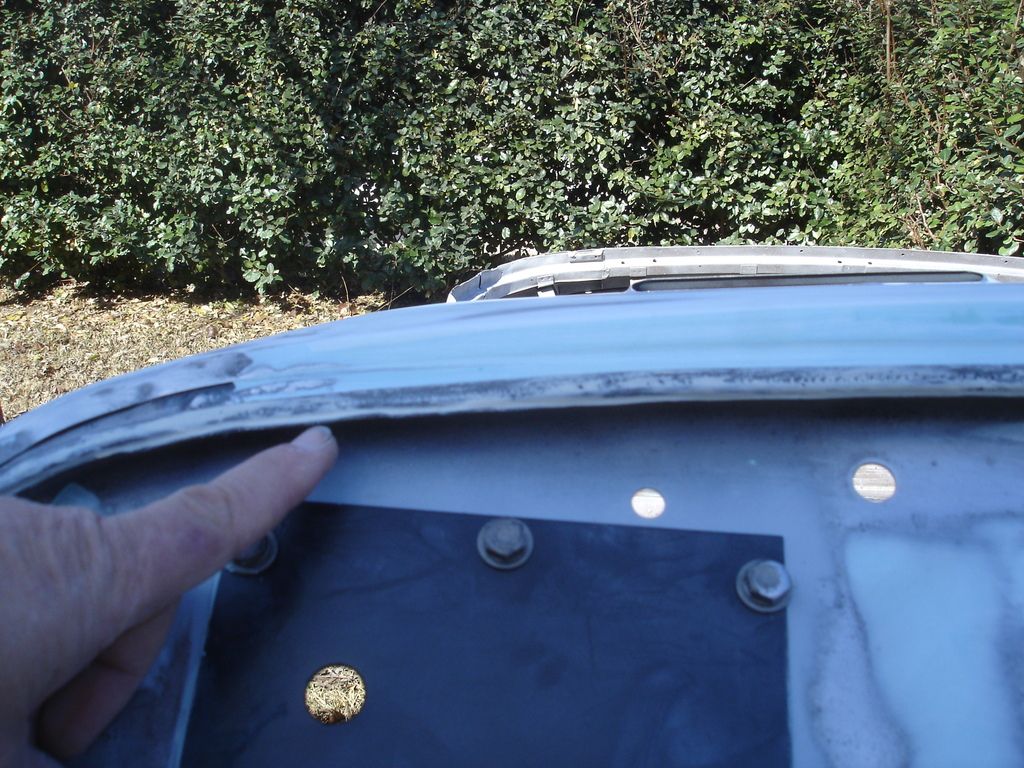

Standard was not big on sealing body panels. Originally, they only sealed a few, leaving many to trap moisture and then rust. I have sealed any panel joints that I think would leak into the cockpit if not sealed.
Here is one that is easy to miss...where the scuttle drip rail meets the firewall stamping. the TR2 bonnet has no drip lip on the bonnet rear edge, so water will drip down onto the firewall. If these seems are open, water can come right inside and down the carpeted footwell.

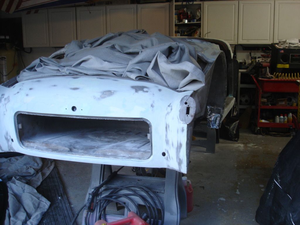

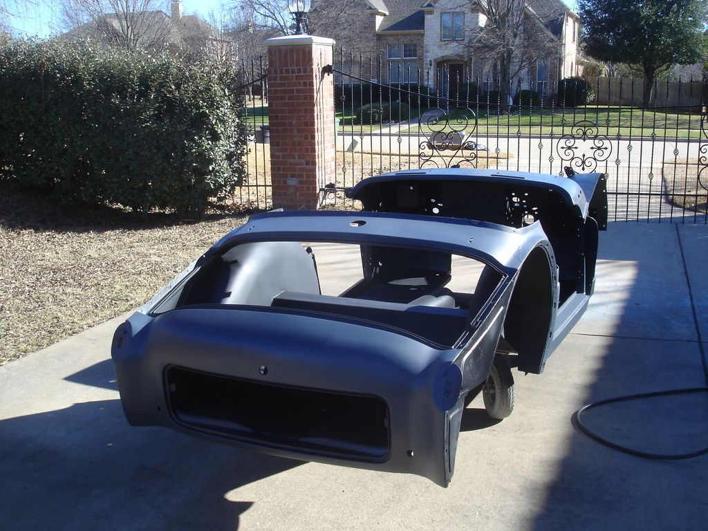

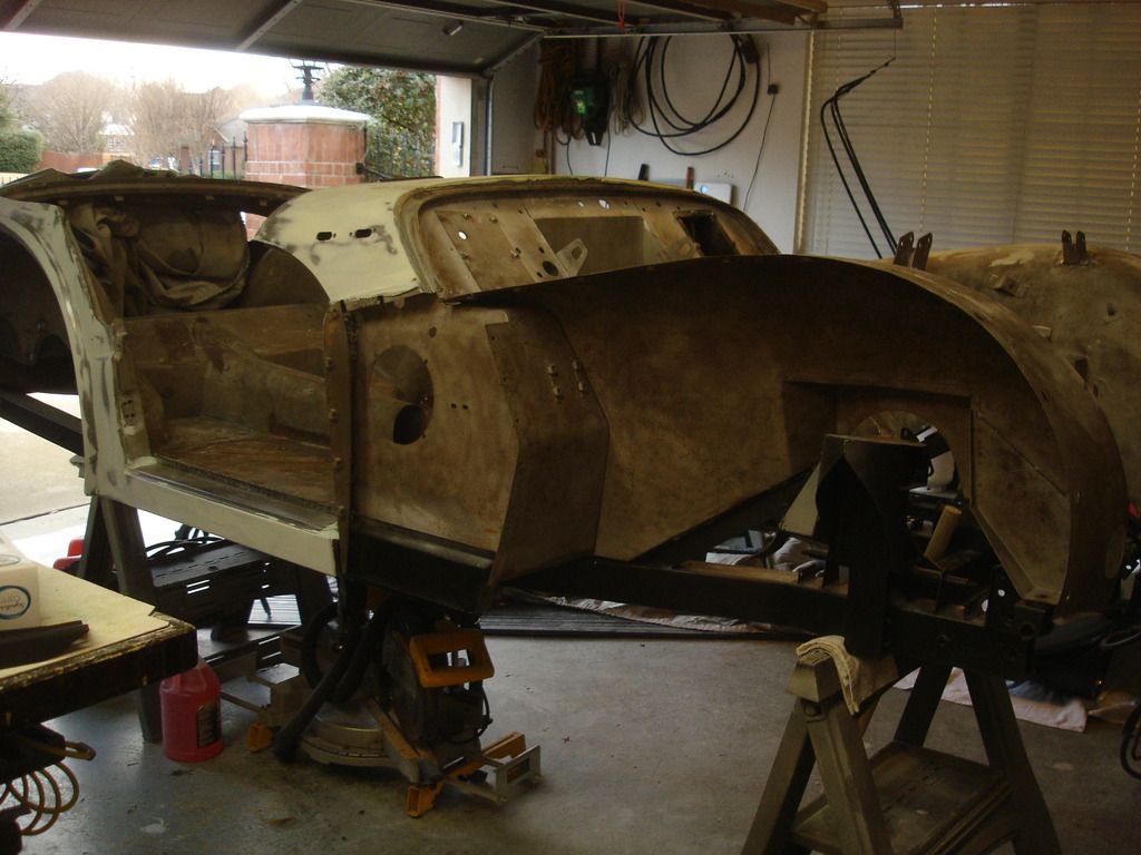

These pics are the final walk around after prepping the tub. I forgot to show that I spent almost a day perfecting the seems where the outer sills meet the quarters and the front wing. Those are the little things that really make the car "pop", as they say on the house shows my wife watches.

It looks like you are lifting the tub from the frame mounting points. I have made a frame that lifts from the bonnet hinge holes and the body in front of the rear wheel well with a bar between them.
I found transitioning the tub from vertical to horizontal to be tricky doing it solo. Have a similar rolling dolly, longer than yours and it has supports to rest the tub against.

I have a sheer that will make the wiring tabs a simple job. It is a 90 degree sheer that I bought from work when they were closing up some areas.

Hey David...I'd love to have an angle sheer! It would have saved about an hour with snips. I'll update later this week, but all the painting is complete for now. The inside of the car and engine compartment is all painted with the final coat of single stage urethane. So, those areas are finish painted. The panels that face outward are only primed, and will stay that way for a couple months.

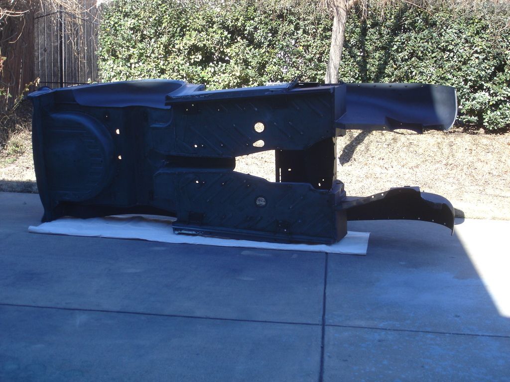

Week 70

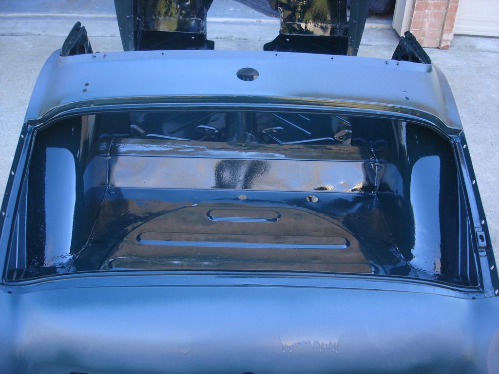

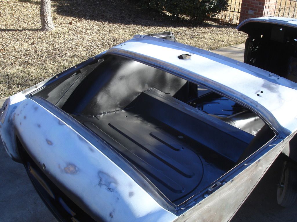

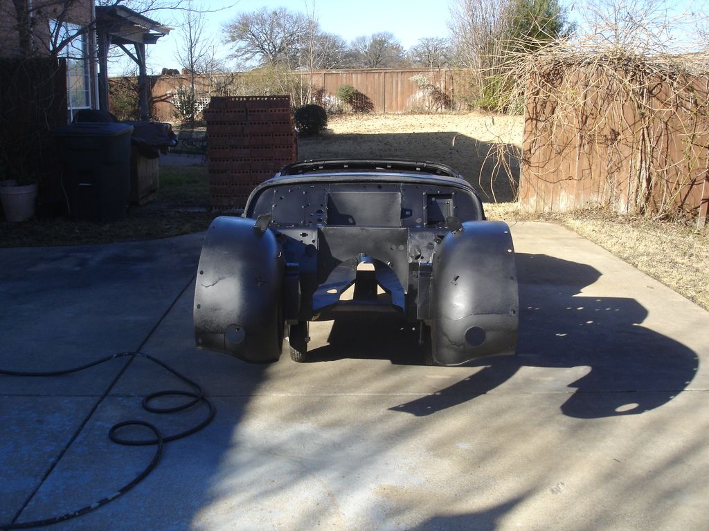

The painting is over for at least a couple months. Here is how the tub painting went:
Here is the tub after the first cup of paint. It's important to paint the tub from the INSIDE out. In other words, you have to paint the under dash, under rear scuttle, and under the rear valence BEFORE you paint the outside. If not, you will find yourself bumping hte already painted floors and outerwork. So, in this pic I have painted all the under sides, and I'm about to start working from the center drive tunnel outward from there.
And here is the second cup of paint later. This primer is merely the sealer for the metal and filler. As long as you paint over it within a week, it may be covered without sanding. So, by the time I cleaned the equipment, I layed the following coats right over this sealer/primer.

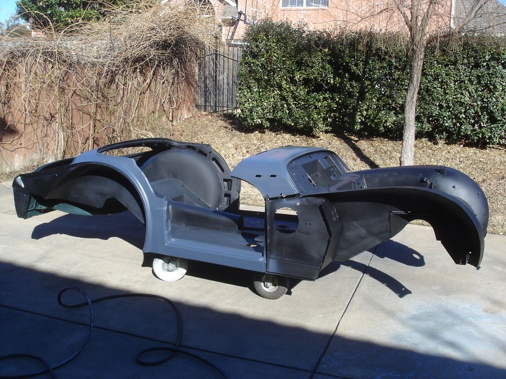

The next paint sprayed was the dark grey sanding urethane primer. This only went on the outer panels. Later, this will be wet sanded to arrive at the flat and smooth surface for the color coat. That will be at least a couple months from now. That amount of time will allow the polyester filler, epoxy sealer, and urethane primer to all cure completely. Then it will not shrink any more, which would change the surface of the final paint job.
A paint job can be done in a few days, and is all the time at the big paint shops. If at all possible, though, always allow your base primers to cure for several weeks/months. So not necessary with modern paints, but still an old school technique of creating a stable paint job that will last decades without shrinking, wrinkling, or cracking.
Now I have to re-spray the bottom. If you recall, last week I just started spraying the color on the bottom when I got caught in the drizzle. So it got spotted. Because color can only be sprayed on for the first 24 hours after it is sprayed, I had to rough the entire bottom with 400 grit paper. Here I have tilted the body and cleaned the sanding dust off. I had to wait 5 hours after spraying the primers, to make sure they were cured enough to not get damaged when I tilted the tub.

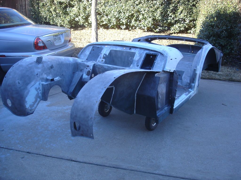

As soon as I sprayed the bottom, I rotated the tub back onto the dolly. The dolly only contacts the outrigger mounting pads, so it does not damage the paint as it continues to cure. I then sprayed the Jag Racing Green on all the panels EXCEPT those that will face outward when the car is assembled.
As you can see in the pics, the color is just what I was looking for. From some angles and lighting it appears solid black. Then, when you get a different angle with more lighting, it turns green. I wasn't so sure about it at first, but if I have to go with an original racing green...I like this one!
At this point my bodywork thread is going dead for a while. The tub will get parked in the living room of the house while I build up the chassis. I'll pick up in a few months when the body goes back together and the block wet sanding starts in preparation for the finish painting.
It's been a long road getting to this point. After the prep put in so far, the finish sanding and painting should happen fast once it starts!
