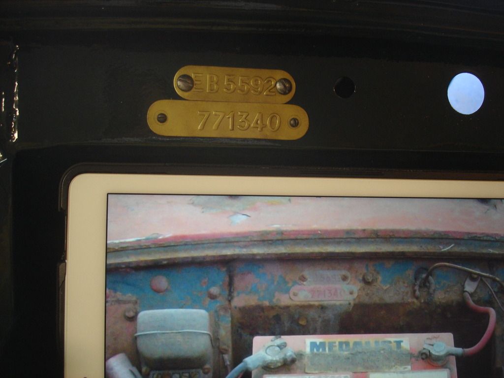

As with all big projects...some things get missed. I forgot the brass plates. The EB plate will have to be sprayed body color...rather "should have" been sprayed body color!?!

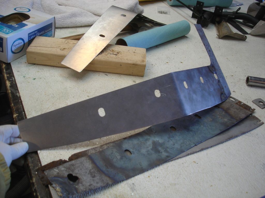

As I was clearing my bench these side sealing plates turned up. One was rusted beyond recognition, and the other was wadded up like a ball of aluminum foil. After a half hearted attempt to straighten the one...I decided it was easier to just fab them from scratch. I did re-use the upper pieces from the original seal plates.

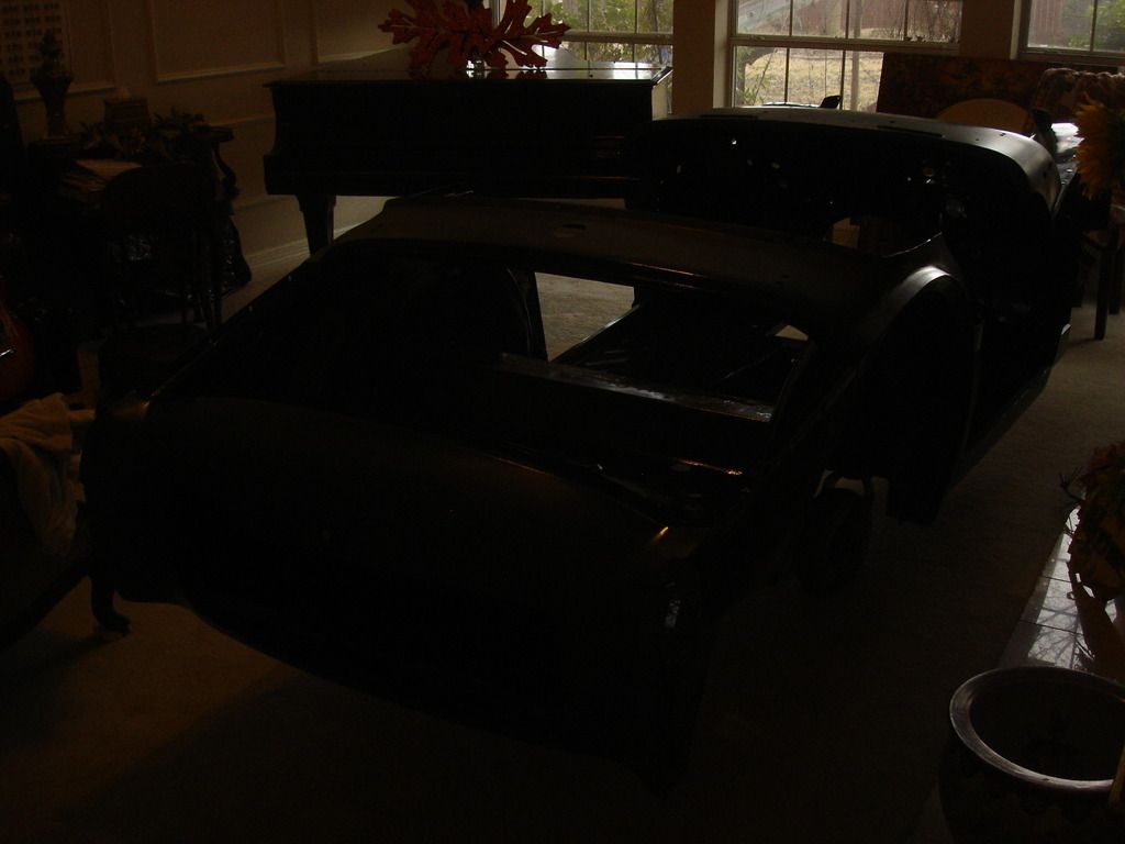

And...what everyone has been waiting for...
The Triumph in the living room!

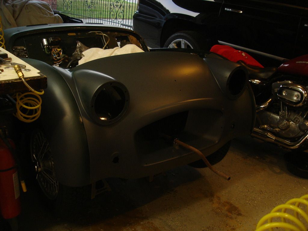

I am starting to re-mount the body panels again. This should be the last time, so long as I don't run into any snags.

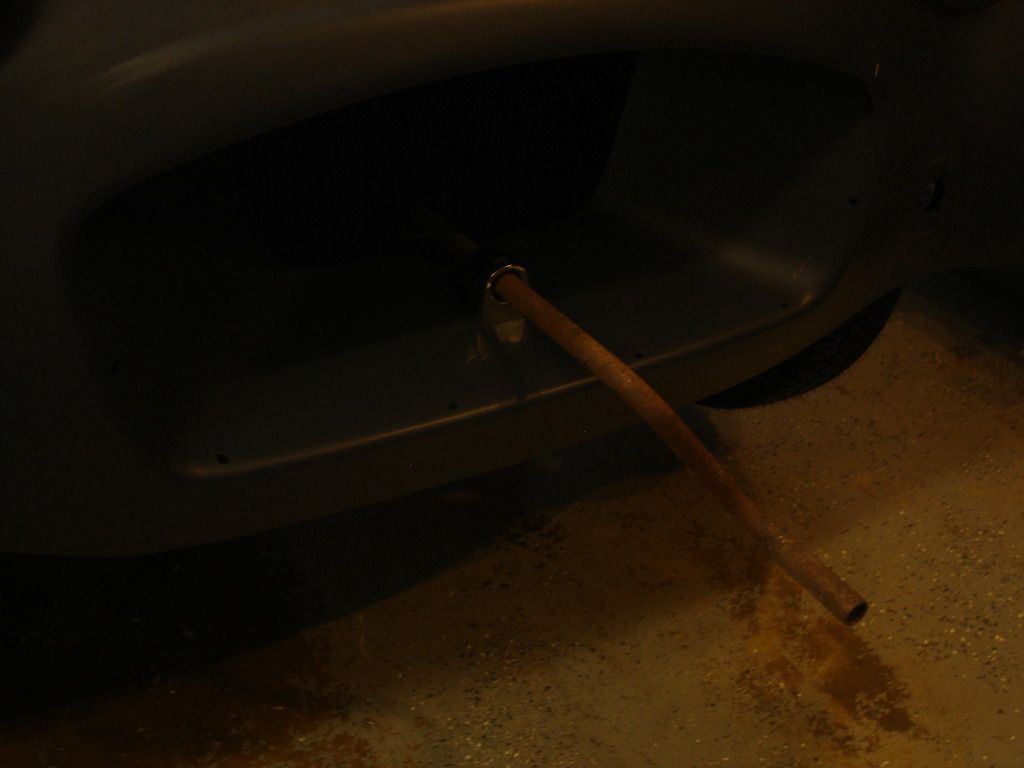

Here are some pics showing the front wings and front apron installed. One thing that I find amazing is that the rusty old crank is the original. Everything this car has gone through...the abuse and neglect...and the original crank was still in the boot!

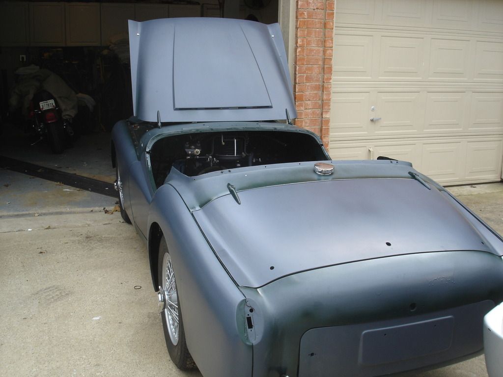

Well, I'm back, ready for the body work again. Let's show where I am at the moment...
Here she is...taking the first little trip out of the garage in over 4 years! The body panels are back on, although they are not cinched down yet. That will come after the final prepping, when the beading is installed. Let's take a quick walk around.

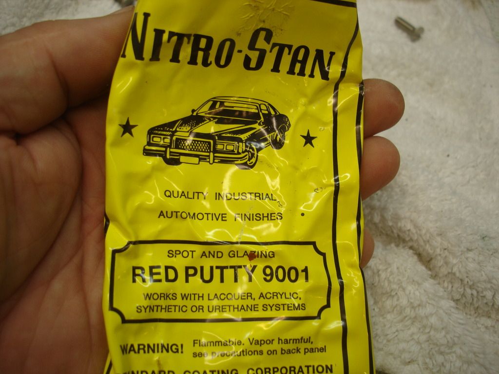

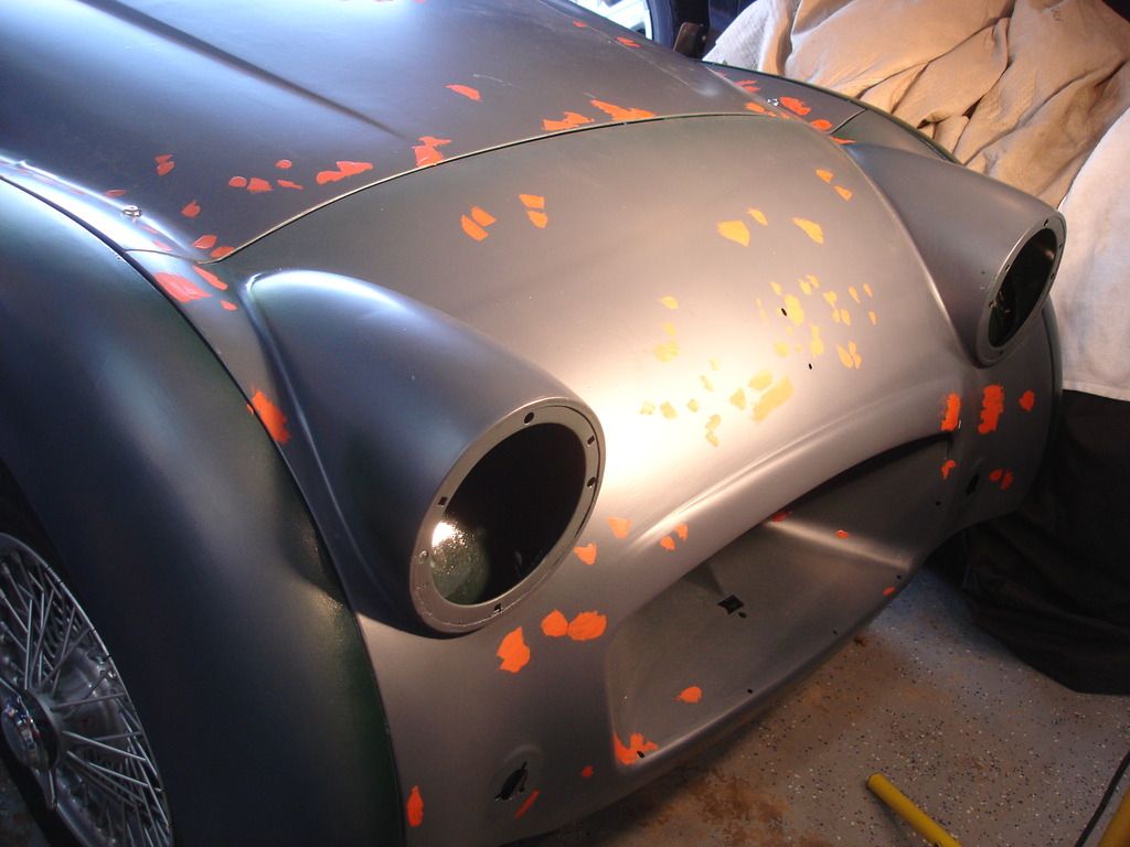

At this point there are a lot of little blemishes...and a ton of little pin-holes. We will start by filling the obvious flaws with a spot putty. This is the type I started using in Louisiana over 40 years ago. Every time I meet a new paint supply rep I ask what the best spot putty is...hoping that some new fangled super great stuff is available. They still unanimously recommend this! Hard to believe, but the old school putty is still the best going.
Things to remember about using this putty. First, it will actually soften ANY paint it it layed on, so it actually bonds to it. It WILL destroy good paint if you accidentally get it on a finished paint job, so beware. Secondly, it is a one part putty, so it does shrink. Put it plenty proud of the surface you are working on. Finally, allow overnight to harden. It will frustrate you to no end trying to sand it within a few hours of application. When dry it sands beautifully. When still soft it balls up and makes a mess.
Here is how to use it...
Use a small putty knife or squeegee. Anywhere you see a low spot...smear the putty over it. Any pin hole...smear it in. I will allow this to dry for a couple days...and then we'll get busy sanding.

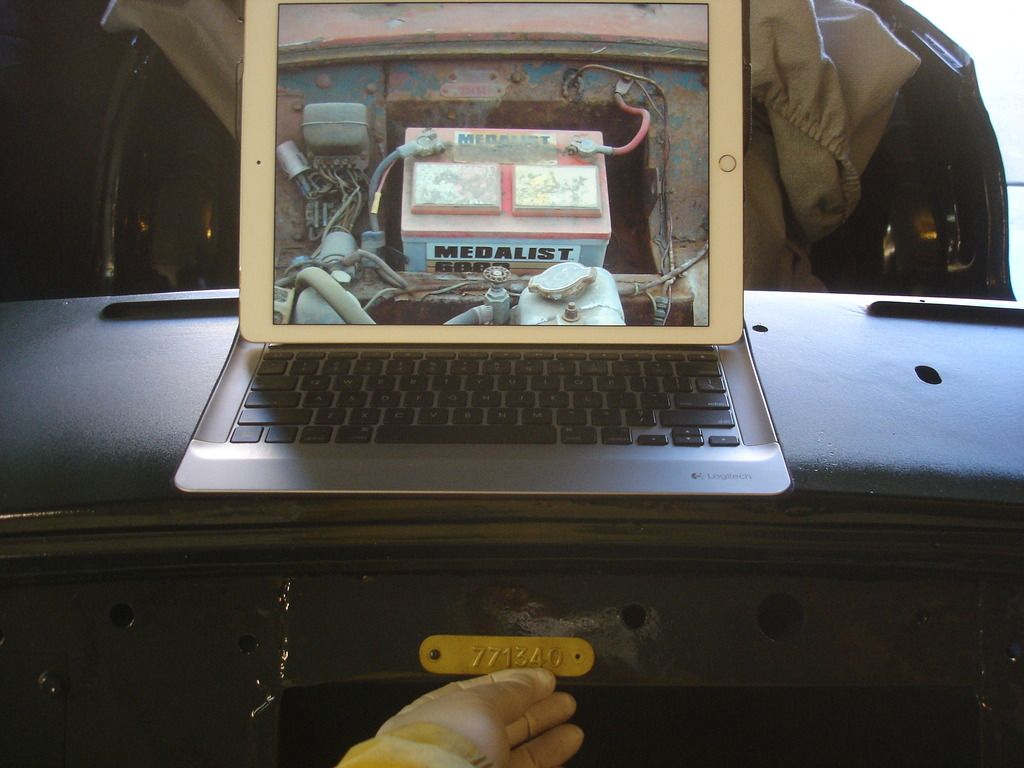

Great work, John. That eBay car would be a piece of cake after what you've done with yours. And if you're still looking for a transmission inspection plate, check the driver's seat in the seat picture. The head & carbs at least are not TR2.
Jeff
Thanks, Jeff. If it makes at least $5k, then I'm vindicated on what I paid for mine plus my parts car. If it goes lower then I could have done better?!? It looks like a better body than mine was...I bet the whole engine is newer, though.
