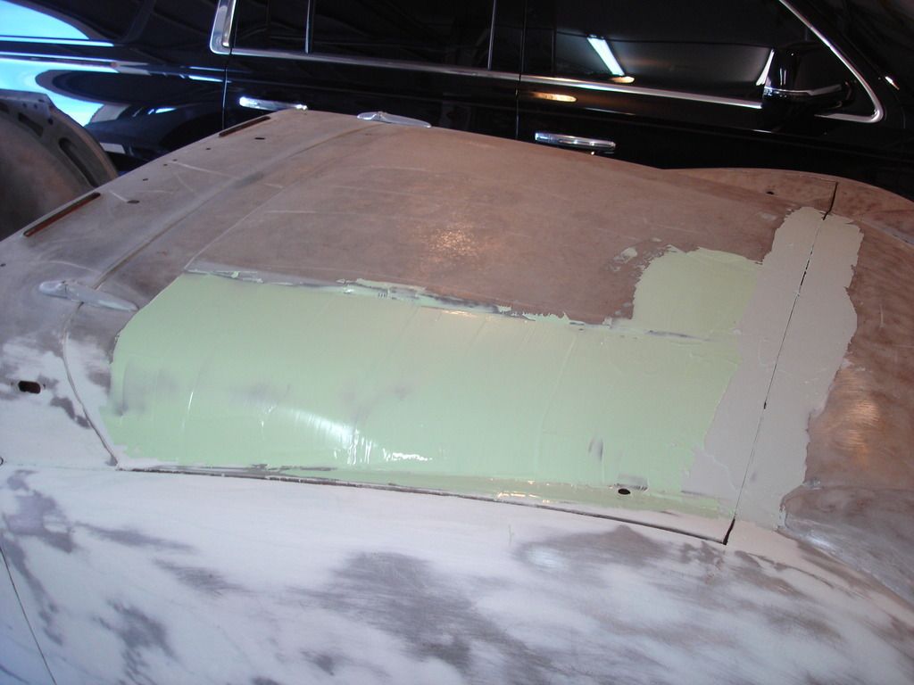

This week I have been (slowly) working my way around the body. The next up was the bonnet:

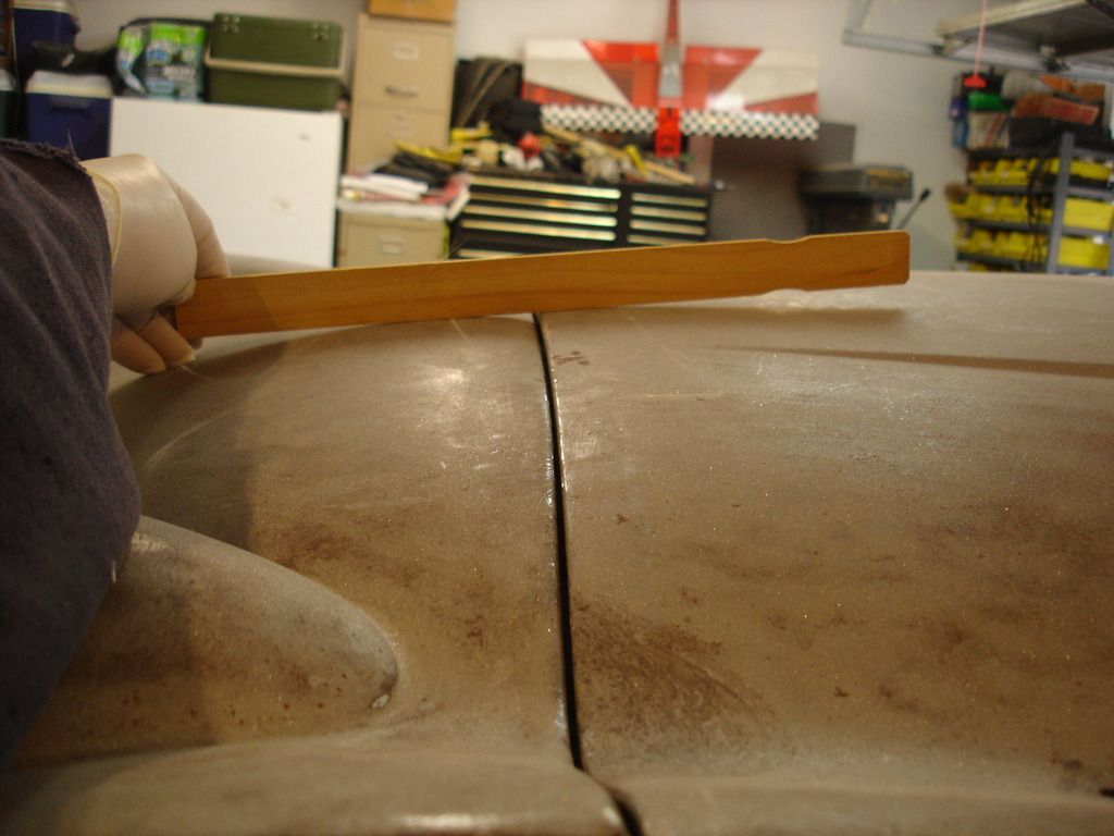

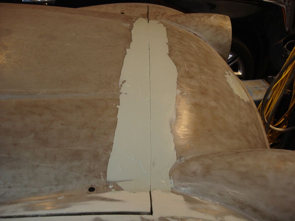

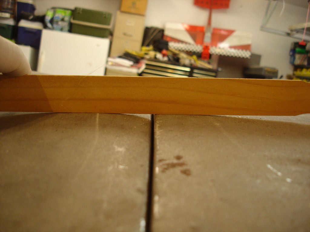

This shot shows the meeting line of the front apron and the bonnet. You will note that the gap is aligned, but the angle of the metal of each is not correct. This is very common, even with new cars, and the eye tends to overlook it. I should say "most" eyes! It bothers the heck out of me when I see it on finished cars. Anyway, you can probably guess that the bonnet cannot be altered without disrupting it's lines, so the adjustment must be applied to the apron. THEN, the apron has a flange welded to it, and opening that weld will also open a real Pandora's box of issues. This is the case where a bit of filler is at it's finest.
In the pic you can see that I could lower the bonnet, but then the "bump" on the apron will be higher than the bonnet line...and that would mean adding a foot or so of filler to the bonnet to fair the line back into shape. The lesson here is to always minimize any high spots. This applies to any bodywork. If you work a panel and leave a high spot, then you must fill the entire area around the high spot to fair it in. Whereas, if you work a panel and eliminate the highs, but leave low spots...then all you have to fill are the lows. That means MUCH less filler!
So, always err bodywork on the low side to minimize filler blend work later.

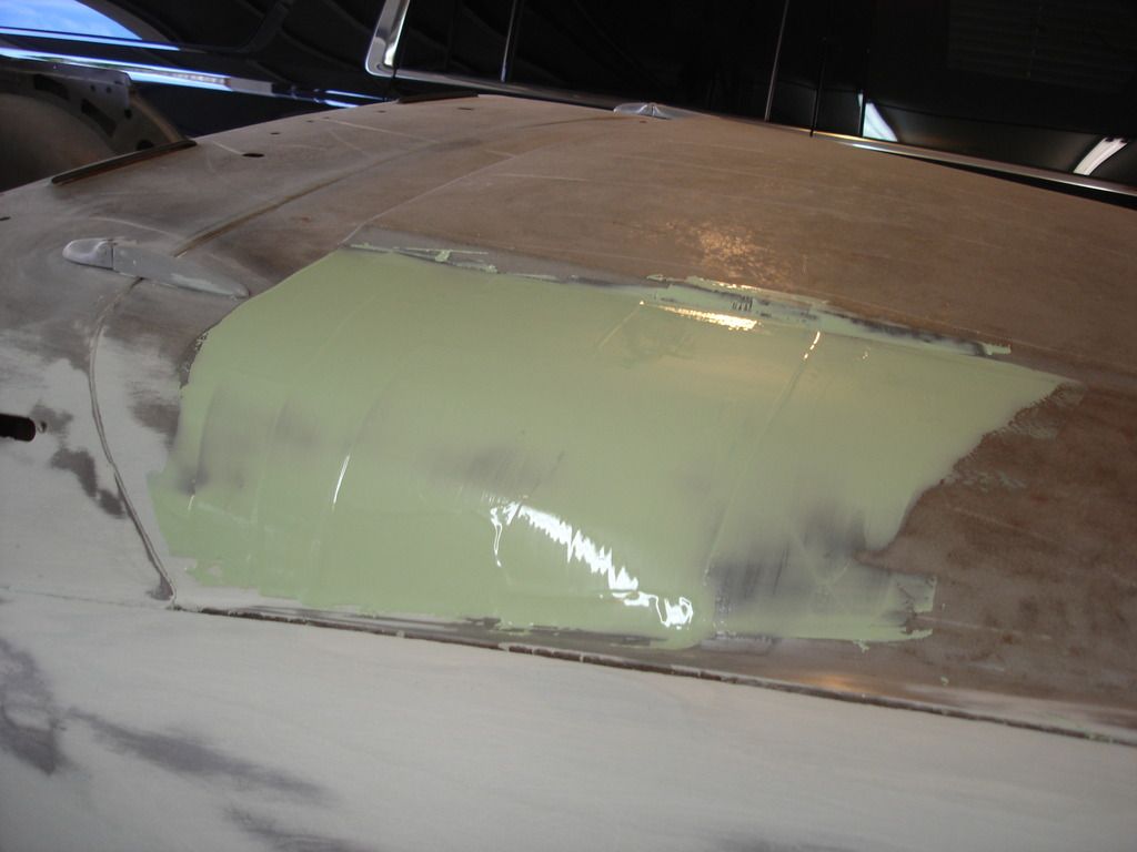

Here I am starting on the bonnet blending. Only mix filler in small batches, rather than trying to mix the entire bonnet in one. This is because the greater the amount of filler you mix, the higher the chemical heat generated. This reaches a point that I have started fires by mixing too much filler at one time. Important safety tip!! Even if you don't get that much heat, the extra heat generated reduces your working time for the batch to zero. You do not even have enough time to mix it before it lights off.
So, keep filler batches relatively small...like what you can spread in a minute or two.
If you remember from last year, I actually spent 2 full weeks bodyworking the bonnet, so it is pretty smooth. Because of that, and the fact the bonnet it horizontal and will not get sags or runs, I will use the glaze for the rest. of the work. I used filler for the bonnet to apron seam, since I needed more build in this area. I am now using the glaze to get a smooth, even, and thin spread across the bonnet.
This is about how much I mix in one batch.

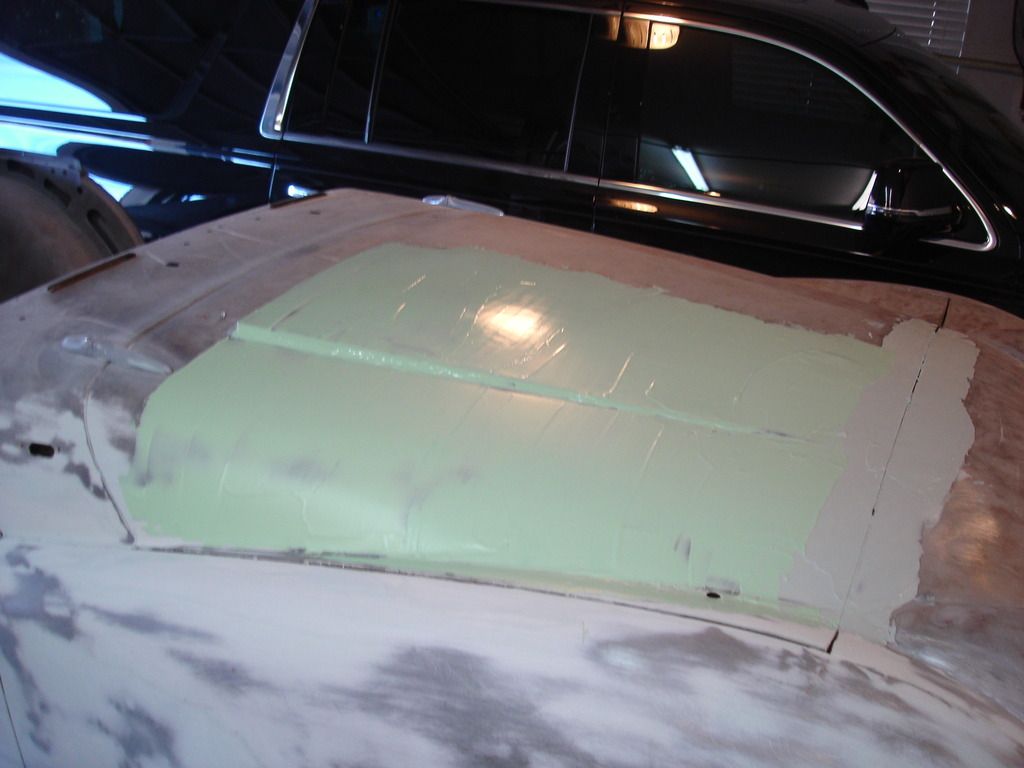

Since I can spread the glaze very consistently compared to the filler, I do not need to pause to cheese grate the first batch. So I am laying down the second batch right away.
And the 3rd batch.
While I am waiting for those batches to full harden (no sticky feel to the surface), here are a couple tips...

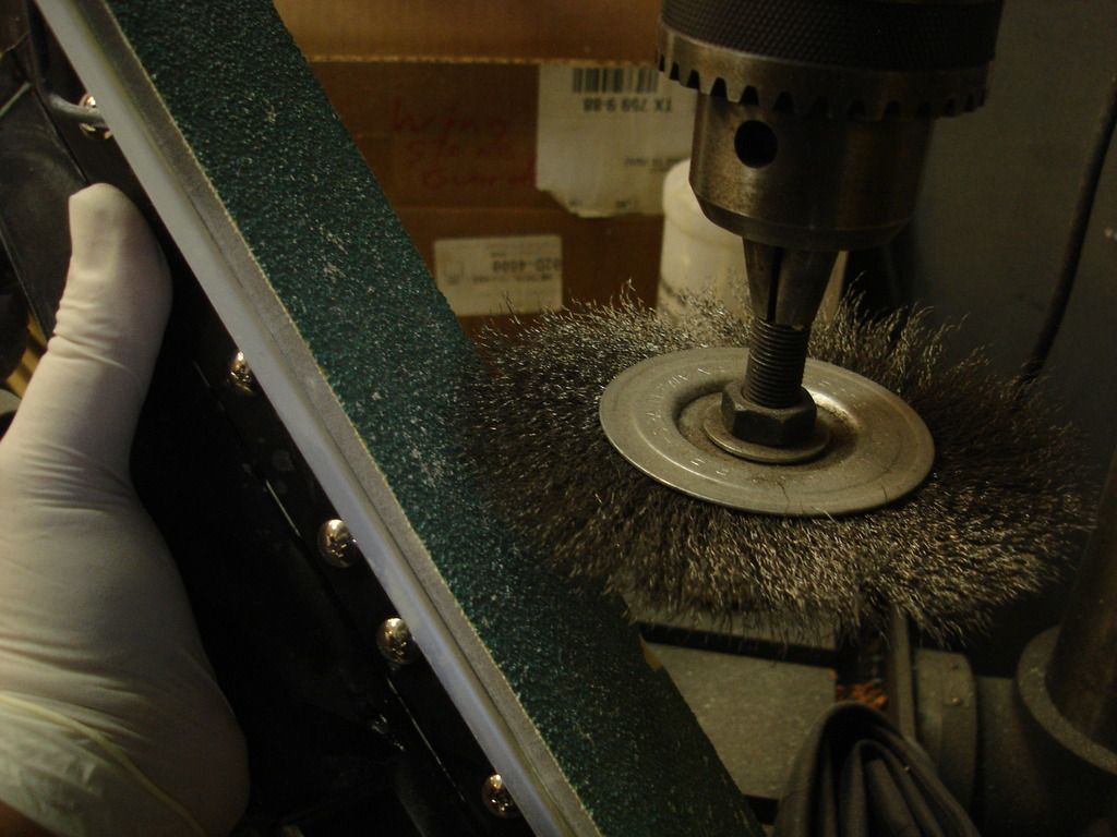

The sand paper can be easily cleared of filler clumps by brushing it with a wire brush. A hand brush is fine...I use the power brush for convenience. So you can extend the life of your paper for a good while!

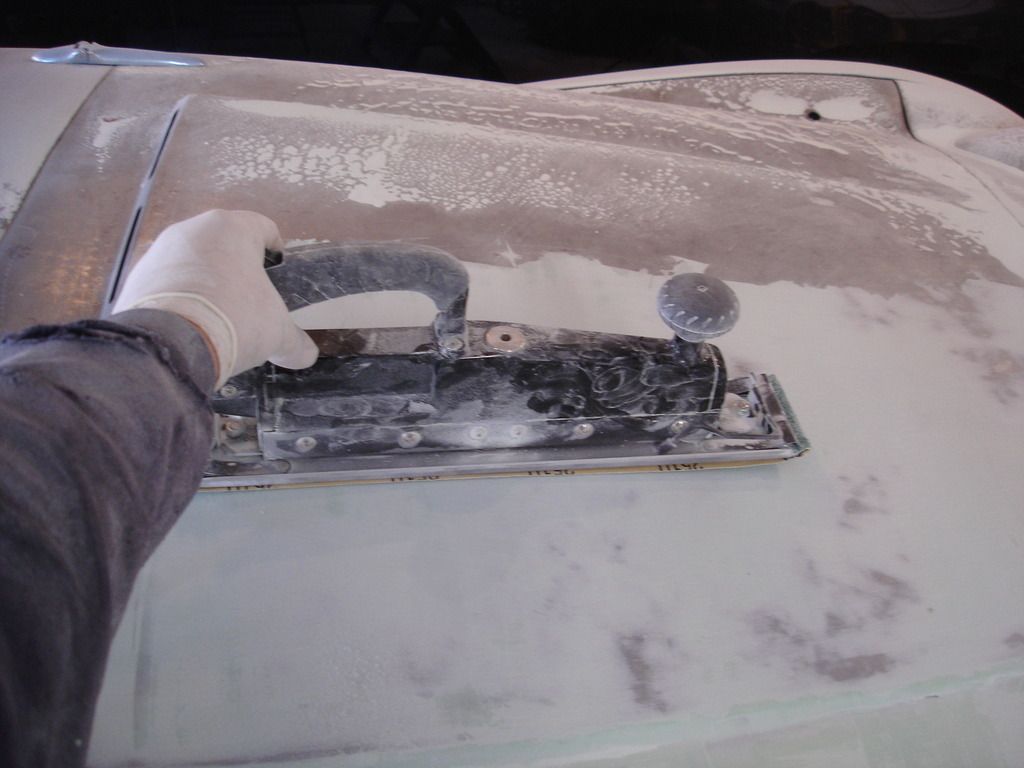

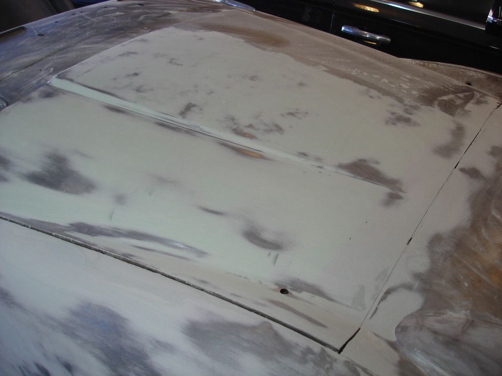

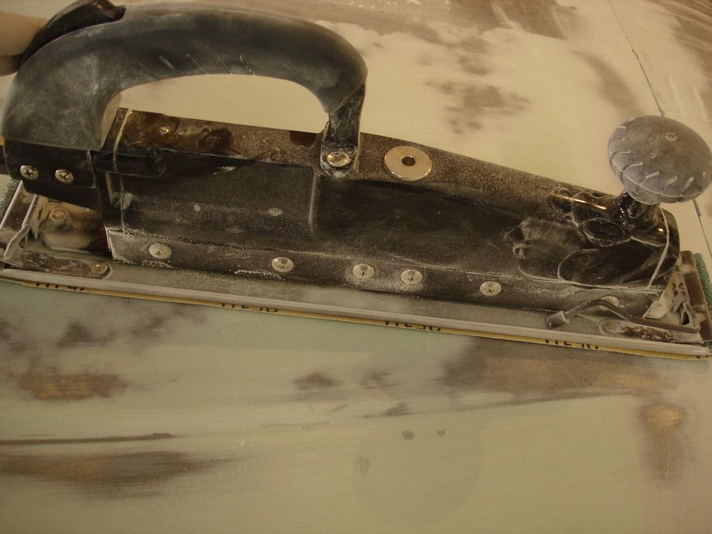

Here I have started the sanding. The bonnet is very important, as it is the most obvious panel on the car, so great time must be spent to make sure it's right!
As I sand, you can see where the sander has cut the high spots, as they turn lighter color. The lows are still seen as darker in color...and you can easily feel them with your hand. Keep the sander flat...do not attempt to angle it to reach the lows. Doing so will cause "waves" in the finished surface. We want a flat, undistorted mirror surface. No funhouse mirrors on our cars!

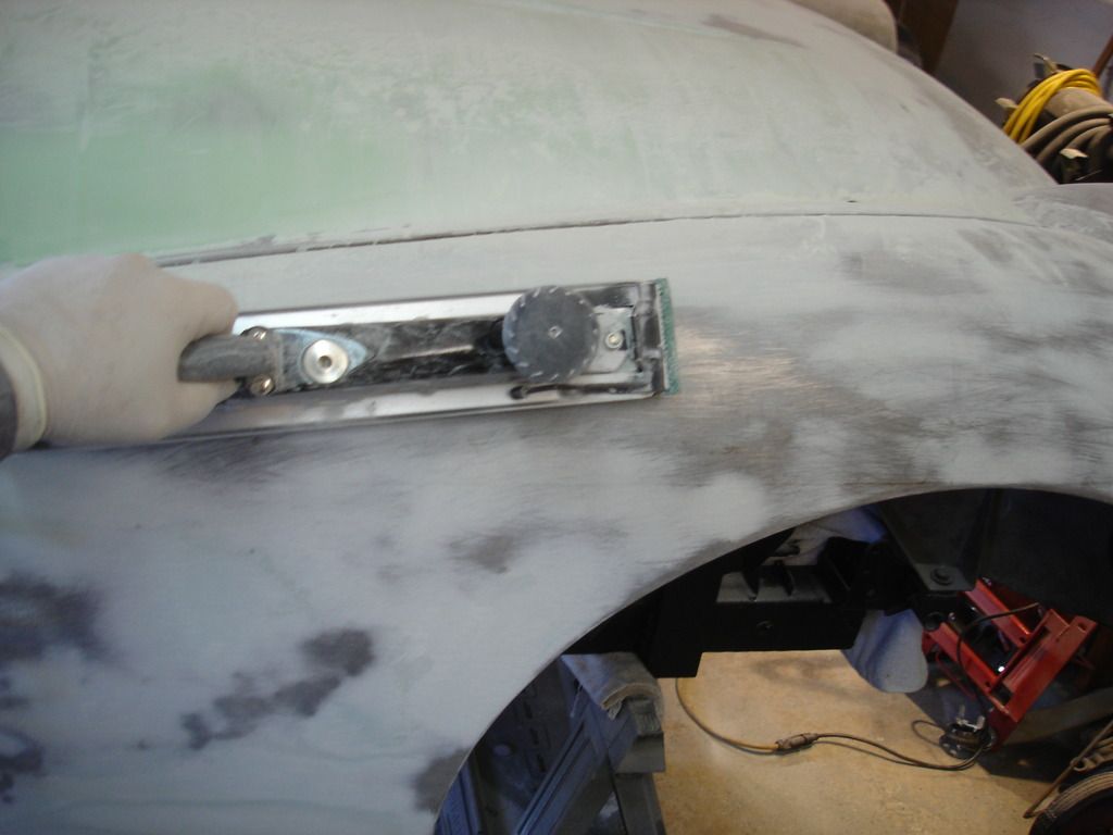

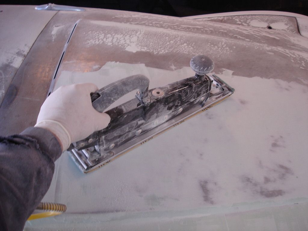

I mentioned earlier that you want the longest sanding block you can get. Here it is important to use that length correctly. Notice that on a surface that is curved in one plane, you hold the sander as shown. As you sand keep it moving, turning it to match the angle of the surface you are working on.
The bonnet is more of a "flat" surface. Most of the sanding is done on a flat surface holding the sander lengthwise, as shown. But!::
For about half of the sanding, angle the sander about 30 degrees in either direction. ALWAYs keep the sander moving, so you do not cut a ridge into the filler. By angling, you will make the surface gently rounded as it should be.

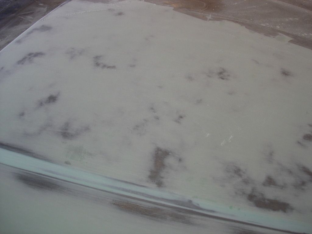

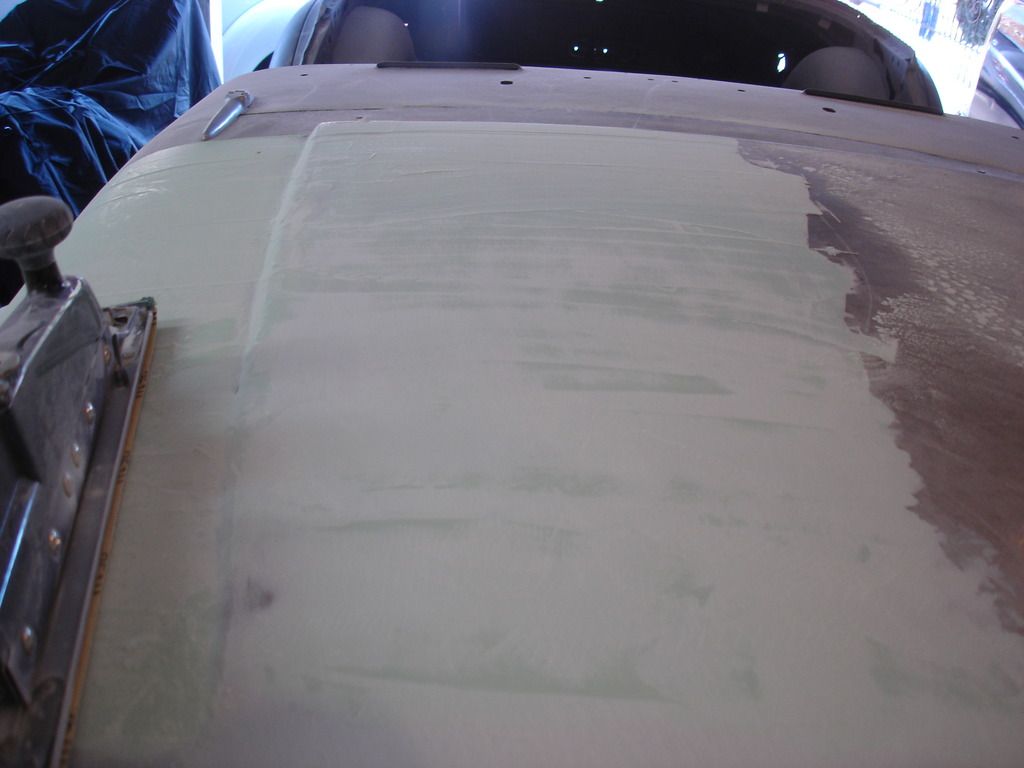

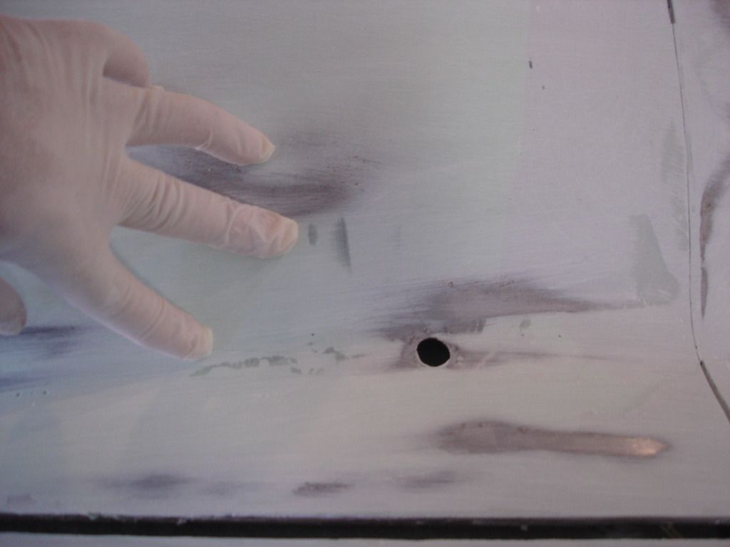

Here you can see I continued the sanding as described above until you have cut through to the metal. When you have cut through so the sander is now "bridging" between 2 high metal spots...STOP! At this point the surface is flat. If you attempt to reach any low spots once the sander is bridging, you will make waves in the surface. We are using the long sanding block to eliminate waves. We do not want to do anything that will cause them!

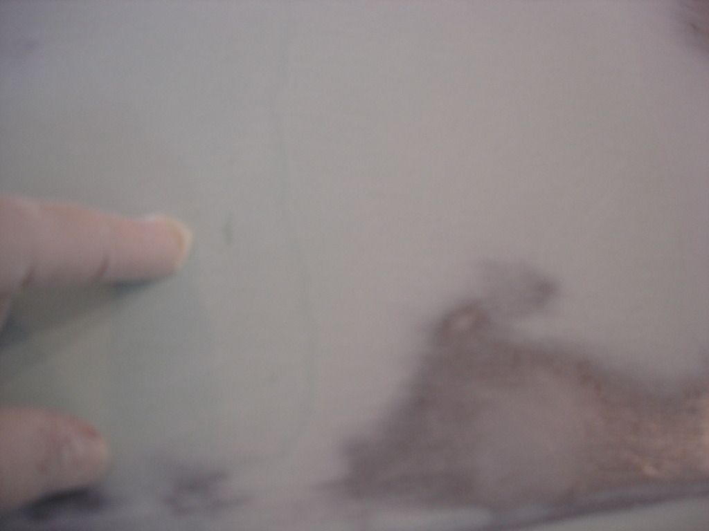

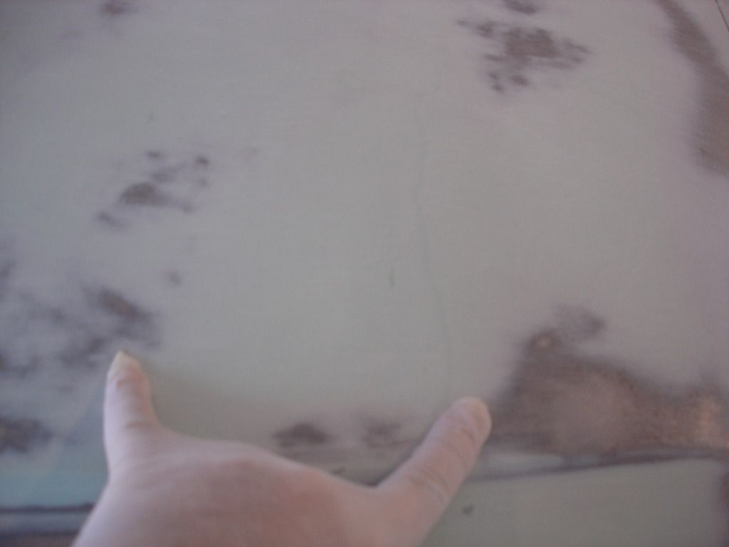

Just past the tip of my finger you can see a spot that is darker. This is a small low spot. We will fix this by applying another layer of glaze...but only around that one area. There is no need to re-glaze the entire bonnet.
Here I am pointing to the 2 high spots that have cut through to metal. The low spot is between them. I do NOT want to keep sanding at this point. To remove the low spot more filler must be used!

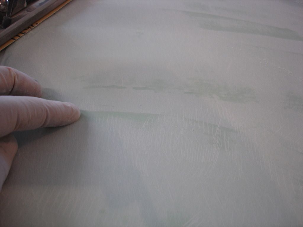

This is the sander over the same spot...showing that the sander block surface is "bridging" the high spots and cannot..."Nay"...should not!...reach the low spot shown earlier.
Here are a few more low spots. In this area, near the bonnet dzeus fasteners, I could not use the power sander. I used a 16 inch dowel to sand in the concave shape needed. When using improvised sanding blocks...the rule is to still use the longest block that is feasible for the area you are working.

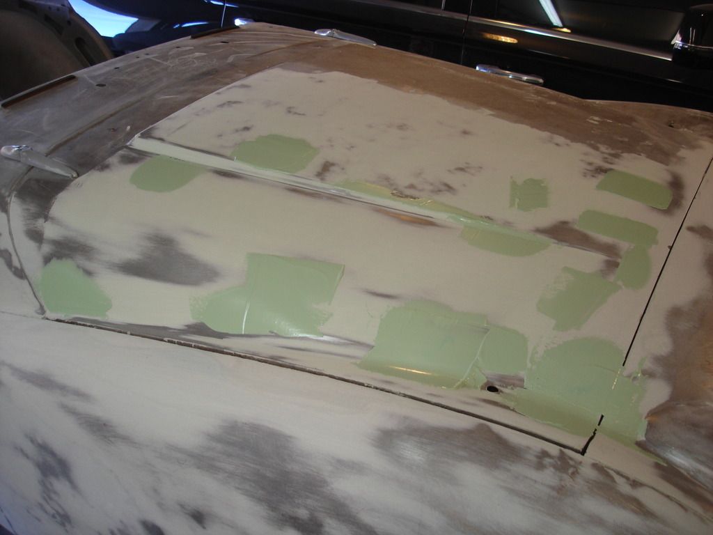

Here is the bonnet top after the first glaze. If you look, you can still see some low spots, but all areas are being bridged, so that is all that can be done for this round.
Second round we apply glaze to only the low spots, as shown. After this round, there will likely be only 1 or 2 spots that need a 3rd layer...or 4th...5th!?!
