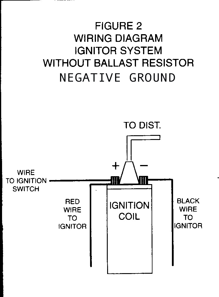

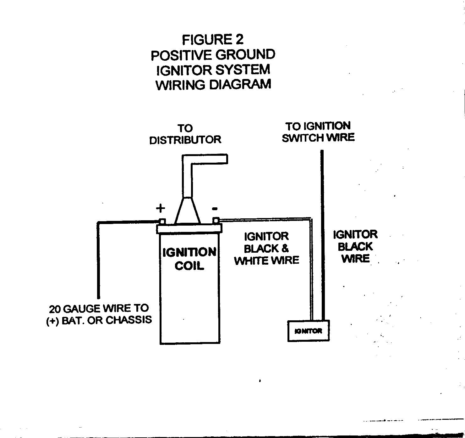

GregW said:
Hi Rick,
How long have you had the electronic ignition? Is it a Pertronix? If it is, I’m confused by the “black wire from the distributor to coil”. On a positive Pertronix, the black wire should go from the Ignitor to the ignition switch. The black/white wire goes to the distributor.
To clarify a bit:
See the attached pics. Note that the negative ground Pert. module has different wire colors & completely different connections than a positive ground unit.
D

Hi guys,
Rick e-mailed me his photos and I resized them to post here. Keoke, looking on the Pertronix website and also Dave’s diagrams, I’m not seein’ a black wire from the Ignitor to the dizzy. ? There also seems to be a white wire disconnected in the photos.
Keoke
That is correct Greg, however the Positive terminal of the coil must be grounded, if a wire color other than black was used so be it, it just violated standard color codes, that wire is not included in the kit.---Keoke- /bcforum/images/%%GRAEMLIN_URL%%/yesnod.gif
Well one thing is for sure the pert is cooked. I also do not like that white misty stuff inside the dizzy. Rip it all out and reinstall points. Dk Lawson had a similar failure in a pert when he accidentally got it damp. I also do not know why there are two switched power wires ,White, coming out of that harness one is connected to the fried black wire . It be a bit of a mess in there need to clean the wiring up. Pert wiring inside the Dizzy not done properly could have shorted 12 Volt line.-Keoke
P.S. Note the rotor it is a good one; "No Rivits" give it a good cleaning up it shoud be OK.
I think the black wire with the Red insulator is what you are referring to and is the ground wire, which is correct, and it is terminated under or on the harness clamp on the wheel arch. Hard to see though.

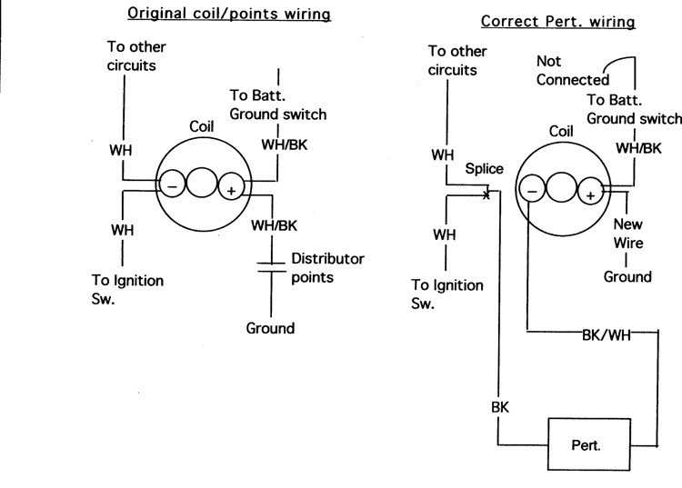

I can't tell from the pics exactly how it is wired. Not sure if it's correct or not. If it is wired wrong, the module may well be damaged. I have attached a drawing in an attempt to better explain how it should be wired for a positive ground Pert.
I'm not sure where the old WH/BK wire that originally went from points to battery ground shutoff switch ended up.
Dave

Keoke
Hi Dave, I did not see that wire either, but it would not impact the circuit's operation if it were hooked up to the Pos terminal of the coil. Further, very close examination of the Dizzy suggests that the Pert module might have escaped harm and a new black wire could be spliced on. ?? Further, this distributor shows signs of extreme neglect excessive rust on the top plate and probably propagates to the action plate underneath.
I would suggest that the Dizzy be sent to Jeff for a complete rebuild. However a pro rebuild will not compensate for poor wiring practices out side the unit. For example the switched power line connection to the black wire of the Pert does not have a proper Male lucar insulated connector on it. It appears to have been just jammed in the end of a deteriorating Female one ---Keoke

Hi Rick,
Looks like that loose white wire needs to be joined in with the black wire and the other white wire. My guess is that is your power lead that goes to the Pertronix. The white wire that is connected may be the one that goes to your ignition switch. This may not solve the original problem though.
healeynut
Greg/Rick -
No no no. That white (with black stripe) wire is the ignition grounding wire that goes back to the master battery switch. It is ok to leave this wire un connected to anything.... all it does is ground the ignition (so that it won't work) if the battery master is switched off.
Rick - just do yourself a big favor and reinstall points and condensor, then go from there. If the Pertronix is cooked, this will be the fastest and easiest way to tell.

Hi Keoke,
No, that was not the wire I was referring to. Rick’s second post mentioned the black wire going from the dizzy to the coil. He had also mentioned his car was positive ground. That made me wonder if he had a neg. ground Pertonix installed. The photos show that it is a pos. ground Pert. and the burnt wire was the black wire in the foreground that connects to the two white wires that come from the ignition switch and go to the fuse block. /bcforum/images/%%GRAEMLIN_URL%%/cheers.gif
