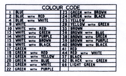

Hi Keoke,
I recently replaced the wiring harness with a new one from Brit Wiring. The wiring was actually as Greg shows. "The long way home"
The feed path is battery hot at volt. reg. via wire #36, BN/BLU, to the "not switched" side of lighting switch, another #36 wire from the same terminal on the lighting switch to the ignition switch. Also other branches from the ignition switch "not switched" side.
From the ignition "switched side" to the coil via wire #9, WH. From the same coil terminal to fuse terminal A3, which is the switched but unfused side of the 17/35 fuse, via another white wire.
At fuse terminal A3 it branches to other switched but not fused circuits.
The fused terminal A4 then goes to other circuits which are switched AND fused.
I didn't design it, but it makes some sense that the shortest feed is to the highest current (lighting) first & then on to the lower current circuits.
I have attached a chart to match wire colors to the numbers on Greg's diagram.
D
