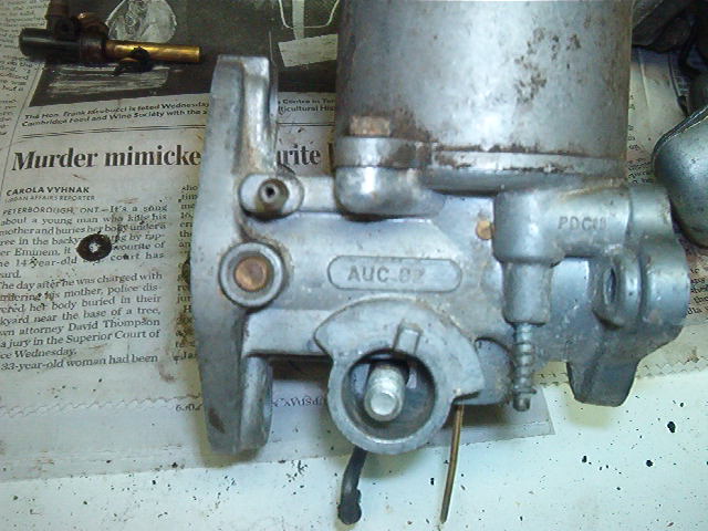

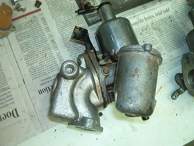

OK so I'm an idiot - it's an AUC 82 - here are some pics
Oh, and Tony, the throat is 1 1/4" (HS2 right?)
carb with manifold

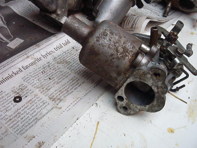

and throat one

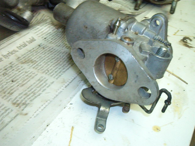

and two

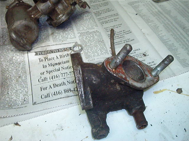

and manifold
(BTW I have a number of these so they aren't all the same carb)

AUC.......hmmmmmm.....just from looking at them, they look like the carbs on my '63 Midget but I think all our MG's were AUD's.....& I've never seen manifolds like that before either.....were they used in single carb setup or dual carbs? Almost looks like single carb....

I keep thinking motorcycle or something. Either it is a single or it bolts to another manifold piece. The guy I got these from is into microcars but even there I can't think of a single cylinder with an SU - though maybe a 2 cylinder with 2?

The AUD 13 carburetor assembly used a AUC 82 body I believe. It almost looks like the manifold was used to adapt it for down draft flow, maybe in a A40 Devon or similar. Ask Nial (aeronca65t) he knows A40's.

The manifold (or adapter) in the first photo is clearly for downdraft application, adn try as I might I can't think of a production vehicle that had SUs as standard with a downdraft manifold. It would pretty much have to be a "Nuffield - BMC" mass-produced car, or else a low-production car, like Morgan, or maybe a Coventry-Climax or similar engined one.
So that leaves special adaptation, tuning or what-have-you, like the Minx and Zephyr tuning kits referred to above. I know VW Derrington were fond of SU adaptations, though they were also Weber agents.

On the Float chamber it says AUC 1390 with PDC10 below it
On the Float chamber lid of two, there were tags. As near as I can tell (they are worn)
one says: FZX 1253
the other says: FZ 1351 10WK 744

The numbers on the tags are the carb model numbers. The other numbers are the individual component part numbers. The 3 letter needles are self centering indicating a "newer" carb.
Are you sure there isn't an X in the second model number. If there is they look like they may have come off of Reliant Robins.
Good catch! I forgot Reliant. Sometime in the 70s they replaced the Zenith with an SU and that may well have sat on a D/D manifold.
