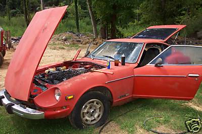

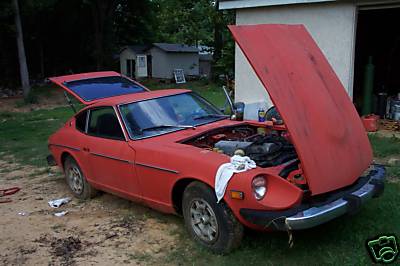

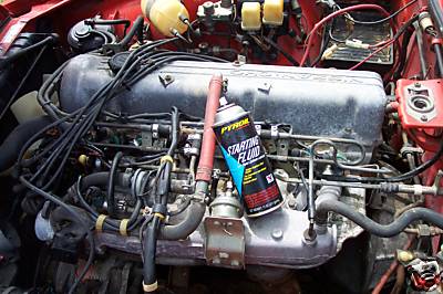

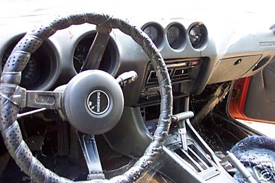

Looks like a new project in the house. Our youngest is 14 and needs a garage project. We picked this up today on e-bay.
We will be picking it up next weekend. It runs (barely)but for $355 we figure it may be a good project to cut his teeth on. -Plus it keeps him away from my B:smile:

Banjo
first order of business is to inspect the floorboards. Especially right behind the front wheelwells, where the reenforcement rail is welded. they were known for rot there. and that is a major structural part of the car. Other than that, old "Z" cars are shweet!!! I love 'em.. oh yea, except for the ones with the early fuel injection... electronic control, no diag link... ugh... It takes someone who has experience with them to figure 'em out
Either way, pics look great! ought to be tons of fun.

Boy, hydee!! I've been looking for a good 240Z - 260Z for a long time...if you found a solid one, you've scored a win!! Those things seemed to rust worse than our cars....

Okay, I see an auto selector.
The auto's were pretty reliable when the oil was changed regularly. If it has been neglected, either a rebuild or replace with a manual. Both strong. Good strong driveline. Engine is pretty solid. Time will wear the timing chain tensioner, but pulling that is relatively easy. Oil pumps were pretty common wear items, and again easy to replace. Early injection,,,,,,can be swapped for early carbs, Mikuni/SU clones which offer quite acceptable performance.
Hopping up is easy, cam, headers, and intake.
Lemme know if you need any of the injector stuff.
