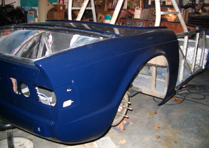

Well I skipped the pearl and painted about 1/3 of the car.
The color is PPG Concepts single stage. I tried to get the stock color but PPG doesn't mix the stock color any more, so I got whats called nightwatch blue, it is a lighter color.
It is a odd looking paint, it is real dark in low light and then gets lighter in color in brighter light.
It has what I would call a candy look to the paint and a lot of shine. I attached a picture.
