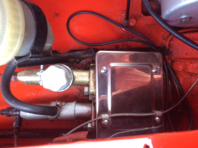

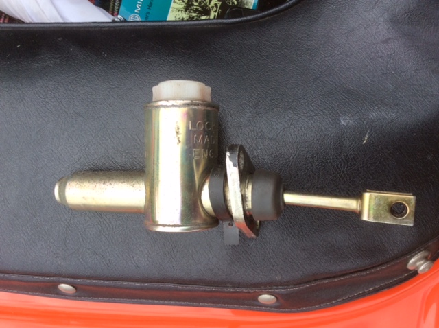

I have noticed that the MGOC spares have identified that the master cylinder can be Identified with two concentric rings but I cant find them on mine.
2 pictures attached. One is the removed master cylinder the other is as fitted. Maybe I should refit the original one as it wasn't faulty after all. (New seal kit of course()

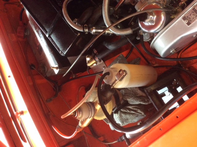

can I suggest starting with trying to get the Master Cylinder higher than the hose before you take anything apart - as I am typing this I recall that some people jack up the corner of the car higher than the hose - but even to disconnect the MC (which isn't hard) and leave it overnight higher than the hose - the air should <should> leave on its own.

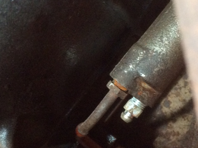

Thanks JP, couple of pics attached. I removed the master cylinder and raised it well above the pipeline and then used the ezibleed. Lots of bubbles came out. I also checked the slave, the bleed nipple is higher than the feed not a great deal higher but better so I left it as it is. Now for a test run.
