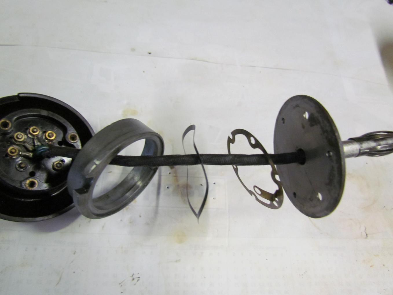

G'day Bruce,
There is a light spring washer within the assembly, sometimes referred to as a 'wave' washer that loses its tension. Simply bending it back to its "wavy' shape will IMG_0420 Trafficator 6.jpgeliminate the rattle. Unfortunately, you have to remove the stator tube to get at it!

Hi Bruce,
If you look at the right hand side of my photo you will notice that the stator tube has a sort of tubular spring on it. This gadget centralises the stator tube inside the steering column. That part also wears because it stays still while the column rotates with steering input. Perhaps that is also worn? The bad news is that that part is not available from any of the normal suppliers. I recently helped out another 100 owner with one that I had liberated from a wreckers (or breakers) yard. Most '50s Austins have them.
