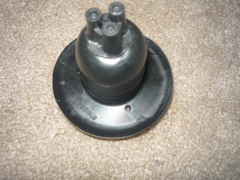

I am having trouble getting the glass and ring to fit into the new bee hive sockets I received from TRF. The sockets look and feel like a soft flexible rubber product, but seem too small. Has anyone figured out a way to install the glass and chrome ring?

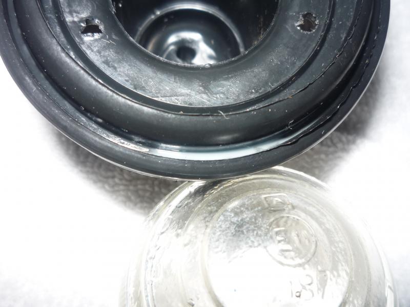

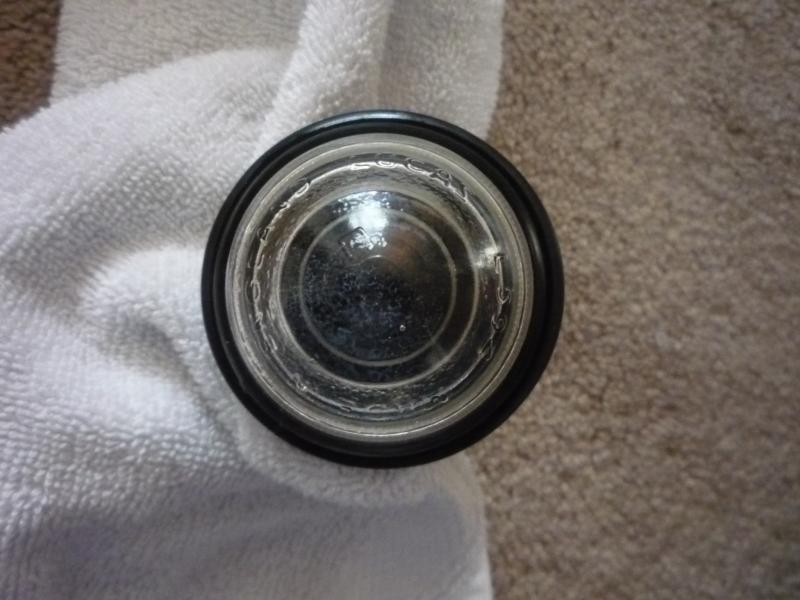

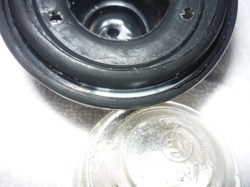

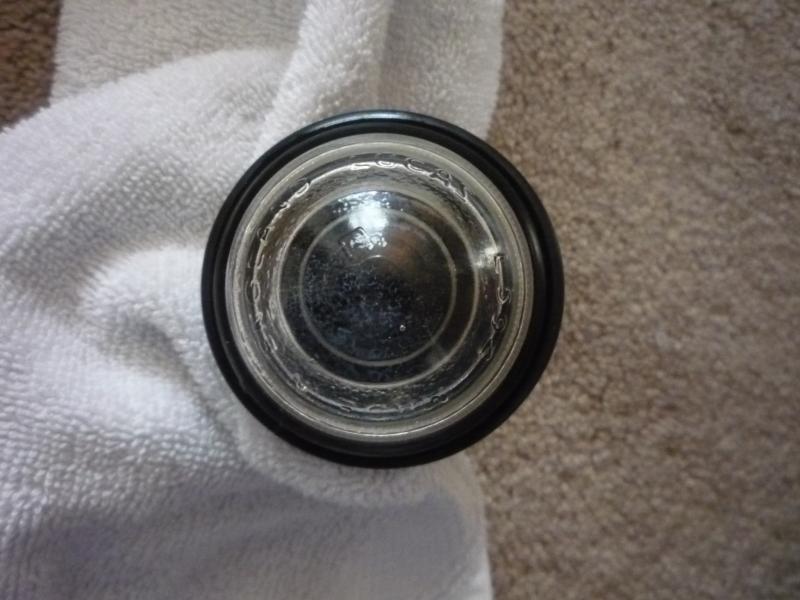

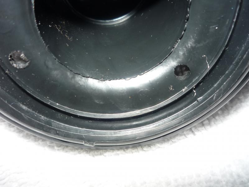

I wonder if current repo body is smaller or less supple that the originals. I'm using 'hide from the virus' time to look through parts boxed up decades ago; this is from an NOS Lucas rubber body (PN 576105) measured as best I could:
ID of the rubber body inner ring: 2.25" OD of glass lens base: 2.335. So the rubber has to stretch about .085.
OD of the rubber body: 2.75"
I can't find a chrome ring to test-fit right now, but in the past I remember needing a small flat-blade screwdriver to seat the outer ring. In the third picture you can see there is a small ridge to help seal the lens (I think). How does it compare to the new ones you have? P1110346.jpg P1110339.jpgP1110341.jpgP1110345.jpg
I can't find a chrome ring to test-fit right now, but in the past I remember needing a small flat-blade screwdriver to seat the outer ring. In the third picture you can see there is a small ridge to help seal the lens (I think). How does it compare to the new ones you have?View attachment 62616 View attachment 62613View attachment 62614View attachment 62615
While I don't have the car handy (it's at the body shop) to check, I remember it looks very similar to your photos. I know the first time around trying to fit the chrome ring, I split the rubber in several places. Once done, it didn't look bad, but I bought another rubber piece to replace. Compared to the original rubber, my guess is that it's not as pliable. Gil's suggestion of Windex is a good one to try.

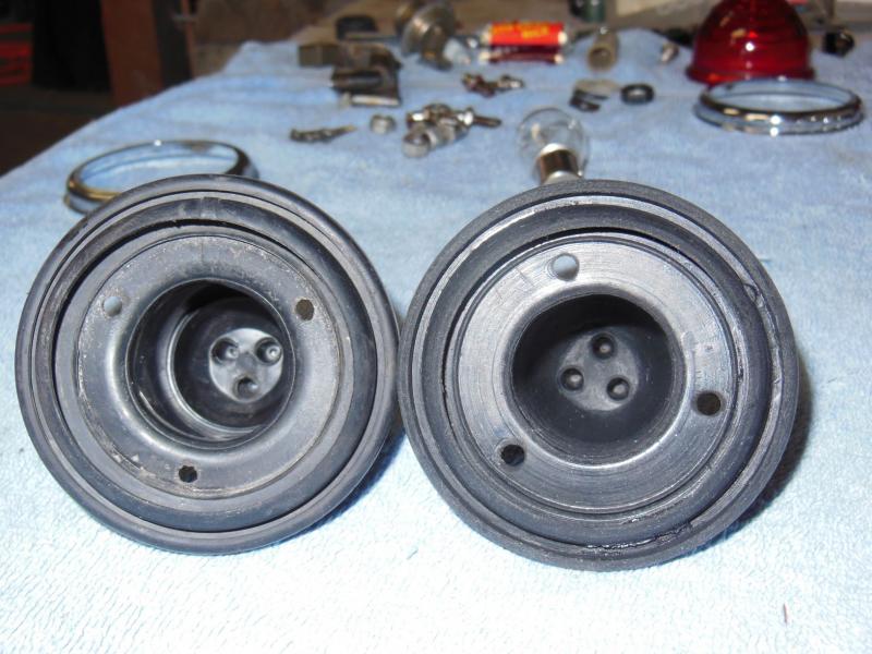

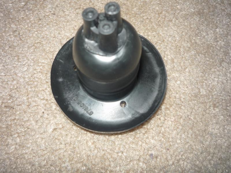

I could not get these rubber boots to work. The original one is on the left. The problem is in the center ring of rubber is manufactured wrong. The rubber is about an 1/8+ smaller in diameter on the center piece of rubber and as a result moved closer into the center, so that when the glass piece goes in that pushes the inner rubber ring out too much and will not let the chrome ring into the grove. The tool I use is a small screw driver with rounded edges also. The Vaseline did not work too well because the rubber is too tight. The lubricant makes it possible to get the glass installed, but when I let go of the glass the pressure from the tight rubber shot the glass out to the floor. Luckily the glass did not break.
Fortunately, I had some old original ones that worked.
Heck I have been putting these in since 1972. Now I want to call Chuck at TRF and try to figure out how much they care plus someone is going to put a scratch in their paint trying. I think I paid 4 dollars each, so heck, and then there is shipping them back. I doubt if they will pay that. I would really just like to inform them and get a store credit.
