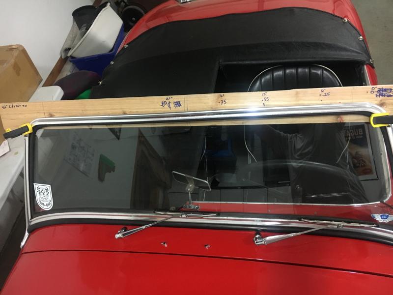

Ok the best I could do
your going to need some ship building skills

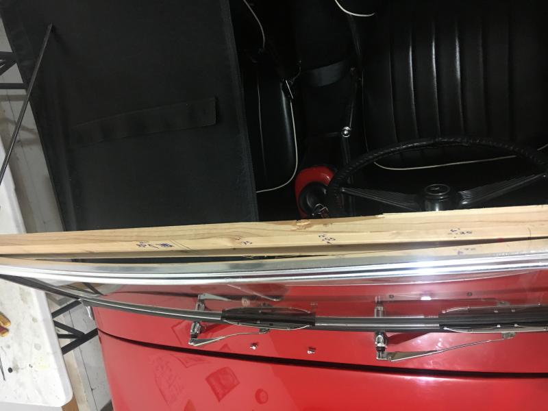

i clamped a very straight board across my top portion of the frame
I used the lift the dots as regency pionts to get center
measuring from the inboard edge of the frame to the edge of the board
the curve is a decreasing arch.
i stationed some measurements from the driver side lift the dot
station 0 = 0”
station 2 @ 6” = 0.25”
station 3 @ 12” =0.55”
station 4 @ 16” = 0.75”
station 5 @ 21” = 0.80
So what I would do is
on a 1x4 inch board is mark center on 42”
then mark the stations on th edge
take a square mark the pulled station measurements.
the find a thin piece of flexible wood or whatever batten
put finish nails at the pulled station measurements and put the batten against the stations
mark the curve cut it out with a jig saw and bobs your uncle F015CDF5-0404-4B07-94AB-3C88BBD0B3CC.jpg0D108541-7396-4911-8C9F-EE22254DC907.jpg

Dang SD, thats rad, thanks for the work on that! I owe you a beer!
Glad I could help
didnt think I would use old sail boat building skills again.
thank uncle George not me
