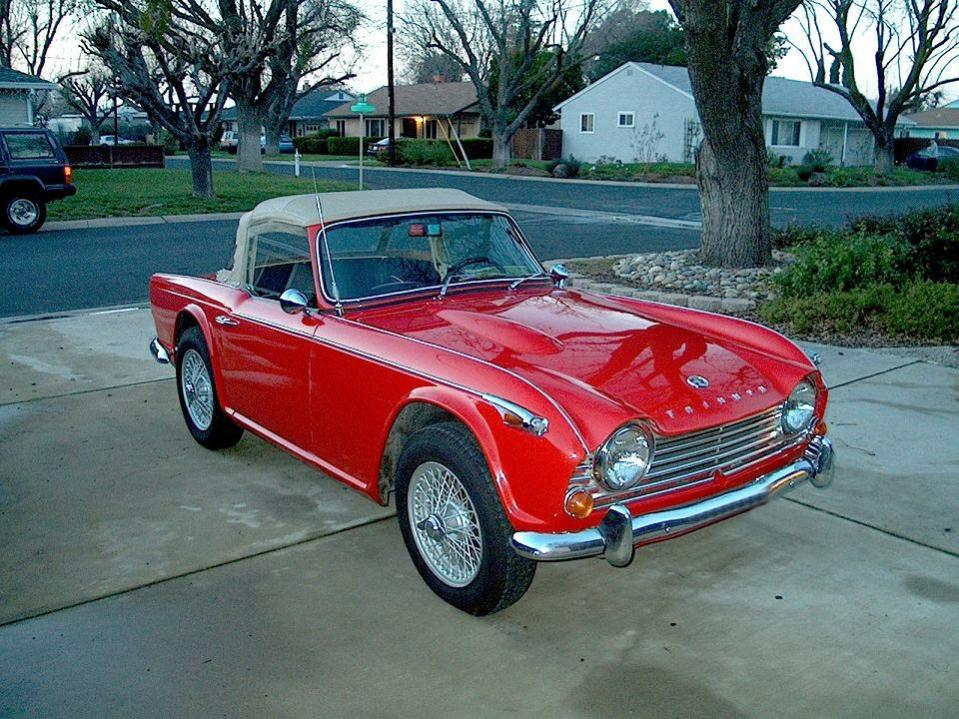

Thanks so much for the replies folks. It seems the consensus so far is that they should work, and that maybe a spacer is needed behind the splines. I have a few days before I commit, so I'll wait and see who else might chime in. triumph 9 reduced 40% bestjpg.jpg Thought I'd throw in this pic of my pride and joy.
RJS
Wow! Gorgeous. And you are the original owner...amazing!
Seems like we have the exact same cars and both joined BCF Sept 2009.
I've owned mine since July 2000.
Bob
TR4nut
Wow that is nice. For what its worth, I don't think you'll need spacers as you already have wire wheels - the studs are already short. So you probably have an even better chance that you'll clear the fenderwells. Also, 195-65-15 is very very close to 165-80-15 tire so height won't be an issue
