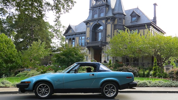

VTO is having their Black Friday sale right now, last two days, today and Friday. CLassic 8 silver 15x6 +24mm offset, 4x95.25 (4 x 3-3/4") bolt pattern, comes with center caps, Triumph center cap logos, lug nuts and valve stems, sale price $569.60 for a set of 4.

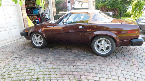

17" rims are WAAAYYY too big for the TR7/8. I went with 16" rims last spring, with 215/55-16 performance tires. They are a real pain. Virtually no clearance at the rear of the wheel wells. And, I rub on the front wheels front edge of well, when backing up in a turn (e.g. out of the driveway). I had to trim away at the bottom of the wheel well to stop the rubbing.
I am now looking for a set of 15" 4x100 rims with a set of 205/55-15 tires, to replace them.
Save yourself some grief and stick with 15" rims.
Here is a pic with the 16" tires: https://farm3.staticflickr.com/2847/9137094358_baeca27509_c.jpg
M.

Bsam21- Did you roll the wheel arches?
Yup. And it isn't the easiest to roll, as the lip is already a sandwich of the outer fender and inner well sheet metal edges. And, it's much thicker metal than modern vehicles as well. In addition to rolling, I had to use a body hammer and dolly to finish it off.
Then, when I remounted the wheels, I decided that the wheels and tires looked way too big for the body, so added fiberglass arches to give it a better look.
M.
