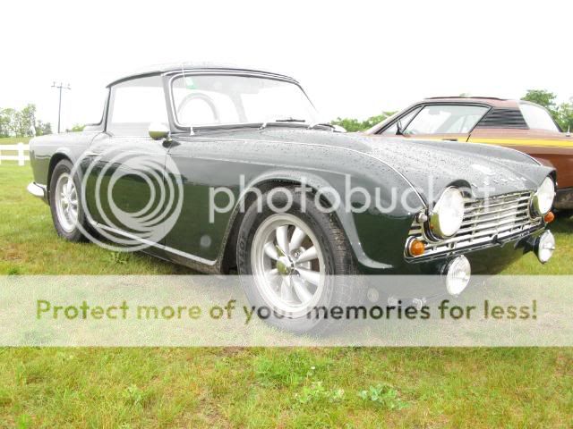

Here is one of my favorite 4's from my local Triumph Club

Aah Silverstones. Why do they always looks so good? Probably because I can't find any?

I do like those wheels but I don't get the knock off spinner on a bolt on wheel. That's is a great looking TR4. Who made the Silverstone wheels?

M.P.L., I agree- That is one of the nicest looking TR4's around. Love the Silverstones. Any idea what size tires those are? Any chance you might be seeing the car again soon and could verify?
M_Pied_Lourd
Hoffman,
Probably not until June when we have our annual Club BBQ...I suspect that will be too late?
