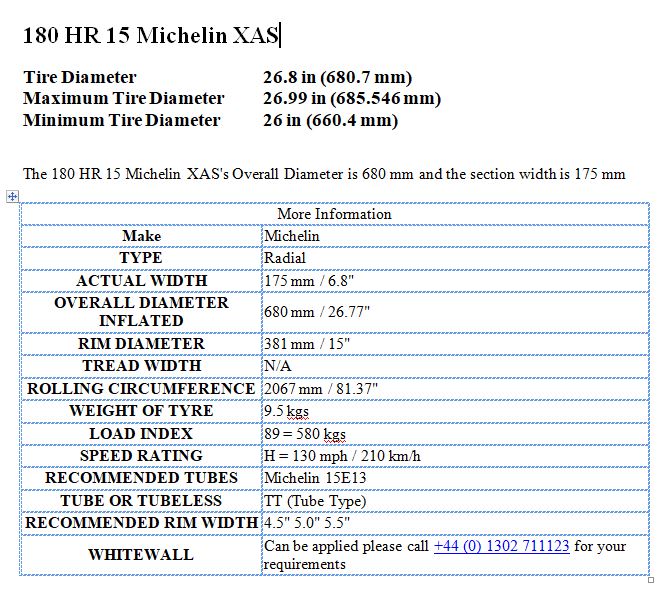

I have these tires mounted with tubes on Dayton 72 spoke wheels (sealed to run without tubes). So far, the XAS tires have been great and maintain pressure extremely well.
I purchased them from Longstone Classic Tyres in the UK and they sent Michelin tubes with the tires. I would contact Longstone for information since they know more about these tires than most shops in the United States; and they have always proven to be knowledgeable and happy to provide technical assistance.
I believe their website may have a video that discusses the recommendation to run tubes with these tires.

First of all, Thanks Danny for the catch - I had a senior dyslexic moment, my brain was thinking 26.8 and my fingers typed 28.6 :smile:.
I called Longstone Tyres in England this morning and chatted with a fellow who said they are definitely a tube type tire and I asked if they could be run tubeless and he said no - they may not hold air well. He also said they sell lots of them for Healeys and confirmed there are no other 15" Michelin tires available with 26.8 diameter eg. 175/70 x 15 are 24.6.
I did find that Vredestein sprint classic 185VR15 are 26.97 but are slightly wider that the Michelins (and a whole lot cheaper)
Not yet sure which way to go - the review on the Michelins are so good that I may have to use tubes.....

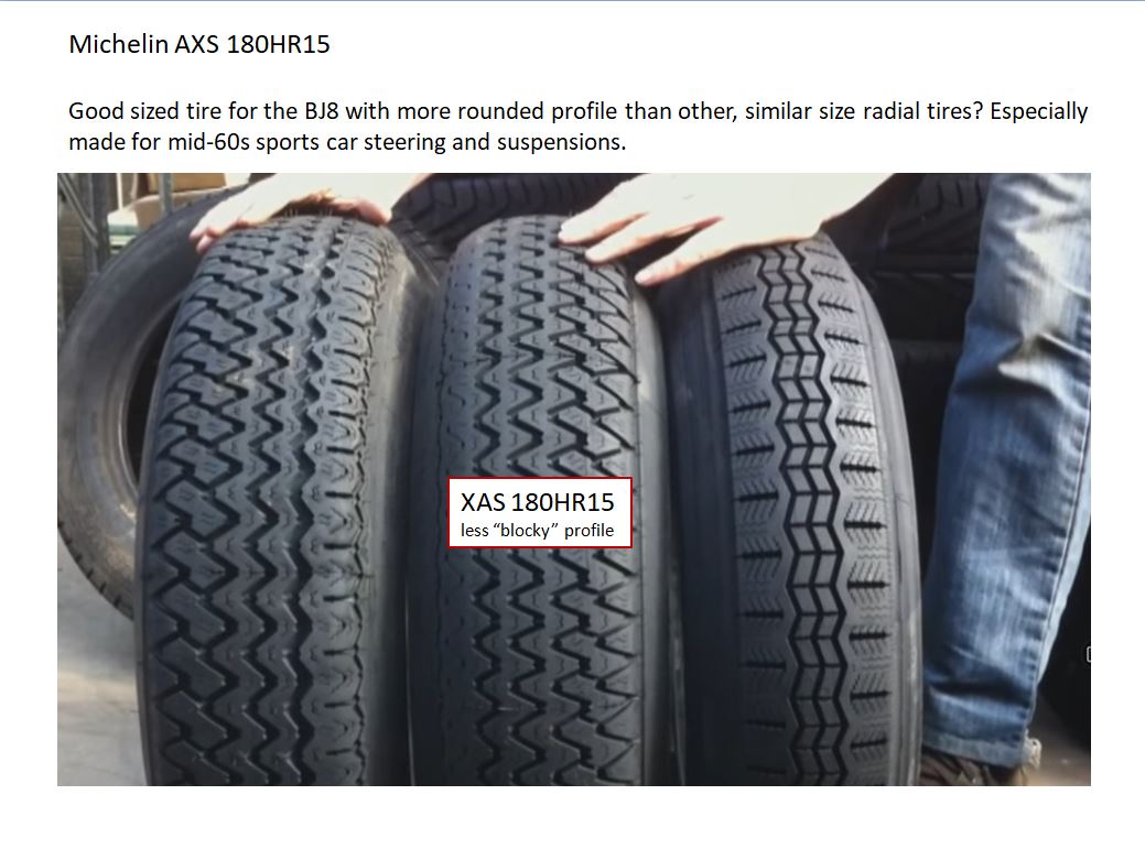

One thing you might care about is the profile of the tire.
I have used Vredestein tires on my wife's MG TD and they are nice tires for the price. However, their tread is more blocky than was used in the day (we replaced them with Michelin 165 XAS tires which proved to be a good upgrade with its Borrani wheels).
The rounded tread profile on the XAS is better suited to the Austin-Healey suspension and other older British cars, and improves road handling compared with most tires available today.

I have been running 180 XAS's on my 100 for three or four years and I think they are a wonderful tire. They replaced a set of 175 XzX's and give better performance in both wet and dry. Their relatively tall aspect graces the car's lines and nicely fill the wheel wells.
Re WHT's comment that the XAS is well suited to our Healeys and other LBC's: While I do not disagree I think it a bit ironic that an asymmetric tire specifically developed for EU cars with highly sophisticated IRS suspensions such as Citroens, BMW's etc. should work well in our solid axle/carriage spring-equipped vehicles.

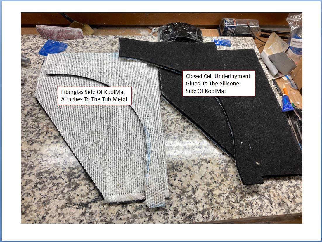

Hi Dave,
I am installing our Skinner leather/wool interior now and believe you will be more than happy with it.
For the carpet, I lined the base of the tub with KoolMat and we used a 1/4-inch closed cell foam for carpet underlayment instead of jute. The closed cell foam is used as underlayment for boat deck carpeting and it will not absorb water when wet and also handles heat well.
Glued the foam underlayment to the Silicone side of several vertical KoolMat pieces first (such as sills and the bulkhead gearbox tunnel opening) with silicone adhesive and weights to hold in place until bonded; and it worked very well. Then, we used high heat Weldwood Landau Top & Trim Contact Cement to attach the fiberglass side of the KoolMat to the tub metal.
The KoolMat is completely waterproof when sealed (like a shower pan). And, other than the four vertical flooring pieces, all of the foam underlayment is removable as is the carpet.
Regards, Bill
