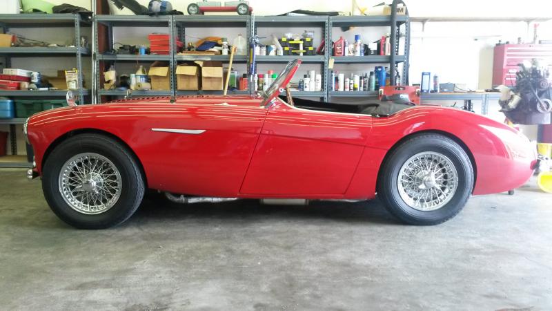

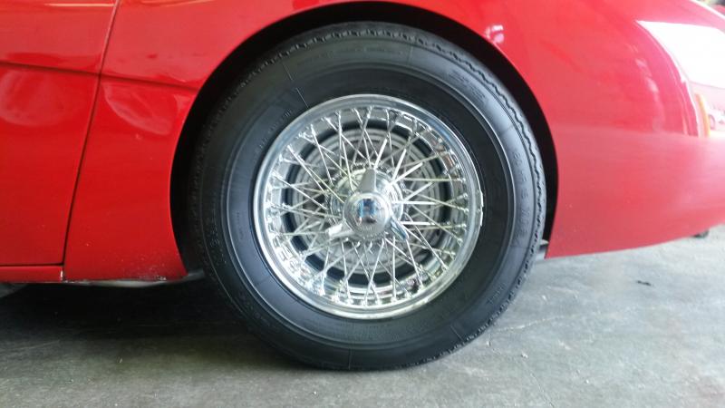

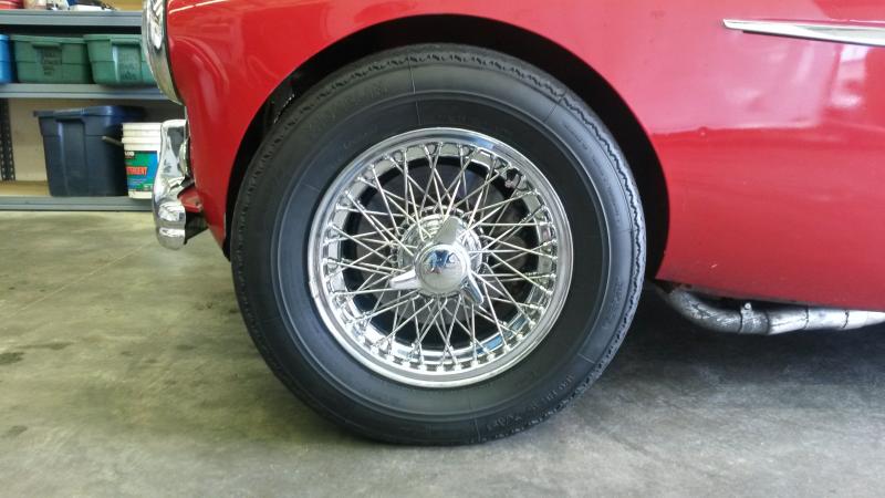

As promised here are three shots of the 100 with 180HR-15 Michelin XAS's mounted up. For whatever reason there is less clearance at the front of the wheel opening for the left front tire than for the right by about 1/2"--probably some accident that preceded my ownership. In any case the tires look and feel great.

Climbingshuskan: If you have not yet acted I would recommend that you go for the 180's over the 165's. No offense to Andrea but please compare my photos to his and I think you will agree that the larger tires are simply a better fit. They fill the wheel opening very well and provide a bit more ground clearance, always a consideration on a Healey.
