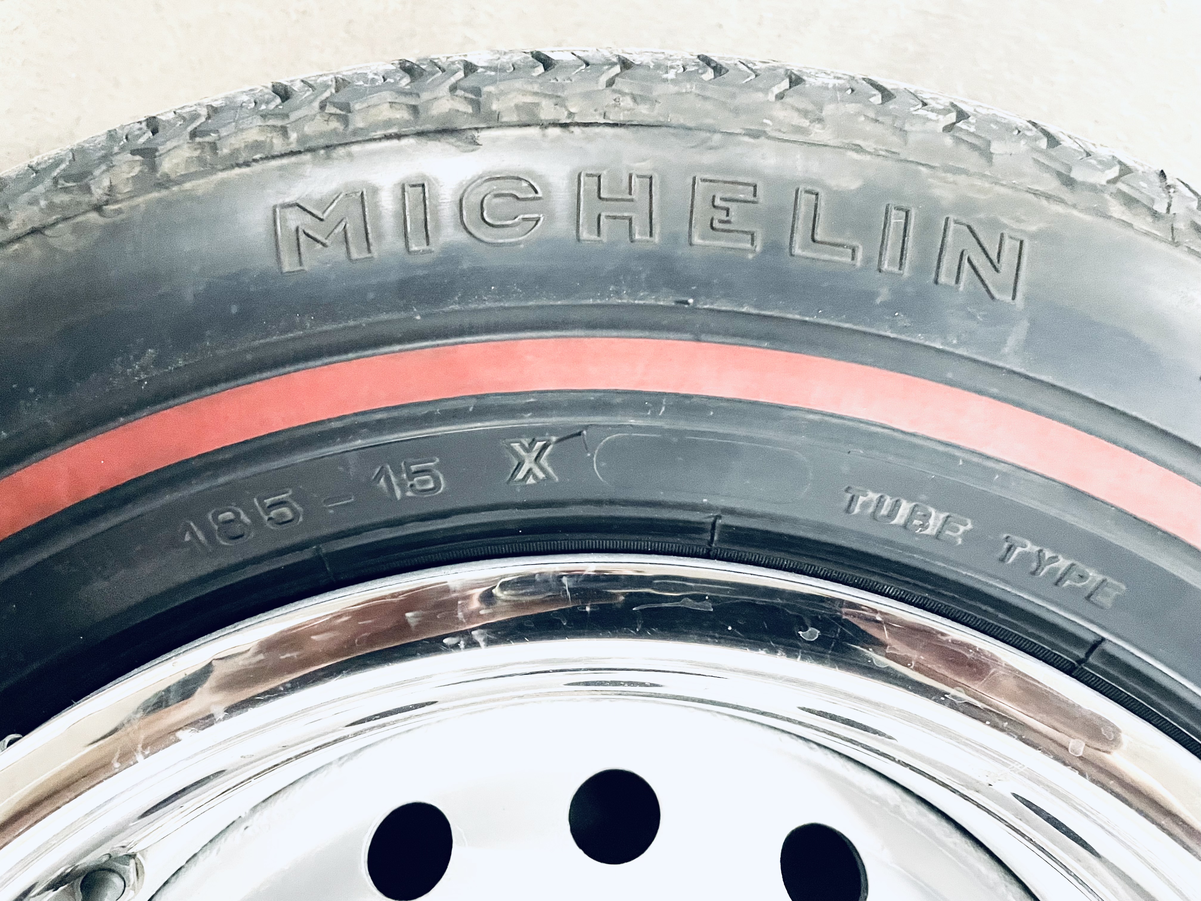

185-15 tires. Couldnโ€™t see any specifications on the current rims

Yikes! That's what I was afraid of. The last three digits are the manufacturer date; before 2000, it was only three digits, the first two being the week and the last one being the year. So your tires were made the 31st week of 1999, or maybe 1989, or perhaps even 1979.
Bottom line: Save these for display if you like, but don't drive on them! You could get lucky; more likely, they will fail at a bad time, risking your car as well as your life and that of others! Modern "rule of thumb" is six years for tires (some might stretch that to ten years). But since yours are 22 or 32 or possibly even 42 years old, it ain't worth the risk!

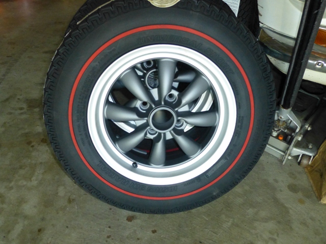

I have original Michelin Redlines on wire wheels for my 250. I replaced them due to the tires age with Universal Sports on alloy wheels. The wire/tire combo are sealed in bags for posterity.
RGK

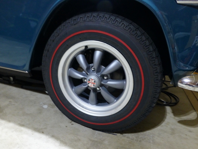

beautiful look Ralph, nicely done!
Thank you. The wheels are from a fellow in British Columbia, a replication of the ARE magnesium wheels offered on the 250.
On the car with center caps.
