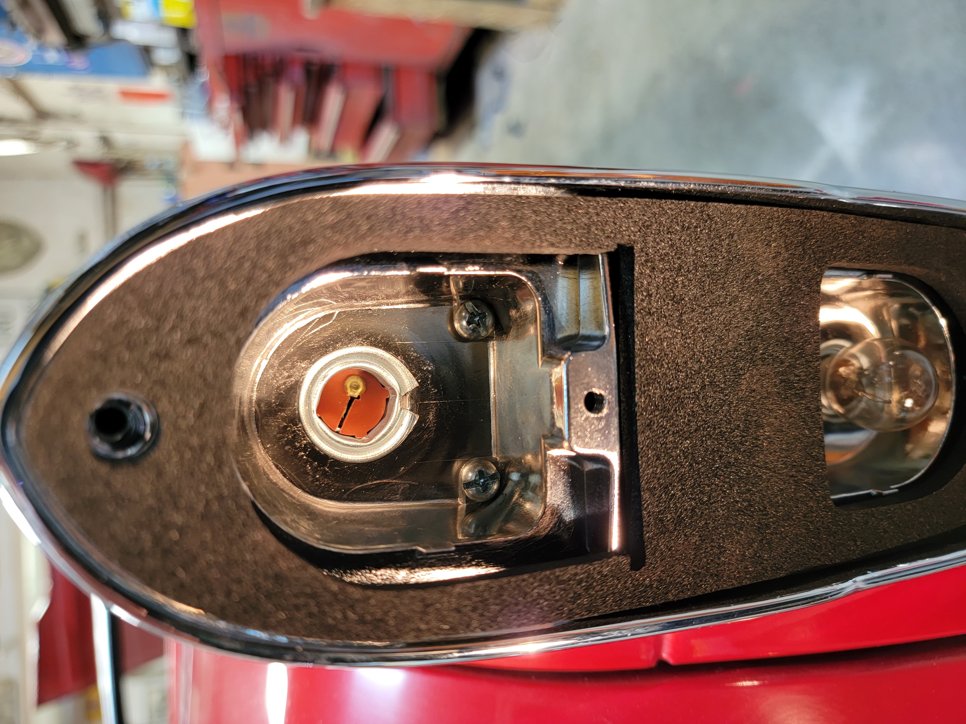

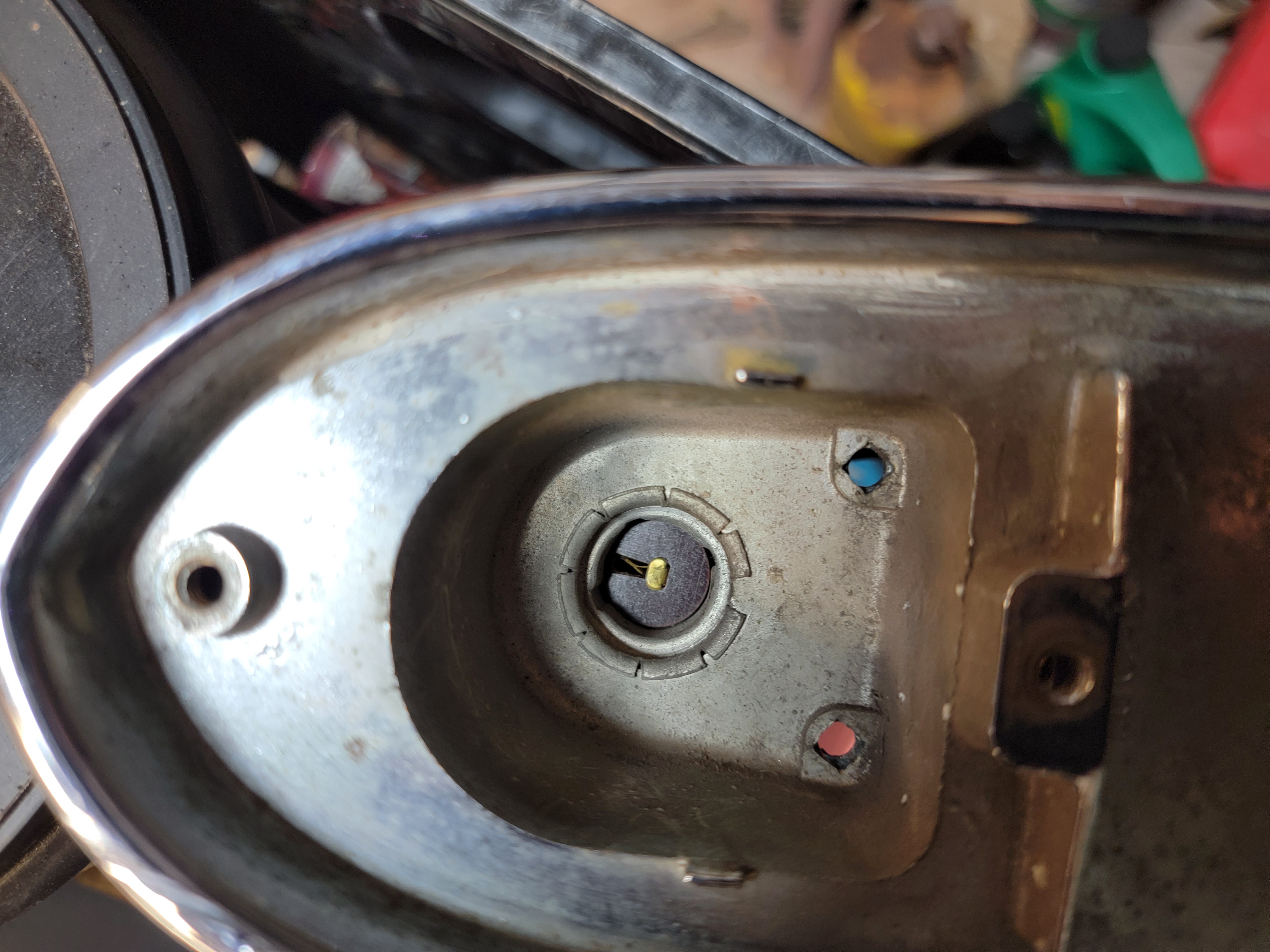

Firing up the electrical system after a restoration, one of my favorite things, and no right rear turn signal. What could be wrong? Surely not the brand new high dollar tail lamp. Picture of the original included to show the right way to make the socket.
Platinum
Can you not just "Chinese Puzzle" the contact 180°?
lram59
lram59
Member
I was going to swap the old guts in because of how poorly made the new one was. The contact would not stay in place. Ended up using the new piece with a dab of epoxy on the back side.
Larry
Platinum
A shame we have to re-engineer "new" parts.
