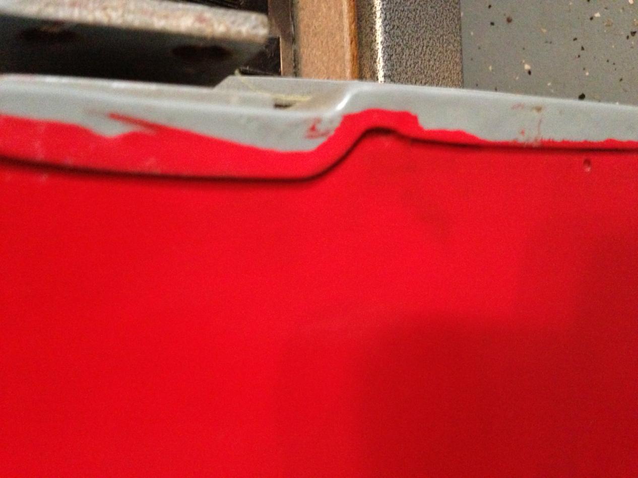

I have a picture of a test area that I used Brightside red. It is a beautiful color and will be using it to paint my MGA. I will get it for you this evening.

IMG_0182[1].jpgHere is a single coat of the Brightside paint I did more than 1 year ago having been in the barn for the last year. I could send you a swatch from the pint I got if you would like to get a really good look at the paint.

I could send you a swatch from the pint I got if you like to get a really good look at the paint.
