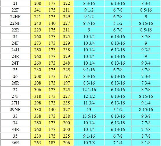

Check your phone book for Interstate batteries in your local area and ask them if the carry a 22NF. The 22NF is what your car calls for!

here a chart

here are my notes from when I bought my battery:
51r too big
22f hard to find
26 good
I would have to check my car, but I think I bought a 26.
