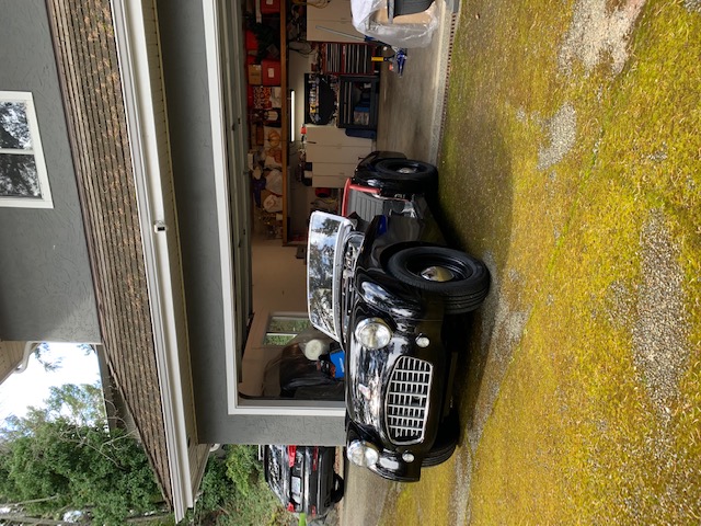

Hey guys,
Finally got my TR3 back on the ground after a complete suspension rebuild. EVERYTHING is new. I recall that I was to do the final tightening of some certain nuts (bolts) after the weight of the car was put back on the suspension. Can someone remind me what those were? I barely remember it being the nuts at each side of the upper control arm?
Thanks in advance!
Joel

Great looking car! I have a big "to do" note to accomplish that as well when I get mine back on the ground. What size tires are those?

Tires are 195/65/15. The TR6 wheels are 5 1/2 inches wide which makes it possible to fit that size tire.
