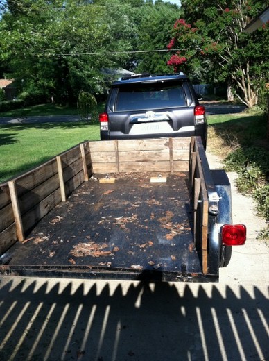

and we are off, wheel locks, check, safety chain lock, check, hitch lock, check, trailer lock, check

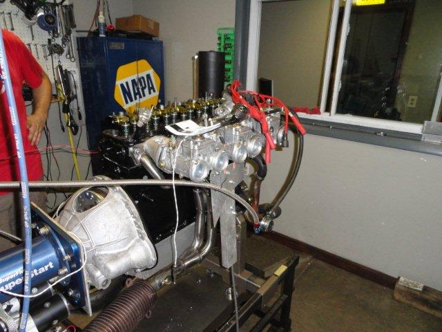

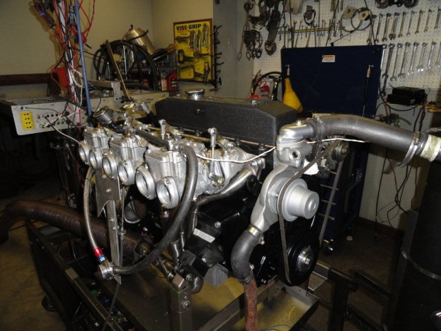

well dyno day is over engine is safely home and here are the results, after messing with the triple webers seems the calculations were off and they ran lean but after switching out some jets we got it running in the 11-12 range for breaking in the cam then we did several pulls 4000, 4500,5000,5500
the torque was 182 foot pounds and the HP was 182, we were going to pull at 6000 and 6500 but seems the crmoly push rods couldnt handle the revs and started getting valve float, as a note Kai didnt supply the push rods, the HP was still climbing at 5500 and Kai thinks we could have got close to 200HP, I am getting a set of Kai's CrMoly pushrods at .083 thick. He feel very confident I can push his engine to 6500 rpm,
Here is the builder of my engine and transmission and OD
Kai at Wishbone classics,in Carmillus NY I am very impressed with him and his knowledge of British engines! You want all you can get! call Kai
I am beat since I drove thru the night but I will get some pics and a link to the video
I cant wait to get this monster on the road
Hondo
