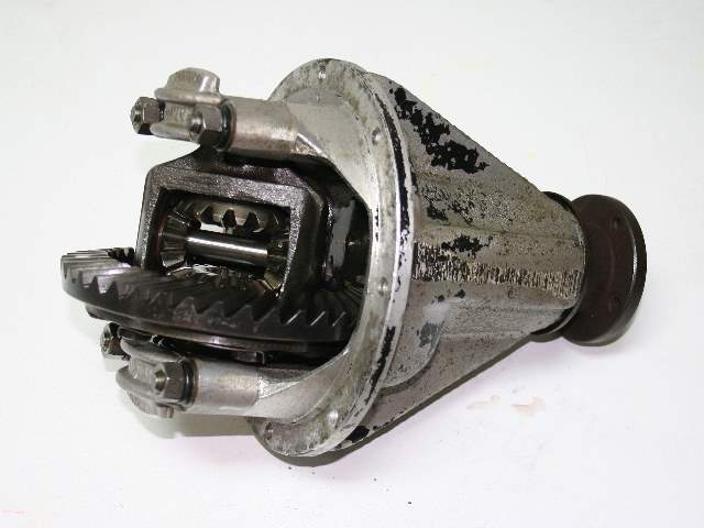

Just to clear things up, this is the unit I have, and in the second pic it shows 11/41 which is 3.7272:
Gray_Cat
Chris:
Very good looking unit - if you change your mind about the install you can put it on the Greyhound to me!
And, yes, the speedo will need to be recalibrated to account for the new gear set. That I can't advise you on though other than find and go to a local shop that does that work there.
