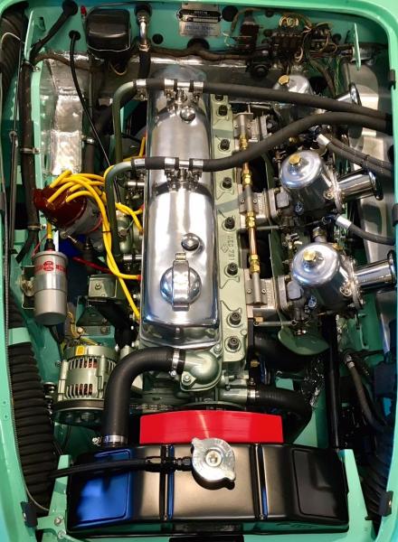

I'm happy to stay with my triple 2" SU HD8's at 265 hp and 245 torque of streetable performance.
