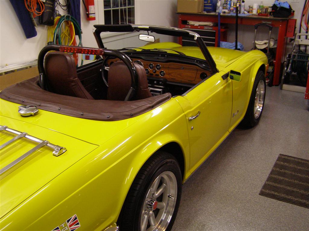

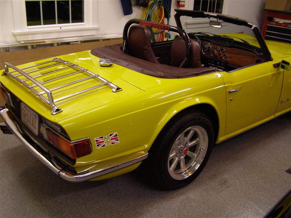

I had great weather yesterday and decided that I better take advantage of being able to use a water hose outside to strip or remove all of the wax on my TR6. I recently started using the Griot line of products and I think that they are great. I had several other waxes on the car from the past and decided that a winter project would be to remove them all and re-polish and wax the car for spring.
I used their Paint Prep as a remover and it worked extremely well in removing all of the old wax. I had a lot on the car, so I had to work to get through the layers, but now I have a true clean finish to start with. You have to work in sections, starting from the top and work it into the old wax, almost like you are waxing the car again, then flush off with a lot of clean water. You can see the surfaces where the water stops beading and just lays there, flat on the paint. Nitrile gloves are a must per their instructions, but I didn't notice any issues where I splashed bare arms.
I got it all done and hosed down while it was in the low 60's and it's now in the garage waiting for me to start the polishing and then waxing as soon as I have the time.

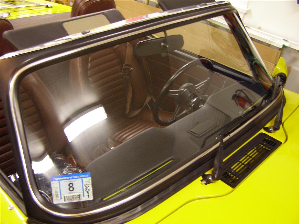

A side benefit of all of this was that I had a new windshield installed when the car was repainted back in 2008. It never seemed to want to be streak free or clean properly. I have tried everything, including Ditzler Body Wash to clean it and it just never seemed right. I washed it down with the Paint Prep as well, just in case anything was on it and after to [censored] of regular glass cleaner, it is now truly "clear as glass".

I finally finished the project with 3 coats of Carnuba, all buffed in one at at time, applied very thin and worked into the paint well with a random orbital buffer. These were stacked, one on top of the other, without removing the first or second coats and giving them 24 hours to dry in between each layer.
Thin is the trick, as the final coat came off very easily and will last a long time.
