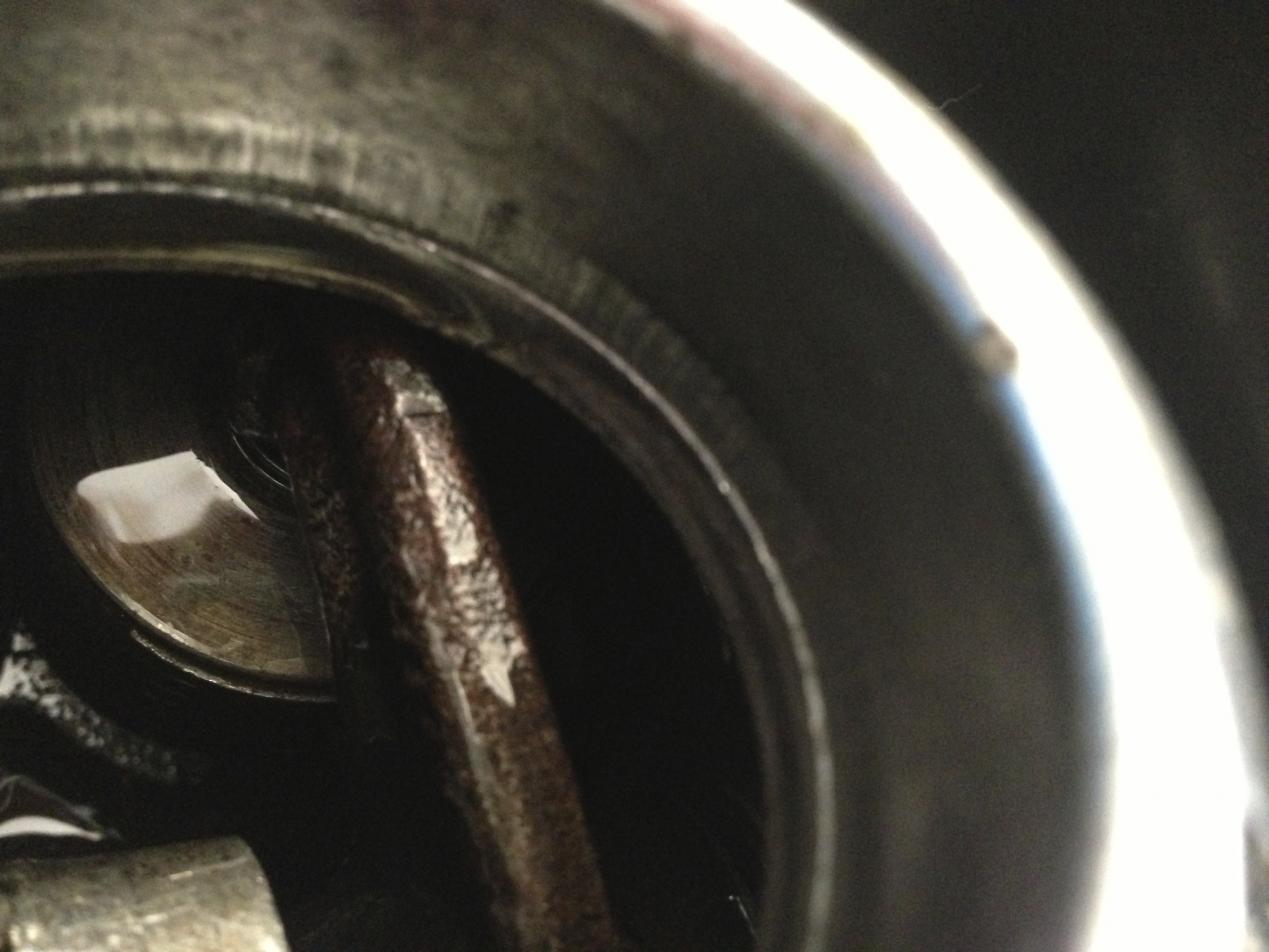

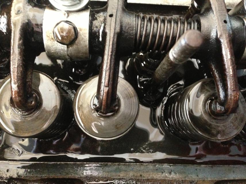

I was fillin' 'er up with oil when I noticed the rocker arm was really close to the valve cover. Then I noticed notches on the rocker arm from contact with said valve cover. Pictures!
So I took the cover off and most of the other rockers seem to have the same problem.
Of course, I have noticed noise, but there had been a lot of noise with this car until I got it to this point, so it's been relatively quiet! I didn't change the gasket after the valve adjustment, so I'm thinking I just need a new, thicker one. The old one hasn't leaked, but it has gotten pretty flat. What do you guys think, or recommend? Is it ok to drive until I get a new gasket or should I not even risk it?

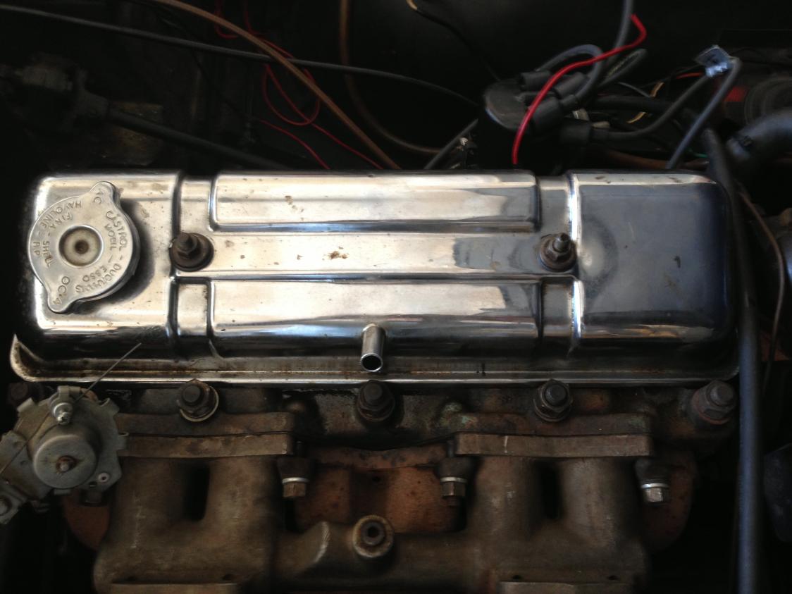

I would say you don't want your rocker arms banging into anything. I'm surprised that there would be so little clearance that a flattened gasket would allow the rocker arms to hit the cover. Are you sure you have the correct cover?

It's certainly possible. However it looks, to me anyway, like the right kind. But I'm only comparing to pictures I've seen online. Maybe you guys can tell me:

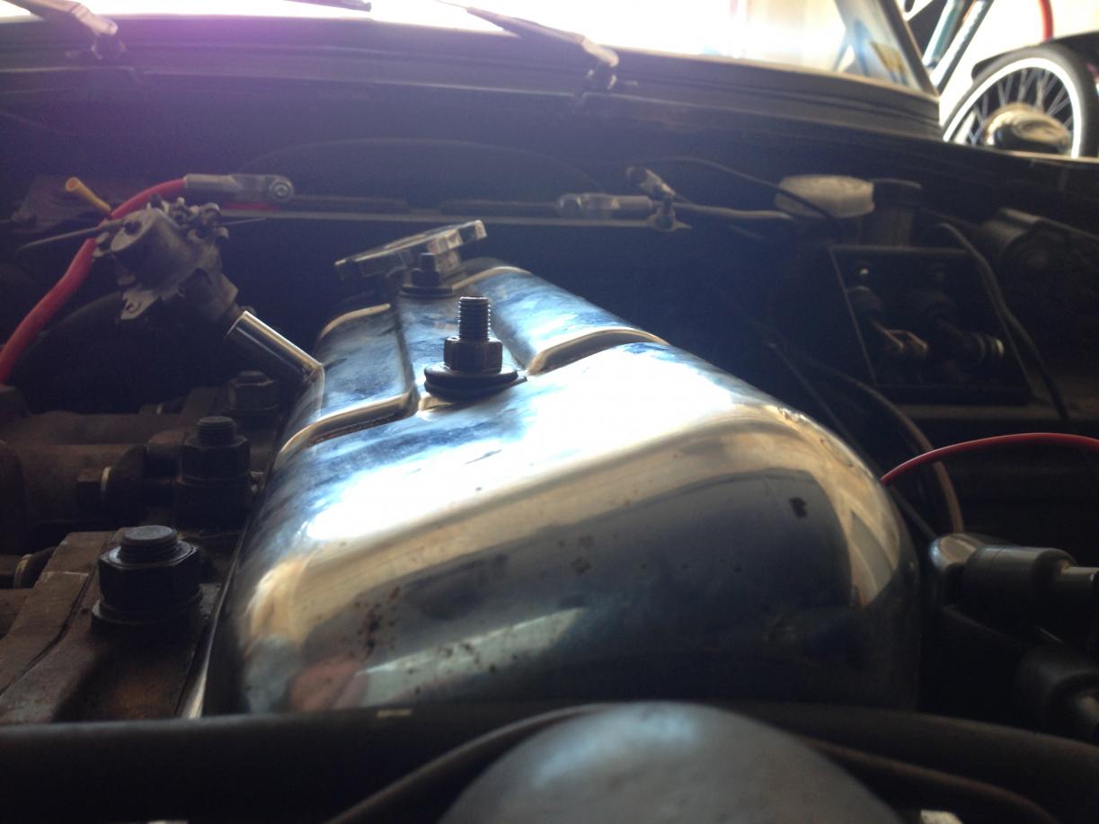

Randall, that's a good question. And where the filler cap is, there is definitely a notch underneath. I did look underneath the rest of the cover and didn't see anything suspicious anywhere else, though. Maybe I'll have to take a closer look after some cleaning and take more pictures. The valve cover is slight contoured in a way that it might produce edges. A different angle here:

I'm not seeing a problem from the pics. The notches on the rockers look like forging marks, and they are not shiny, which would indicate recent contact.
Just of note, if the cover nuts are too tight, it can bend the cover down. I had to bend mine back out when I restored it last year. Now I only put them a turn past contact (that's the purpose of the nylocks), to hold them with little torque).

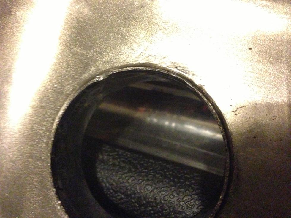

OK going back and looking at the underside of the cover I think I'm only partially correct in my worrying. Everything looks fine except for the flange where the filler cap goes. It's notched from contact (look at upper left portion):
And just going off of what you said, John, all the other rockers' notches look dark, but that one #8 rocker is shiny--you can kinda tell from that second photo (the rocker to the far left), but there's a little bit of a glare. I think I'll just file that lip down a bit and order a new gasket just for the heck of it.

Cover looks right to me. Seems unlikely to me that the rockers are hitting the cover, but could be possible I guess. The marks in the underside of the cover should be really obvious, though. If you find them, I'd try gluing a second gasket to the first one, to put the cover higher.

Does the rocker or the top of that valve look higher than the others ? Maybe some PO installed a valve with a longer valve stem ?

The PO did have the engine rebuilt so both of those suggestions are possible. But all the valves appear to be of similar height. If only the rearmost valve is hitting, then it's because of that small lip under the cap. In any case, there isn't much clearance for any of them.
