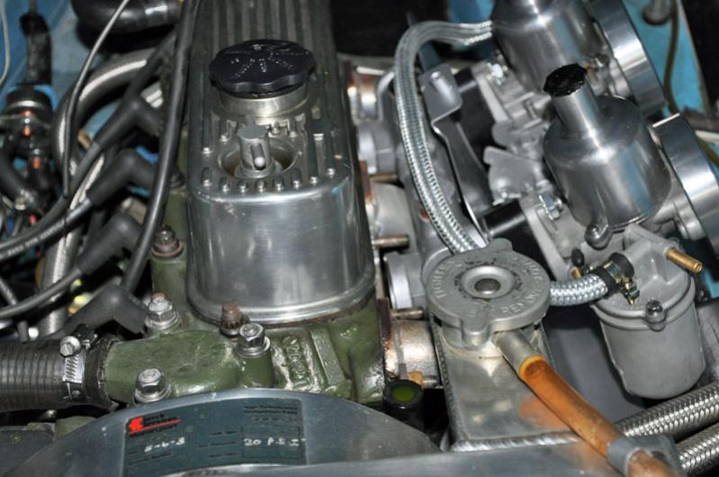

X2 on comments above re gasket prep. I like cork. I use a stock plastic vented cap. I like the look of the "T" nuts.
You might need to notch it if your head has too many studs. This one had to be notched in the front a bit for a Longman GT head.
I also vent from the old fuel pump site and the front cover. No PCV or gulp valve. Minor drip after a run. No biggie.
Excuse the nasty dirty condition. This was during an intake change-over.
