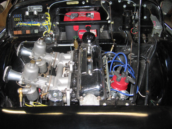

I've been in the rebuilding industry for almost 40 years, and we never used those chemicals to clean aluminum. First the parts are degreased using either hot water/soap solutions, or mineral spirits. In both cases machines did the work, but mineral spirits will work fine with a bucket and brush. After that, we would either shot blast or glass bead to rid the part of any discoloration and bring back the aluminum to it's more natural color.
At home, after cleaning with mineral spirits, I've used steel wood pads with the soap in them, scrubbed and washed off the part thoroughly and have gotten all the aluminum parts to look clean and natural.
Those caustic chemicals are unnecessary and dangerous.
See the pic below. I did the SUs, intake manifold and thermostat housing using the mineral spirits and steel wool pads. It may be a bit more more on work dirtier and more complicated pieces, but it will get the job done. Another way after degreasing would be to get a glass bead cabinet, which would also work great getting the rust off of steel parts.
