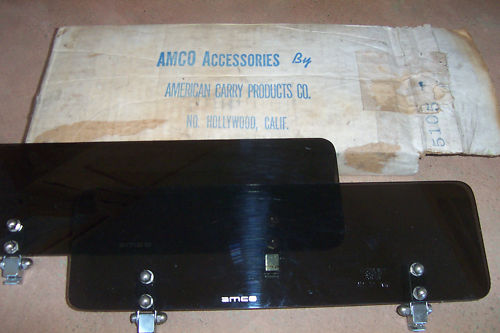

And Art, you're thread reminded me...what does the tenon plate do? I notice that mine has little set screw markings where something has been attached previously. The same little markings are all along the rear edge of the windscreen frame on the top.
John
Geo Hahn
The set screw marks on the tenon plate are almost certainly from wind wings.
The marks on the top edge may be some sort of clamp-on sun visors.

TR3driver
Great Pumpkin - R.I.P
:iagree:
