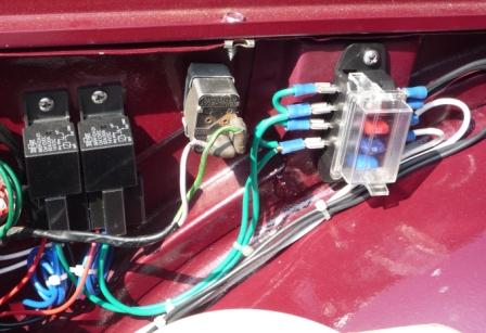

On my 6 I used two relays and four fuses.

Nice looking installation Elliot!
Tinkerman
Gliderman8
:thankyousign:
Thanks for the compliments Dick!
