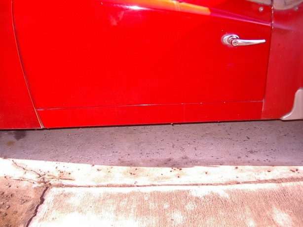

Hello All, I have my 59 TR3 in the body shop and I am not sure if there should be any space between the rear of the front fenders and the front of the door down at the bottom where the rocker panels are. I hope I have explained my question right. A close up picture would be great. I have looked at a lot of TR's but haven't been able to find one that shows what I need.

Aloha Greg,
He is a photo of my car. As you can see there is a slight gap betweem the rear edge of the front fender and the outer sill.

Thanks for your input and Dave the picture shows what I need.

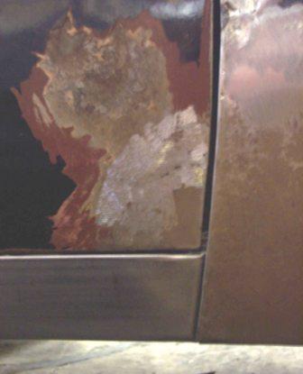

Don Elliott
Here is a close-up of the RHS door on a late TR3A that I finished in 2006. The complete bottom 10" on the front fender plus the pieces that secure it to the inner sill at the bottom are new sheetmetal that I MIG welded to replace the rot. The outer sill you see is a new repro and the door was rusted right through about 3" back and 3" up. So I was able to match the gaps as shown by welding in new metal.
