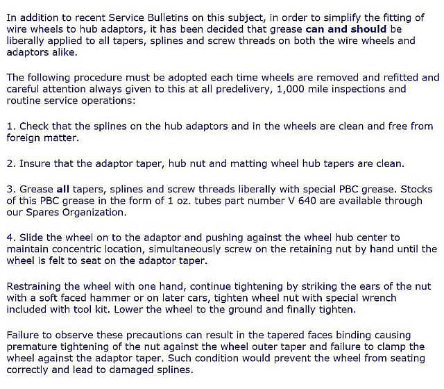

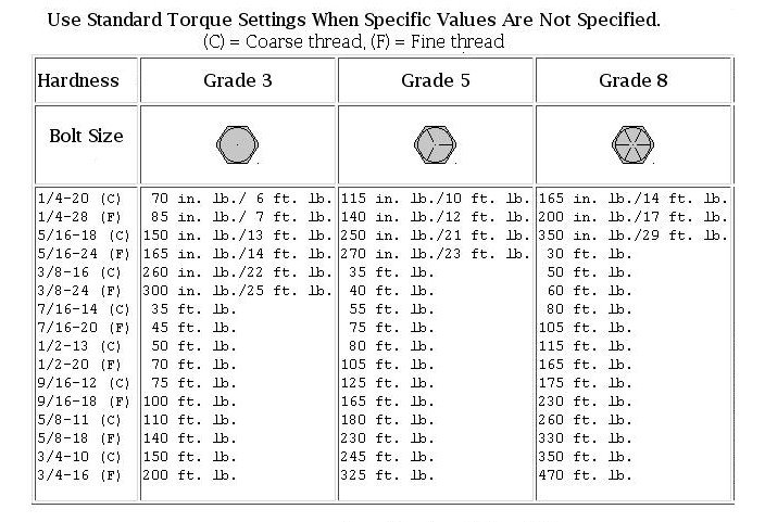

Here is a chart that would cover something the size of a wheel spline: Torque list by size
Yeah, but that is bolted joint information. Wire wheels, with all those tapers and whatnot, are a somewhat different kettle of fish.

True enough but no other data more specific than "tight" that I can find. Tom
Lets see if this comes through big enough to be legible:

DrEntropy
Sweet, Randall! :thumbsup:
That torque table (or one like it) has always been in the toolbox, along with drill charts and conversion tables.
