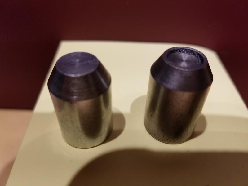

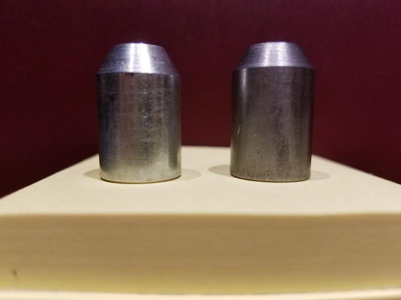

During that ride, once the engine came up to operating temp of 180 the oil pressure needle began acting erratically during deceleration and at idle. Whereas In the past the oil pressure would fall off gradually by about 10-15 psi from maximum during deceleration, the needle was dropping very quickly whenever I took my foot off the throttle, and was falling to 20 psi--and sometimes less--at idle. Clearly something was wrong!
This morning I drained the oil that I put in yesterday and inspected it for any debris--NONE. I removed the spin-on filter and cut it apart to inspect the filter medium--it too was clear of any debris. I began to suspect that the new oil pressure release valve was not closing all of the way, allowing oil to bypass it and giving lower readings, so I decided to remove and inspect it as well as the passage in which it operates (though I had done this yesterday prior to installing the new valve).
When I disassembled the engine last week I used a 1/2"-13 tap and with finger pressure engaged the inside diameter of the oil release valve and extracted it from the passage. This morning, however, that same tap did not seem to be working on the new valve. I finally got the valve out using a tap with a slightly different taper and when I compared the new valve to the old I saw that there were some slight differences: while the outside diameter of the two valves measured the samec the new valve was made of much thinner material--.0047" versus .0057", which explained why the ID's were different and I could not extract the new valve with the same tap as worked on the old one. See the attached photo--new valve on left.
I reassembled the relief valve using the old part, spun on a new filter and refilled the engine with the same oil. On cold startup the oil pressure was about 5 psi higher than yesterday, varying between 40 to 60 psi from idle to 2500 rpm's +. I drove the car for an hour and at OT of 180 the oil pressure held at 55-60 psi at constant throttle and 35 psi at idle. This conforms to past performance and all seems right!
I can only conclude that the thinner wall construction of the new valve allowed it to expand more when heated--just enough to allow it to jam in its passageway, not seat fully, resulting in lower OP. The Lesson Learned is not to assume anything, especially that new parts are the same as old ones!

The depth of both valves--the old and the new--is the same at 3/4". The spring supplied with the new valve was perhaps 1/8" longer than the one that was in the car and that might be attributed to its having become slightly compressed with age (15 or so years at least, maybe more).
Beyond the wall thicknesses there are some other differences between the valve that was in (and is now back in) the engine and the one supplied by Moss. Though both are of the same length overall the straight shoulder on the new valve is slightly longer with a bit steeper angle on the tapered section. Also, the nose of the new valve is flat whereas the old one is dimpled. See the two attachments--in both shots the new valve is on the left.
BTW the real old valve is back in the car and the "old" one pictured is out of the MGA engine in my Courier--but it is identical to the one I pulled out of and have since reinstalled in the 100's engine. I'd guess the was some commonality within BMC, even between the series B and C engines
Someone over on the Autox list responded to my post there saying that there would be more growth with a thicker-walled valve--perhaps he is right and these other variations made the difference. In any case the valve that was in the car is back in the car and it is performing just fine.

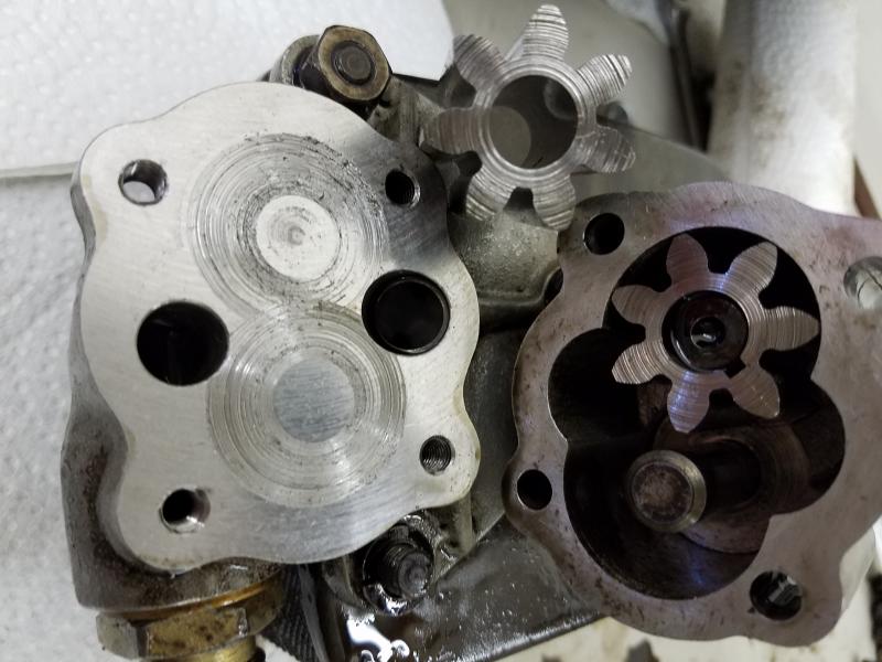

No, the low oil pressure was due to a very worn oil pump--see attached pic. I got the new one along with a drive spindle out of Denis Welch. I guess there was a bit of "mission creep" and I decided as long as the pan was off I would replace related stuff such as the pressure relief valve which, as it turns out was fine and also do the thrust washers and rod and center main bearings.
