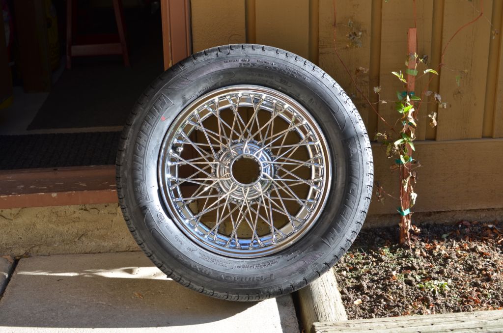

croz
I'm running on Dayton 15x4.5 60 spoke wire wheels with 195/65 Michelin Primacy MXV4 tires.
Excellent ride. No inner tube. Better stance for a great look (better on the car).
